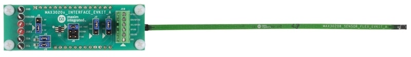

  • MAX30208 sensor flex PCB: A flexible printed circuit board carrying the MAX30208 sensor in a 10-pin LGA package.
  • MAX3020x interface board: Provides accessible test points, configuration jumpers, and connections between the sensor and the microcontroller board.

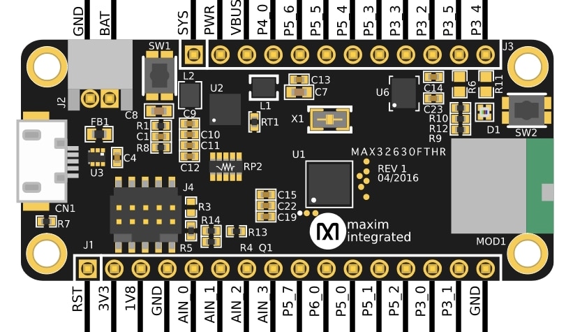

  • MAX32630FTHR microcontroller board: Runs the firmware required to communicate with the PC GUI and supplies power to the interface board.
The system connects to a Windows PC through the micro-USB connector on the MAX32630FTHR board. The supplied firmware enables the evaluation software to configure the sensor, acquire temperature measurements, and access device registers.
The flexible sensor PCB has a low thermal mass, which supports a fast thermal response and allows the sensor to be positioned away from the main interface electronics. However, the measured temperature still depends on thermal contact, mounting, environmental conditions, and the measurement procedure. The flex PCB does not, by itself, guarantee accurate skin-temperature or clinical body-temperature measurements.

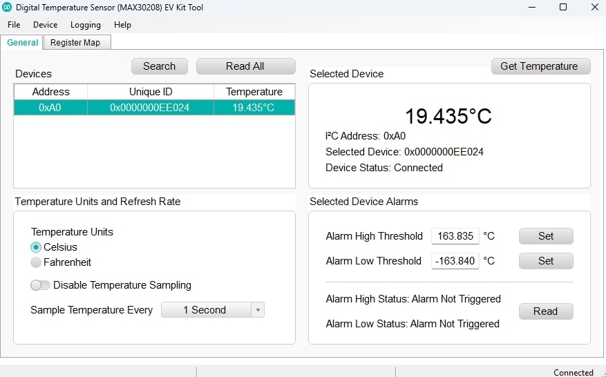

Analog Devices provides a Windows application for evaluating the MAX30208 without requiring the user to develop custom firmware for the initial tests.
According to the evaluation-system documentation, the GUI provides the following functions:
1. Temperature Monitoring
The application displays temperature readings from the connected sensor and provides controls for relevant device settings. The documentation does not describe a built-in real-time temperature-trend graph or a dashboard of minimum, maximum, and average statistics.
2. Data Logging
The GUI supports exporting measurement samples to a comma-separated values (CSV) file. This allows recorded data to be analyzed using tools such as Microsoft Excel, MATLAB, or Python.
The evaluation system also supports logging to a microSD card when configured for standalone operation with a compatible card and battery.

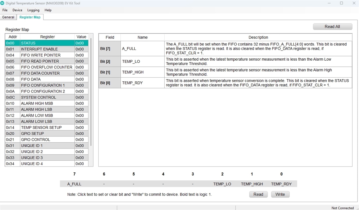

3. Register Map
The Register Map tab allows users to read individual MAX30208 registers, read all registers, and modify register bit settings. This is useful for exploring sensor configuration, measurement control, status flags, and other device functions.
4. Temperature Alarms and Interrupt Configuration
The MAX30208 supports programmable high- and low-temperature thresholds. When the relevant status and interrupt settings are enabled, the GPIO0 pin can signal a selected alarm condition. These functions can be configured through the device registers; the exact controls available in the GUI should be confirmed against the installed software version.
