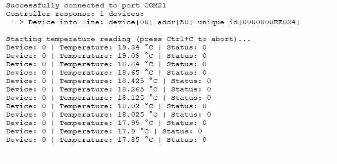

MAX30208EVSYS Python Reader Script
Description: This script implements a direct communication protocol with the MAX30208EVSYS evaluation kit, bypassing the official Windows GUI. It establishes a serial connection through the USB-to-UART bridge (MAX32630FTHR) and communicates using text-based commands terminated with a carriage return ('\r'). Key Features: - Initializes the serial port according to firmware requirements (115200 baud, 8 data bits, no parity, 1 stop bit, DTR/RTS enabled). - Sends control commands like 's' (search devices) and 't0' (read temperature) - Uses regular expressions to parse bracket-notated data frames received from the microcontroller (e.g., [0] [24.570] [0])

  def find_devices(self):
    """Searching for devices on the I2C bus ('s' command) and clearing buffer lines[cite: 3]."""
    self._send_command("s")
    header_response = self._read_response()
    print(f"Controller response: {header_response}")
    # Read additional lines returned by the controller for each found device
    match = re.search(r"(\d+)", header_response)
    if match:
      num_devices = int(match.group(1))
      for _ in range(num_devices):
        dev_line = self._read_response()
        print(f"  -> Device info line: {dev_line}")
  def get_temperature(self, device_index=0):
    """Reading temperature for the indicated device index ('t' command)[cite: 3]."""
    self._send_command(f"t{device_index}")
    # Parsing the protocol response based on square brackets[cite: 3]
    # Example response format: [0] [24.570] [0]
    match_collection = re.findall(r"\[(.*?)\]", response)
    if len(match_collection) == 3:
      dev_idx = int(match_collection[0], 16)
      temperature = float(match_collection[1])
      status = int(match_collection[2])
      return {"device_index": dev_idx, "temperature_c": temperature, "status": status}

The result of this script's execution is as follows:
