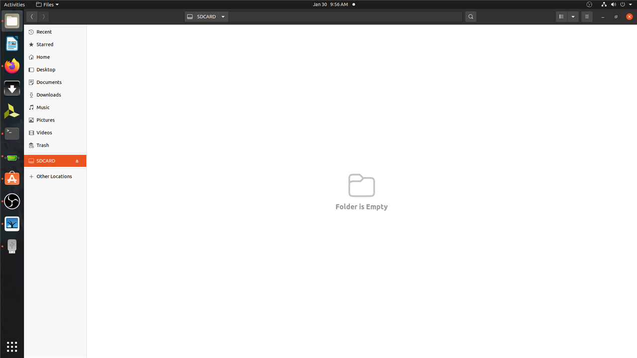

Now that the SD card is initialized, let us now start writing data to it. As I stated earlier, I added a UART on this test for easy verification. Open your Serial Monitor(I used GTKTerm), connect the port to whatever port the CMOD FPGA is currently connected, and set baud rate to 9600. Set the display to hexadecimal. Now, if you reset the board using btn0 and press the btn1 again to start initialization, the following will appear.
Those are the commands we sent to the SD card for the initialization sequence and also the response we got from it. If you are curious on how the flow works, just check my earlier blog. Now, if you press the button multiple times again, you will see the following:
Those are the data we are sending to the SD card. The first 512 bytes is the ASCII code for letter "a", second 512 bytes is the ASCII code for "b", and so on. Very simple! Now, in order to verify that the data is really stored, simply connect the SD card to your computer (using an SD card reader). And ta-dah! You will see this:
Now, why is it empty? It is because our test simply writes to a specific address of the SD card(address 2050 if you try to read the code), this is very similar to writing data to a flash memory. This means that we are not implementing any file system and since our computer always uses a file system to view an internal or external memory, it won't be able to show to us what is really stored in the SD card. The solution is simple: access the sector address of the SD card.
Open your terminal and type this command: sudo dd bs=512 count=10 skip=2050 if=/dev/sdd of=sdcard.bin
I'm in a Linux environment but if you are on Windows, there is also the dd command. This dd command simply convert and copy files. For this context, we will copy bytes of data from a specific sector of our SD card to our computer. bs is the block size and count
is the number of block sizes that we will copy. skip is the number of counts skipped. It is set to 2050 since that is also the starting address specified on the code (2050 seems to be always a safe sector according to my experiments). In my example, I set the count to 10 so you will be able to see 5120 bytes of data after the 2050th 512 blocks. if is the input file which is the directory where data will be coming from (directory of the SD card) and of is the output file where the files will be copied to (sdcard.bin).
Since binary files are not accessible and is hard to read, convert the binary numbers to its hex value first and save it to a text file. This can be done using the hexdump command: hexdump -C -v sdcard.bin > sdcard.txt
I pressed the btn1 5 times and this is my sdcard.txt:

Notice the first 512 bytes(up to line 32) is filled with a's. Then the next 512 bytes(up to line 64) is then filled with b's. This will go on up to letter "e" since I pressed the btn1 5 times. This verifies that the write operation succeeded.
