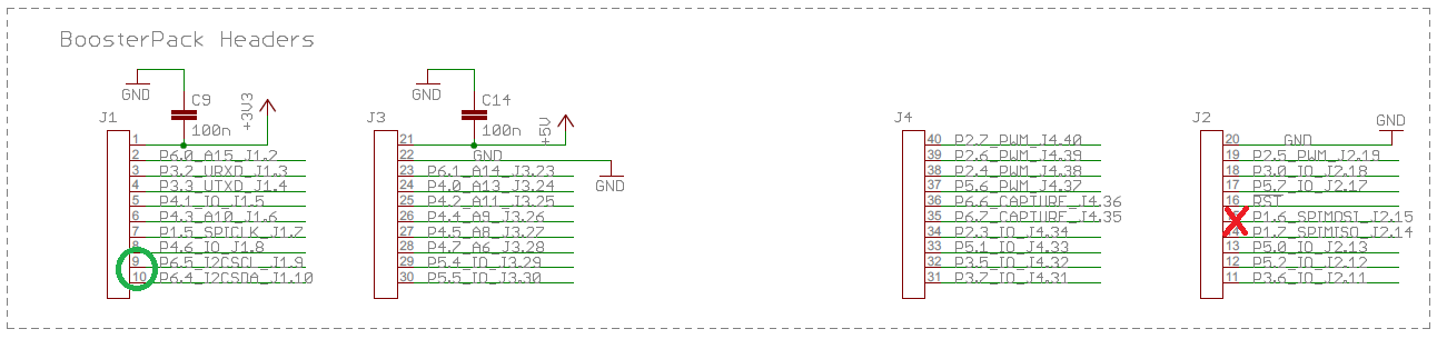

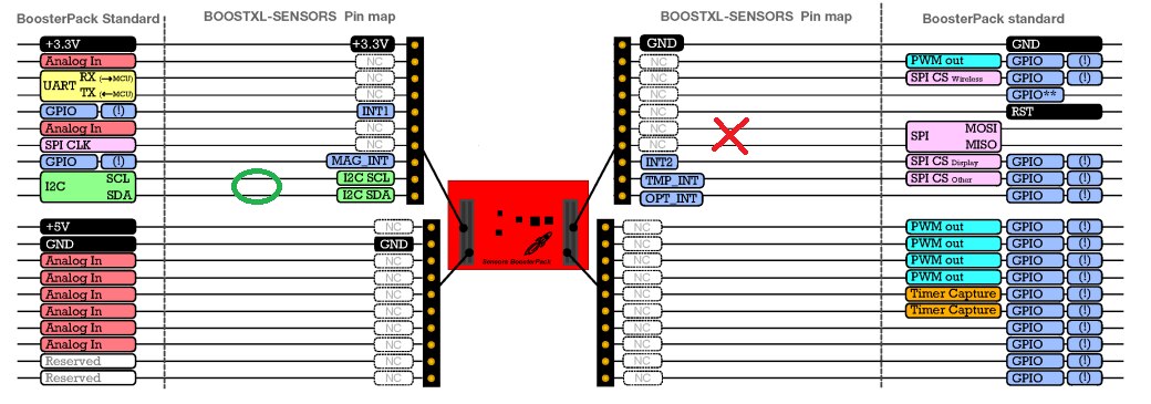

By default, the TI-RTOS examples route the I2C traffic to P1.6 and P1.7. But some BoosterPacks, such as our Sensors kit, expect it on P6.4 and P6.5.
Here are the changes you need to make to your MSP_EXP432P401R.c file to route them correctly for those boards.

This results in the following setup:
  • J1.9, pin P6.5 is SCL
  • J1.10, pin 6.4, is SDA

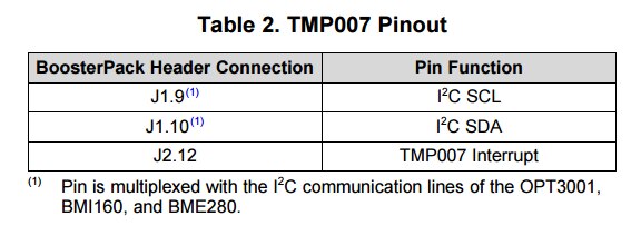

That's what's needed according to the BoosterPack's doco:

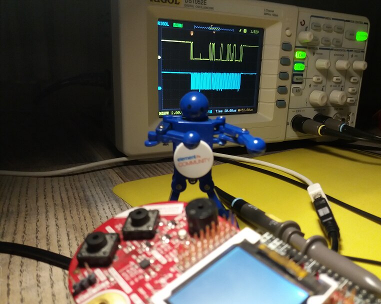

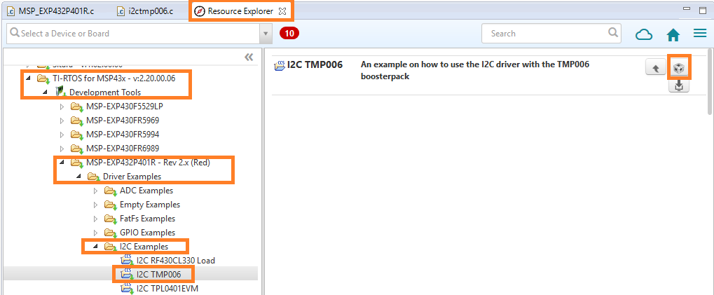

I've tested this with an educational BoosterPack (I don't own a BOOSTXL-SENSORS). The example that I start from is the I2C TMP006 example in the Drivers folder of Resource Explorer.
The  BOOSTXL-SENSOR has a newer version of the temperature sensor (TMP007).
[CORTEX_M4_0] Starting the I2C example
System provider is set to SysMin. Halt the target to view any SysMin contents in ROV.
I2C Initialized!
Sample 0: 20 (C)
Sample 1: 20 (C)
Sample 2: 20 (C)
Sample 3: 20 (C)
Sample 4: 20 (C)
Sample 5: 20 (C)
Sample 6: 20 (C)
Sample 7: 20 (C)
Sample 8: 20 (C)
Sample 9: 20 (C)
Sample 10: 20 (C)
Sample 11: 20 (C)
Sample 12: 20 (C)
Sample 13: 20 (C)
Sample 14: 20 (C)
Sample 15: 20 (C)
Sample 16: 20 (C)
Sample 17: 20 (C)
Sample 18: 20 (C)
Sample 19: 20 (C)
I2C closed!
