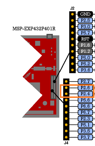

For this example I've taken another path: switch the existing PWM0 and PWM1 signal away from the RGB LED and route them to BoosterPack connector J4.
I'm choosing the second and third pin on P4, P2.6 and P2.4. You are free to choose other GPIO pins.

All the work is done in the source file MSP_EXP432P401R.c.
We have to make two changes. The first one is to make P2.6 and P2.4 PWM pins, instead of the LED-connected pins P2.1 and P2.2
const PWMTimerMSP432_HWAttrsV1 pwmTimerMSP432HWAttrs[MSP_EXP432P401R_PWMCOUNT] = {
        .timerBaseAddr = TIMER_A1_BASE,
        .clockSource = TIMER_A_CLOCKSOURCE_SMCLK,
        .compareRegister = TIMER_A_CAPTURECOMPARE_REGISTER_1,
        .gpioPort = GPIO_PORT_P2,
        .gpioPinIndex = GPIO_PIN6,
        .pwmMode = GPIO_PRIMARY_MODULE_FUNCTION
        .compareRegister = TIMER_A_CAPTURECOMPARE_REGISTER_2,
        .gpioPinIndex = GPIO_PIN4,
Then change the PWM port map for GPIO port 2. Connect timer signal TA1CCR1A to 2.6, 2A to P2.4.
You do that by setting in the map to what bit (= pin) of the port each of those signals goes.
 *  ======== MSP_EXP432P401R_initPWM ========
void MSP_EXP432P401R_initPWM(void)
    /* Use Port Map on Port2 get Timer outputs on pins 2.4, 2.6) */
    /* this is different then the standard mapping for the Launchpad
     * that puts Timer outputs on pins with LEDs (2.1, 2.2)
     * Board_PWM0 mapped to 2.6
     * Board_PWM1 mapped to 2.4
    const uint8_t portMap [] = {
        PM_NONE, PM_NONE, PM_NONE, PM_NONE,
        PM_TA1CCR2A, PM_NONE, PM_TA1CCR1A, PM_NONE
    /* Mapping capture compare registers to Port 2 */
    MAP_PMAP_configurePorts((const uint8_t *) portMap, PMAP_P2MAP, 1,
        PMAP_DISABLE_RECONFIGURATION);
    PWM_init();
If you now Build and Run the program, the LED will no longer blink. You'll find your 2 PWM signals back on BoosterPack connector J2, P2.6 and P2.4.
You can check this with a logic analyzer or a scope, as in the picture below:
You can now use these signals to drive your project.
