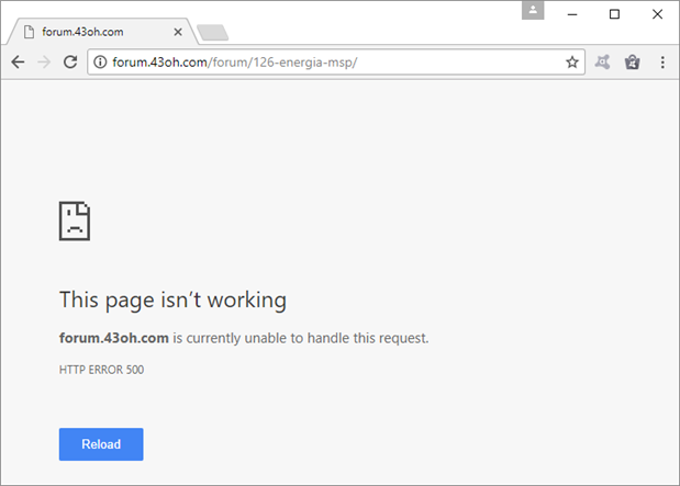

No links, so I have been checking the forum myself but keep getting:
Sigh...
