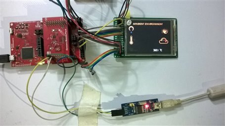

In this blog post, I'll focus on
     - the interfacing of the TMP007 and the MSP432P401r MCU
     - display the temperature on TFT
     - send data to PC UART for graphical representation
Components:
  • Sensors Boosterpack
  • MSP432 Launchpad
  • TFT Proto
  • mikroplot [UART PC GUI]
Compiler:
MikroC pro for ARM - from MikroElektronika
Firmware:
Full source code and circuit diagram can be found in LIBSTOCK.

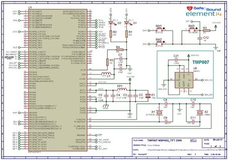

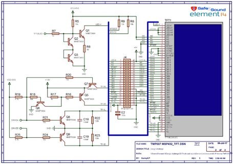

Circuit Diagram:
     MSP432P401r with TMP007                                                            TFT display connection

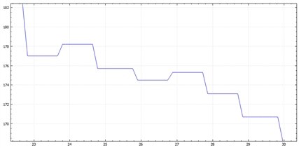

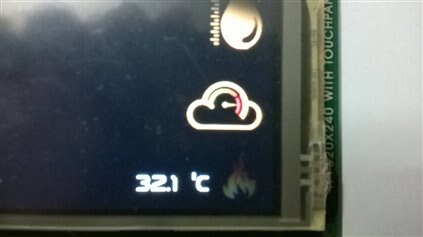

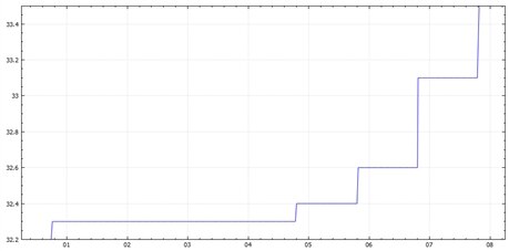

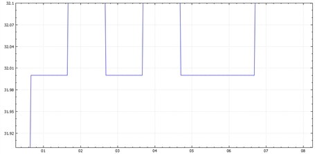

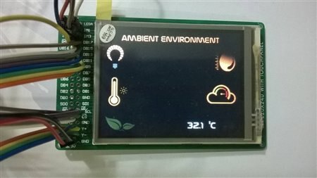

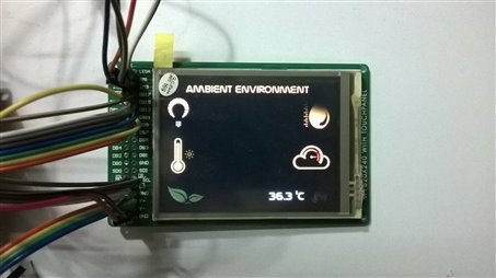

The sensor gives ~32'C at room temperature. When I put my finger about 3cm above the sensor it detects a temperature ~36.3'C.
At room temperature, when no object is placed above the sensor, the reading varies from 31.9'C to 32.4'C. On the other hand when I placed my finger 3cm above the sensor it took more than 3 seconds to rise upto the max temperature [36.3'C].

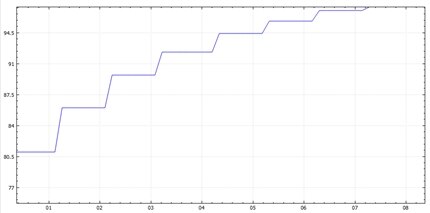

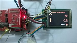

To check the response of the sensor on a hot object, I placed the Soldering Iron 3cm above. The max operational limit specified in the datasheet is 125'C. But it rises upto 209'C in this case.
It's also written in the product page that
"It is possible to measure object temperature beyond the device operating range as long as the device itself does not exceed the operating temperature range (–40°C to +125°C)."
However, it takes time and gradually reaches the highest reading. Stays there for a few seconds and then decreases as the Iron gets cool.
** I have added a visual notification on detecting hot object. If the temperature reading is below a threshold point the "FIRE" icon is dimmed. When the temperature rises above the threshold, the "FIRE" icon becomes bright.
