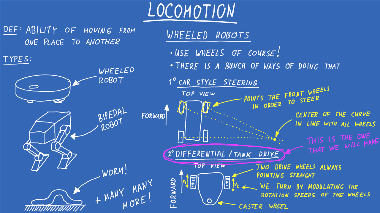

Locomotion: How Do Mobile Robots Move?
Miloš begins by introducing locomotion, the ability of a robot to move from one place to another.
“Locomotion is the ability of moving from one place to another. So in robotics it’s how does the robot move?”
Robots can move in many different ways. Wheeled robots, walking robots, tracked vehicles and bio-inspired machines all fall under the broad category of locomotion. Since the objective of this project is to introduce the fundamentals of mobile robotics without adding unnecessary complexity, Miloš focuses on wheeled robots.

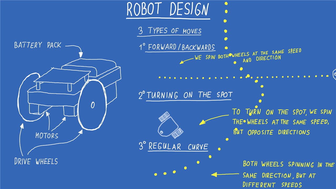

Even then, there are multiple approaches. A car changes direction by altering the angle of its steering wheels. Some robots use tracks while others employ more specialised wheel arrangements such as mecanum wheels. For this platform, the chosen solution is differential drive.
“In this case the wheels are fixed, we can just play with their speed and direction.”
A differential-drive robot uses two powered drive wheels and a third passive support wheel, normally a caster. Steering is achieved entirely through the relative speed of the left and right wheels.
If both wheels rotate at the same speed, the robot travels in a straight line. If one wheel turns faster than the other, the robot follows a curve. If the wheels rotate in opposite directions, the robot can rotate on the spot.
The design keeps moving parts to a minimum while still demonstrating many important mobile robotics concepts.
“The vacuum robot is the prime example of a differential drive robot.”

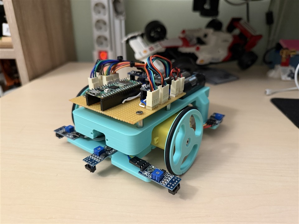

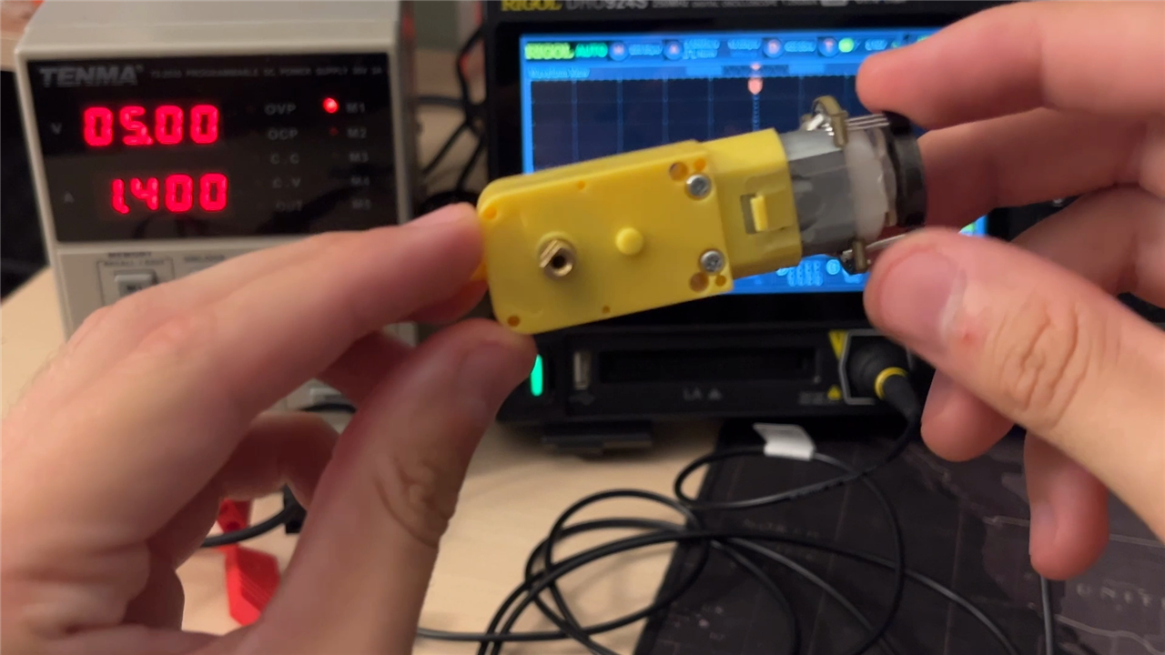

The drive system is built around two DFROBOT geared DC motors with integrated encoders. The gearbox reduces the motor speed to something useful for driving a robot, while the encoder provides rotational feedback.
These encoders are important because they allow the robot to measure wheel speed and estimate wheel position. Without them, the firmware could only command a motor and hope it behaved as expected. With encoder feedback, movement can be measured, controlled and visualised.
“This here is an encoder.”
For anyone unfamiliar with encoders and feedback systems, the element14 Learning Center article Magnetic Encoders provides useful background on how rotational position and velocity can be measured electronically.
The motors are controlled through a DFROBOT dual motor driver. The microcontroller generates a direction signal and a PWM signal for each motor, while the motor driver handles the current required by the motors themselves.

Cliff Detection Instead of Obstacle Detection
Many consumer robots rely on bump sensors, cameras or LiDAR to detect obstacles. Rather than attempting to build a complete navigation system, Miloš deliberately simplifies the sensing challenge.
The robot uses five downward-facing infrared sensors as cliff detectors.
“Instead of detecting walls we will detect cliffs.”
This changes the problem from obstacle avoidance to edge detection. Rather than navigating around furniture, the robot explores a raised surface and attempts to identify where the surface ends.
The approach is particularly useful for demonstrating how sensor information can directly drive robotic behaviour without requiring complex perception systems.

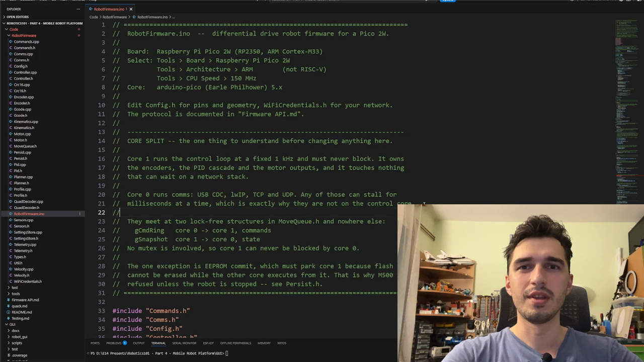

Firmware, Communications and Software Architecture
The software is split into two major pieces. The first is embedded firmware running on the Pico. The second is a desktop GUI used for control, monitoring and tuning.
Readers who followed the SCARA robot arm build will recognise a very similar development workflow. Once again, Miloš combines embedded software and a graphical control environment into a single ecosystem.
The firmware is deliberately modular.
// Everything the host can ask for goes through here,
// so Serial and WiFi are guaranteed to behave identically.
This ensures that commands behave the same whether they are sent through USB Serial or over Wi-Fi.
The firmware also uses movement concepts familiar to anyone who has worked with CNC machines or 3D printers.
// Modal state (G90/G91, the last F,
// the programmed wheel target) lives here
// rather than in the controller.
The resulting system is flexible enough for interactive testing while remaining structured enough for more advanced automation later on.

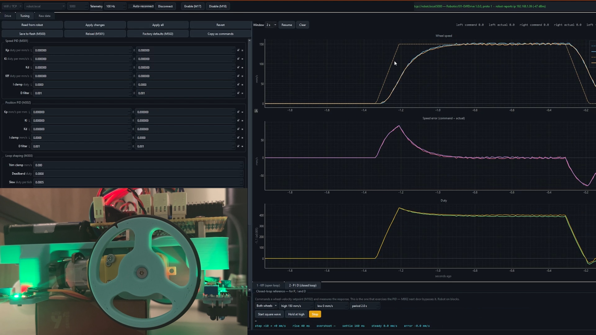

Each wheel uses encoder feedback to regulate speed through a closed-loop controller.
// SPEED loop (inner): error in mm/s -> output in duty
#define SPD_KP 0.0015f
#define SPD_KI 0.0080f
The GUI exposes tuning controls, making it possible to observe how the robot responds as controller values change.
Miloš demonstrates the practical tuning process by examining how quickly the wheel reaches its target speed. A response that is too slow typically indicates insufficient proportional gain. Increasing Kp improves responsiveness, but pushing it too far can create oscillation and instability.
Those behaviours become immediately visible when real motors, gearboxes, batteries and sensors enter the equation. The project therefore serves as a practical continuation of the PID concepts introduced earlier in the series, showing what they look like when attached to a physical robot rather than a simplified example. One of the biggest conceptual differences between this project and the earlier SCARA robot arm is localisation. A robot arm operates from a known position. Its joints move relative to a fixed base and its location in the world remains constant.

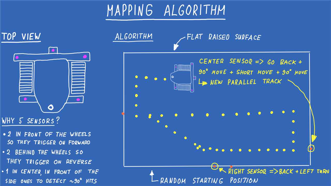

The chosen exercise was mapping the edge of a raised surface.
The mapping algorithm intentionally remains simple. Whenever a cliff sensor detects an edge, the robot reverses and changes direction. If the centre sensor detects a head-on edge, the robot performs a more substantial manoeuvre before continuing.
“As we detect a certain edge we’re gonna go back, turn around, something similar that your robot vacuum is doing.”
This behaviour is significant because it combines every major subsystem.

As the robot continues exploring, the triggered cliff detections begin forming a representation of the table edge.
“It’s forming a rather nice point cloud around the edges of the table.”
The robot is not creating a complete map in the modern SLAM sense, but it does demonstrate how movement and sensing can be combined to generate useful environmental information.
