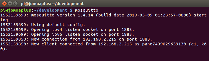

  To orchestrate the MQTT message pass between node via topics, the Eclipse Mosquitto MQTT Broker was installed on the Raspberry Pi 3 A+ that is also hosting the MATRIX Creator.  The Eclipse MQTT Broker is an open source implementation of 3.1 and 3.1.1 versions of the MQTT protocol.  This has been been used in previous projects so there is a bit of familiarity with the tool making it easier to implement in this project.  The MQTT Broker will run on the Raspberry Pi and the openHAB 2 MQTT Bindings will be used to control the messages between nodes.
The first step is to install Mosquitto on the Raspberry Pi.  This can be performed with manually or using the 'apt-get' tool, however there seems to be an issue getting Mosquitto installed on the STRECH version of Raspbian, so the manual option was used.
    Ref: STRECH and MQTT -  https://www.raspberrypi.org/forums/viewtopic.php?t=191027
    1. Download  and install the Mosquitto bit to a local folder on the RasPi.
     Install Dependencies
sudo apt-get install cmake libssl1.0-dev libwebsockets-dev uuid-dev
    Create a location for Mosquitto build the code.
mkdir mosquitto
cd mosquitto/
wget http://mosquitto.org/files/source/mosquitto-1.4.14.tar.gz
tar -zxvf mosquitto-1.4.14.tar.gz
cd mosquitto-1.4.14/
cmake .
# cmake -DWITH_WEBSOCKETS=ON . if you need websockets support
make -j4
sudo make install
    2.  Once the code is built and install, run 'mosquitto' to ensure it is working.
         If successful, it should look like the following.

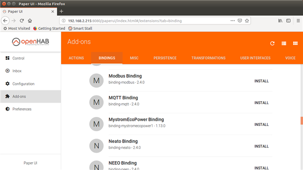

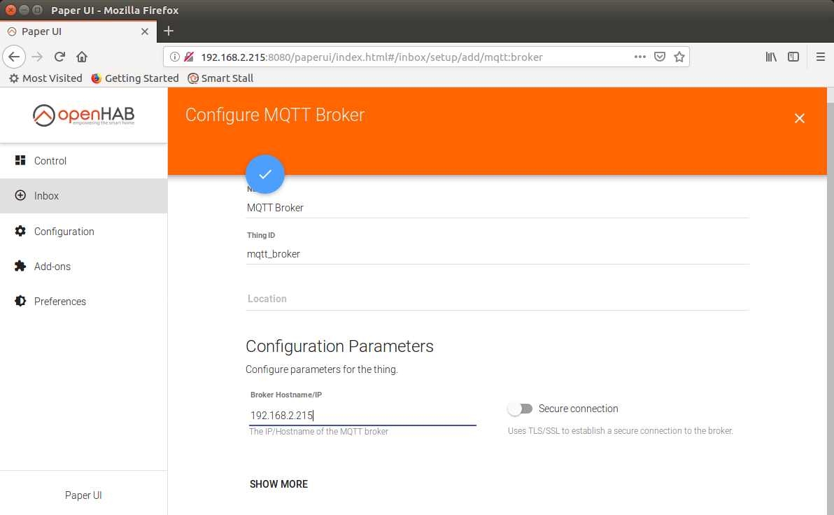

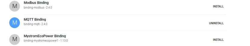

  With the Mosquitto MQTT Broker installed and running, use the openHAB 2 PAPER UI to add the MQTT Broker Binding and create a MQTT Broker Thing.
   1.  Open a browser to the openHAB 2 address and navigate to Add-Ons and Bindings and then scroll down to the MQTT Binding option and click Install.
   Once installed, the 'M' in the circle will turn blue.

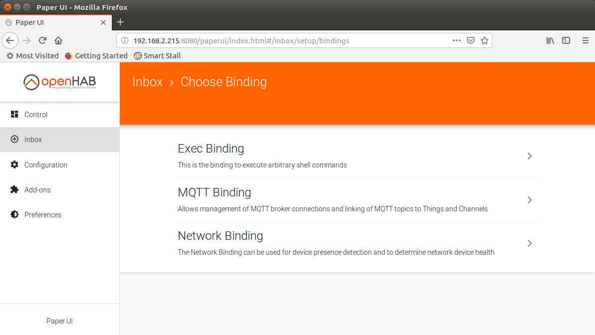

    2. With the MQTT, Binding installed, from the PAPER UI, click on Inbox and then the Blue Circle with the '+' symbol.
         NOTE: the MQTT Thing Binding should be listed under Choose Binding.

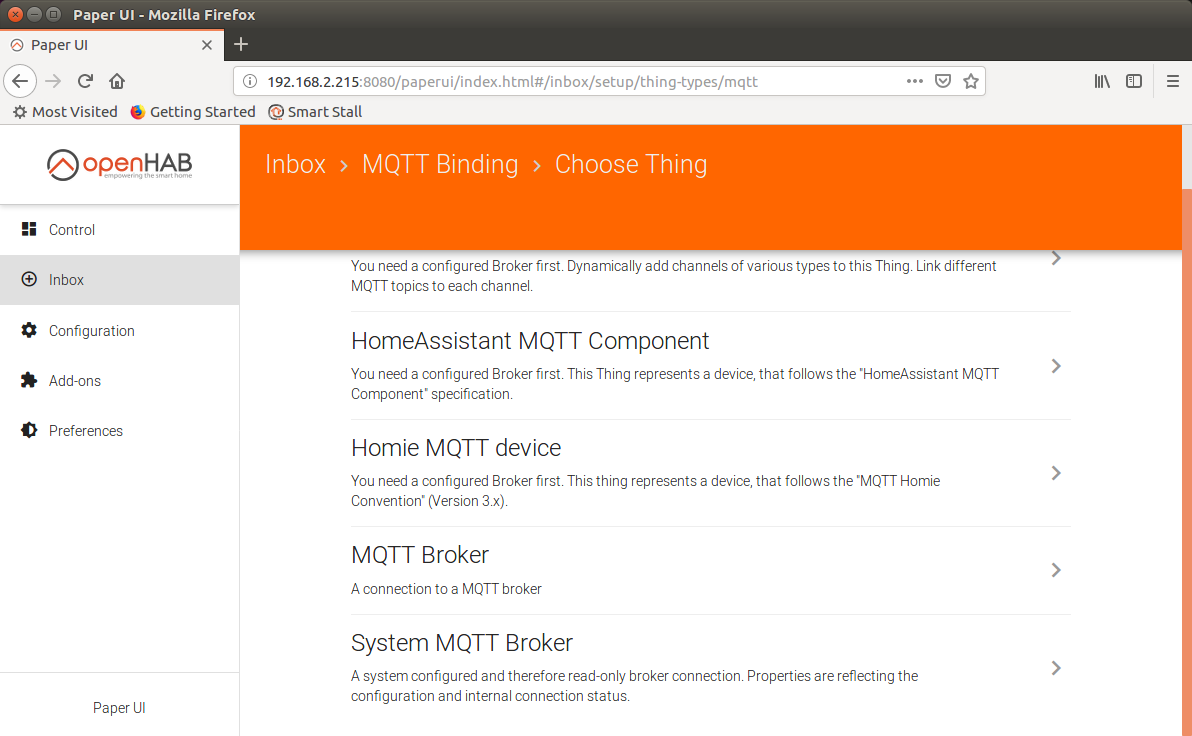

    3. Click on MQTT Binding and a window will appear and any MQTT Things found will be listed.  Click on ADD Manually to add the MQTT Broker.
    4. A new window will appear listing a number of MQTT Things that can be added. Click on MQTT Broker.

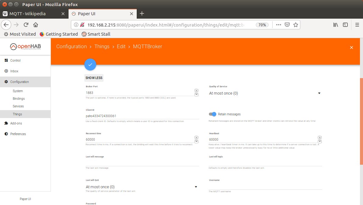

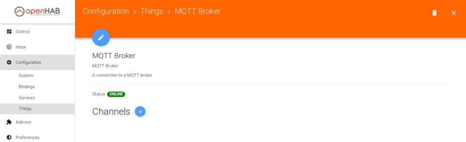

    5. Once the MQTT Broker Thing is selected, a Configure MQTT Broker window will appear where the MQTT Broker definitions can be added.
        Add a Name, Thing ID, Broker Hostname(IP) .
    6. Clock on SHOW MORE to view more configuration options.  Here the Broker Port, QOS, Client ID and other options can be added.
    7.  Click the Blue circle with the check mark in it to save the configuration.  If all goes well, the MQTT Broker will show Green Online indicating openHAB has connected to it.

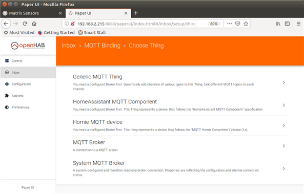

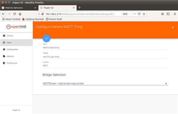

  Add a Generic MQTT Thing

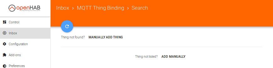

    1.  The next step is to create a Generic MQTT Thing to communicate with.  Click on Inbox again, then the Blue Circle with the plus symbol, and  ADD Manually to get to the MQTT Binding-> Choose Thing screen.
    2.  Select Generic MQTT Thing and a Name, Thing ID, Location and select the MQTT Broker previously configured for the new thing.

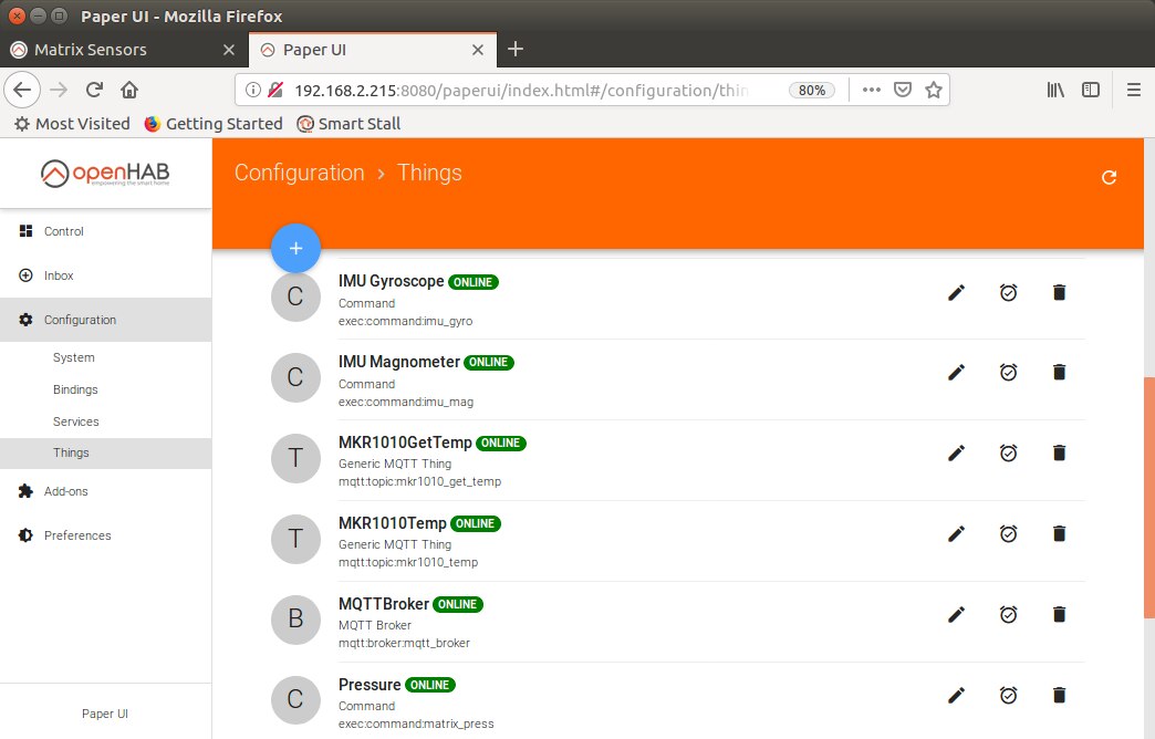

    3.  Click the Blue Circle with the plus symbol to save the Thing.  To view the list of configured Things, click Things under the Configuration heading.

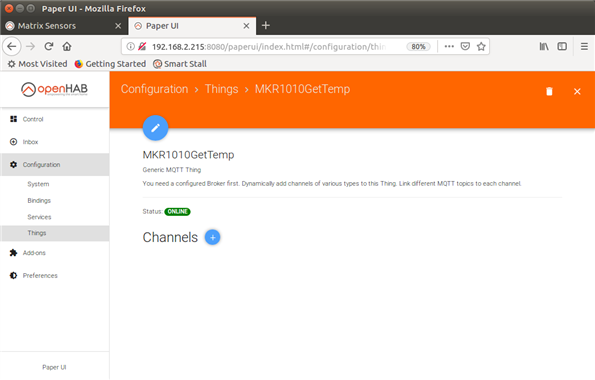

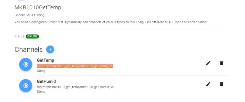

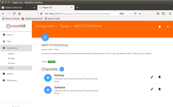

   Add Channels to the MQTT Generic Thing

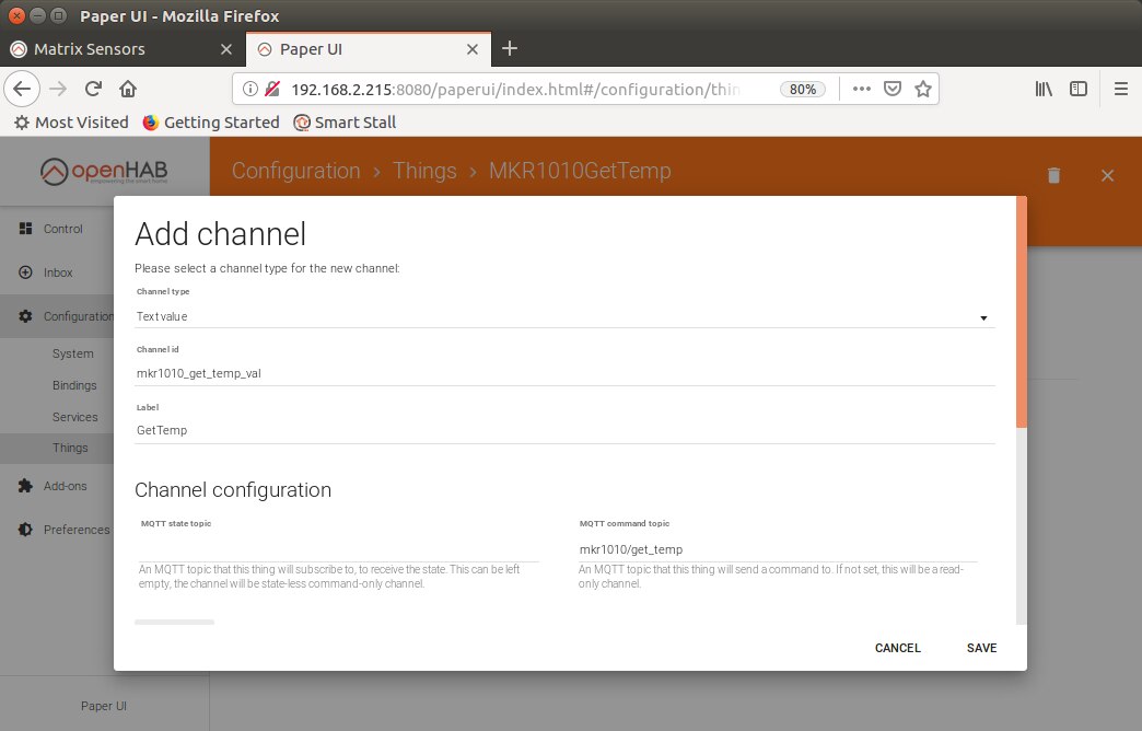

    With the Generic MQTT Thing in place, channels can be added where topics for publishing and subscribing to can be added.  In this project a getHumid and a getTemp topic was create to send messages to retrieve the Humidity and Temp from a connected HUMI-01 sensor.  The values are then published to the associated 'temp' and 'humid' topics and viewed in the BASIC UI.
     1. Click on the new Thing to add a Channel.image
    2. Click Channels to add a channel.  Select a Channel Type (Text In this instance), Channel ID, Label and a MQTT state topic to receive messages or a command topic to send messages.  A command topic mkr1010/get_temp was added here.
    3. Click SAVE and the new Channel will be added to the Generic MQTT Thing.
    4.   Under the Channel Label listing, GetTemp as an example, is the channel ID that will be used to to configure the Thing for the Basic UI.
           Ex: mqtt:topic:mkr1010_get_temp:mkr1010_get_temp_val

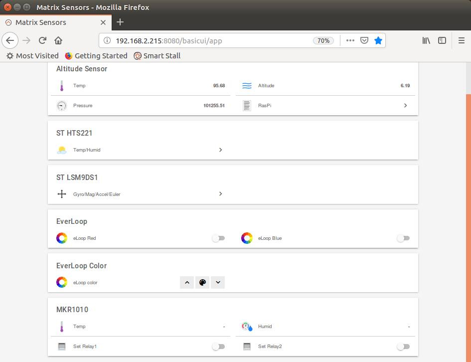

   4.   This is displayed in the Basic UI as follows:
