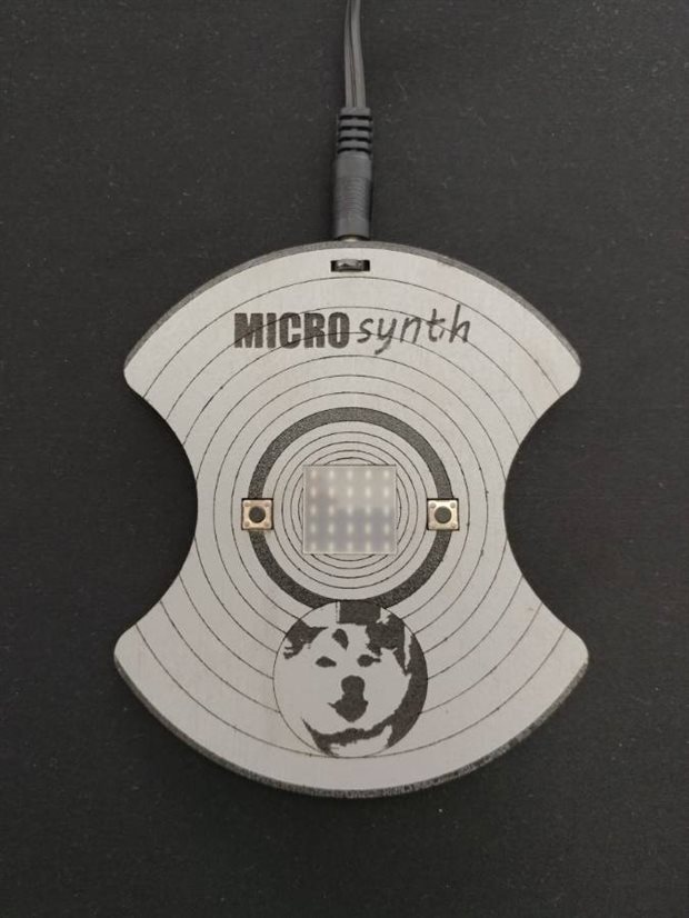

BBC Micro:bit – Accelerometer Tone Adjuster and MicroSynth Case

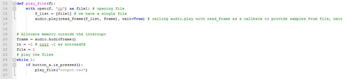

A little bit about the code:
"import audio" is a module that allows the Micro:bit to play sounds from a speaker attached to it. It's key here in playing the file back.
After the WAV file is converted to raw 8-bit audio this bit of code allows the Micro:bit to play it back.

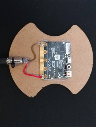

Wire up the Micro:bit as in this simple schematic.
If you built the previous two projects, then you are good to go!

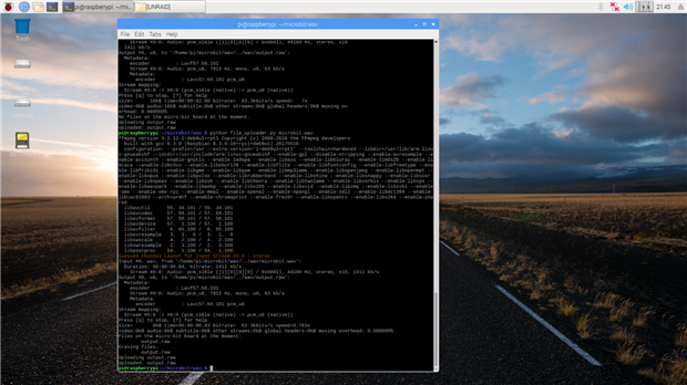

Once in there, you are ready to convert and copy over the WAV file. For practice, use the wav file in the zip called “microbit.wav.” That is me saying “Microbit!”
From the command prompt, type:   python file_uploader.py microbit.wav
You will see ffmpeg encoding and other processing steps. It is converting the WAV file to an 8-bit unsigned raw audio data sample. In this case, the file is called “output.raw.”
At the end of the program’s readout, you will see “uploading output.raw.”
If it worked, then it will say, “uploaded: output.raw.”
This is a screenshot from the Raspberry Pi after I loaded me saying "Microbit" into the file space. (Image credit: me!)
The two example WAV files in the zip should work just fine. But if you go on to copy over your own WAV files, you may experience some errors. Like I said, I found most audio samples under 2.5 seconds long copy over OK.
