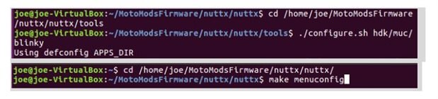

Switch to the new target, this will configure the defconfig in the blinky folder when we launch the Nuttx config tool. At the beginning we created the blinky folder.
$ cd $BUILD_TOP/nuttx/nuttx/tools
$ ./configure.sh hdk/muc/blinky
Enter the commands
In the Nuttx configuration we have to set up a few things to get the communication between the STM32 micro to work. First we turn on “Vendor Raw Support”. Navigate to each from the top menu and check
Device Drivers  --->
  [*] Greybus support  --->
    [*]   Vendor Raw Support
System Type  --->
  STM32 Peripheral Support  --->
    [*] TIM6
Board Selection  --->
  Select target board (Motorola HDK MuC)  --->
    [*] Blinky LED Mods Raw support
Back. Scroll Down
After checking “Blinky LED Mods Raw support”. Exit

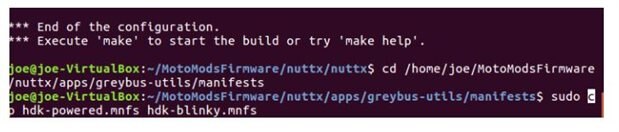

Next we will copy the “hdk-powered.mnfs” Hardware Manifest file and name it to “hdk-blinky.mnfs” Then configure it.
Enter the commands above.
