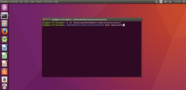

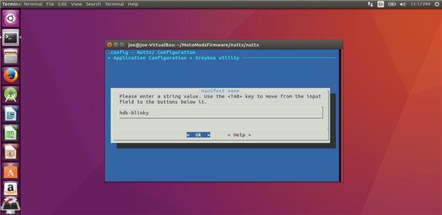

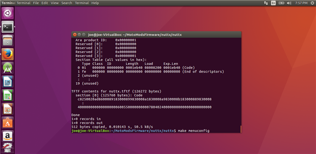

Step 1:Now that we’ve edited the Hardware Manifest file we need to go back and configure it back in menuconfig

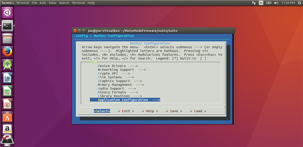

Step 2:Scroll down on main menu
Step 2:
Step 2:

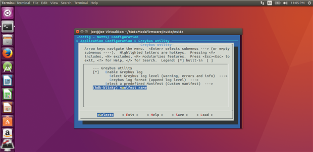

Step 3: Click on the last field, we will name this field the same name as the Hardware Manifests file “hdk-blinky.mnfs”

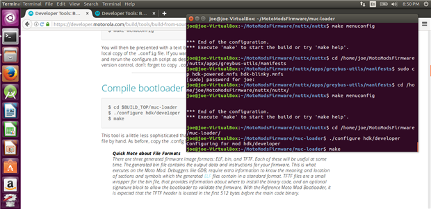

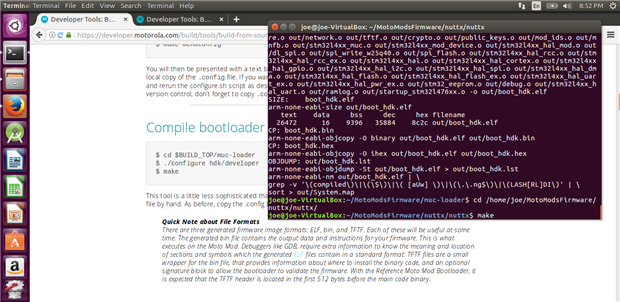

Step 5: Configure the Bootloader
Step 6: Compile Nuttx
Step 6:
$ cd $BUILD_TOP/nuttx/nuttx
$ make menuconfig

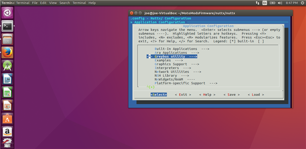

Application Configuration  --->
  -*- Greybus utility  --->
    Select a predefined Manifest (Custom manifest)
      (hdk-blinky) manifest name
Enter “hdk-blinky”

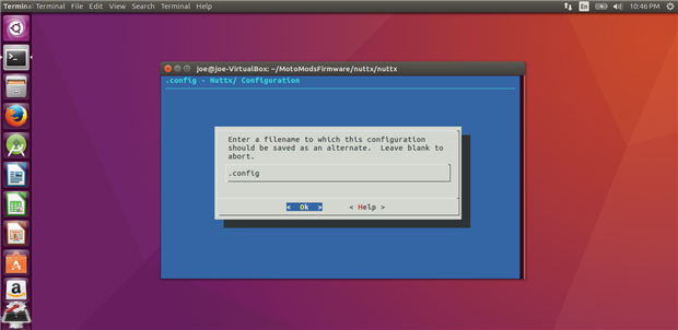

Hit Ok and scroll right and press Save.
Exit 3X.
Compile Nuttx
