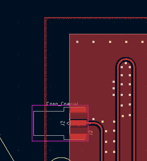

Place the PCB and check the layout
Next open the PCB, and load components from schematic. The two SMA connectors, resistor and netlist will be loaded. Do your layout.
The J1 and J2 footprints are those we downloaded with the LibraryLoader. Check the 3D layout:

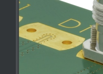

    scottiebabe over 3 years ago in reply to scottiebabe +1
    I believe I caught a glimpse of mmWave magic:) https://www.svmicrowave.com/images/uploaded/Solderless_PCB_Compression_Mount_Connectors_Application_Note.pdf

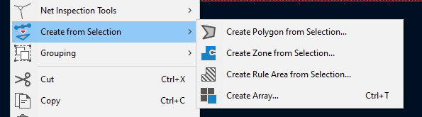

    scottiebabe over 3 years ago in reply to Jan Cumps
    I have been tinkering with kicad, the create array makes via stitching pretty easy
    There may be even fancy ways, don't know...
    Jan Cumps over 3 years ago in reply to scottiebabe
    Yes, that looks like the real magic. The backside of the pin doesn't have to be a ring. A copper area is OK.
