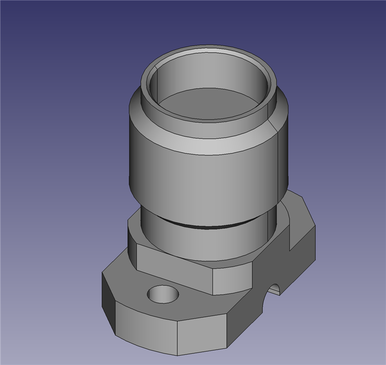

    Jan Cumps over 3 years ago in reply to scottiebabe +1
    I'm going to validate the footprint vs the component drawing, to see if it's OK. I'm hesitant to use a footprint from the vendor that's behind a copyright or NDA. I showed the 3D model for giggles - there…
    Jan Cumps over 3 years ago in reply to Jan Cumps +1
    alternative (and prettier :) ) model:
  • scottiebabe
    scottiebabe over 3 years ago in reply to scottiebabe +1
    I believe I caught a glimpse of mmWave magic:) https://www.svmicrowave.com/images/uploaded/Solderless_PCB_Compression_Mount_Connectors_Application_Note.pdf
    I showed the 3D model for giggles - there's a better one available I believe.
    The footprint itself looks decent at first sight...
  • scottiebabe
    Cool beans JC. I don't trust these cad bulk libraries. Is there a recommended footprint from the mfg?
    Your 3d model looks nothing like the connector and has a through hole pin?
    +1 to you, -1 to Amphenol and samac...

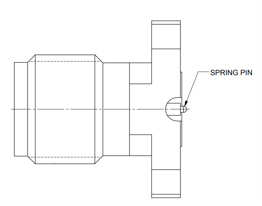

    Not directly related to the blog, but part of the SMA connector documentation: this is how it's expected to be mounted:
     image image
    It's a solderless device, with a spring powered centre pin. Designed to be used on very thin copper layers without damaging it.
