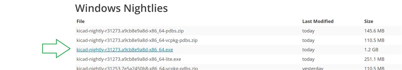

    It is in the nightlies - I may have optimistically called it RC1 :)
    shabaz over 3 years ago
    Very good! I look forward to downloading KiCad 7 and giving it a shot too!
    Where did you find the KiCad RC1 build? The site mentions nightlies page, but I can't find it there:
    https://downloads.kicad.org/kicad/windows/explore/nightlies
    (or at least I cannot see anything there with 'rc1' in the text.
