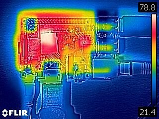

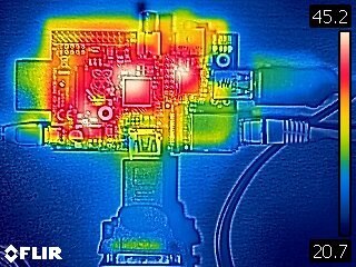

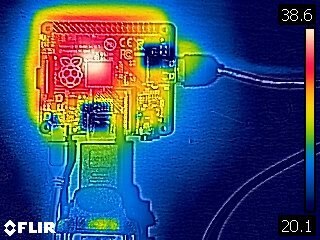

Power Usage
You can find some strange little devices that will plug in line with your USB hardware and it will tell you the most useful of things, such as how much power is being drawn! So I thought "sweet! Let's see how much power these draw while idle!" - using an in-line USB device I had to hand, I've literally copied the output from the device. Not all of the results are relevant for the wired connection we're using.
Raspberry Pi 3 Model B+ Raspberry Pi 3 Model B Raspberry Pi 2 Model B Raspberry Pi 1 Model B+
4.94 V 2.865 W
0.58 A 00656 mAh
5.19 V 1.141 W
0.22 A 00006 mAh
5.19 V 1.038 W
0.20 A 00102 mAh
5.19 V 0.986 W
0.19 A 00003 mAh
These values are how much power the Raspberry Pi is pulling from the power supply, each Raspberry Pi was set to boot to the terminal, so that the X windows environment was not running. The only devices connected were a HDMI to DVI adapter to a 19" Widescreen monitor, a Dell USB keyboard, a 16gByte Class 10 microSD card and the power supply, which was providing 5 Volts, 2 Amps. There was no ethernet cable plugged in (though I can note that when it was, the power usage went up in all cases).
The boards were all tested using the Official Raspberry Pi 2.5A, 5V power supplyRaspberry Pi 2.5A, 5V power supply , though the readings acquired above were not (since I didn't in the last benchmark tests). Although the Raspberry Pi can sort of run on 500mA, 5V and a lot of people do so from either a laptop USB port or a 'phone charger'. If you're trying to get any serious kind of use from the Raspberry Pi, and you're trying to narrow down problems you're experiencing with it, you want to ensure it's using a 'known good' and reliable power supply like the Official power supply unit, and really I am not just saying that, the thunderbolt icon for low power (or the rainbow icon in the corner) is pretty frustrating and it's likely your Raspberry Pi will slow itself down because it cannot be provided with enough power.
That being said, we're seeing the Model B+ reported a drop in voltage at idle than its previous counterparts, with a significant increase in current, it's almost double. The Pi3 B+ sees a new circuit to handle power management, and we see later in this blog that the Pi 3 Model B+ runs as hot when idle as the original Pi 1 Model B at full load as well.

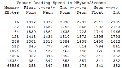

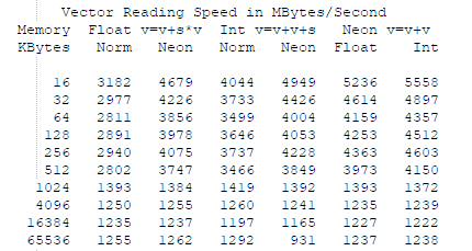

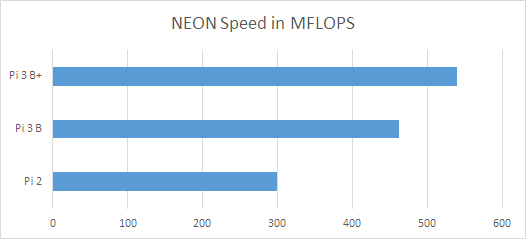

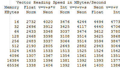

NEON Speed Test v1.0
image image
NEON technology was added with the Raspberry Pi 2. This increase in speed result should mean that the Pi 3 is faster at handling calculations relating to video, vector graphics rendering (so gaming and 3D) and potentially audio processing. Again it is interesting to see the point at which the performance starts to fall off.
There was also another NEON related test, which was the Linpack Single Precision Benchmark. This related the speed to MFLOPS, The Raspberry Pi 3 Model B+ shows a 17% speed increase over the Raspberry Pi 3 Model B, and a 80% speed increase over the Raspberry Pi 2 Model B.
Pi 2 : 299.93 MFLOPS
Pi 3 B : 462.07 MFLOPS
Pi 3 B+ : 539.68 MFLOPS

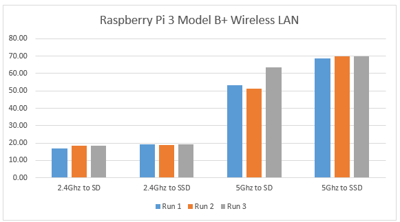

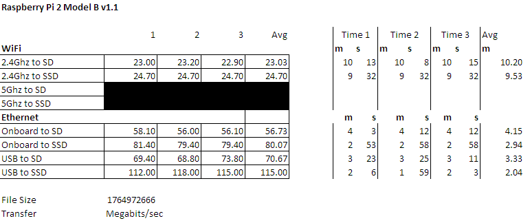

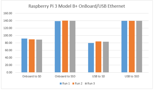

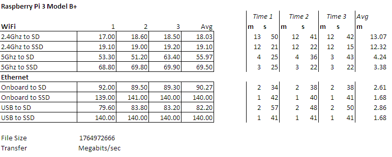

Networking the Raspberry Pi
Two years ago the Pi Foundation introduced us to networking the Raspberry Pi using wireless technologies thanks to on board wireless local area network (WLAN) and Bluetooth Low Energy (BLE) with the Pi 3 model B, with the Pi 3 Model B+ we're seeing a significant standards upgrade for all of the networking components. Not only has the wired local area network (LAN) been upgraded thanks to a new USB 2.0 chip, so has the WLAN chip.
Ethernet on the Raspberry Pi 3 will now run up to 300 megabits per second, technically speaking this is gigabit Ethernet (802.3ab) and it is limited by the throughput speed of USB 2.0 (approx. 480mbit/sec), this is still a significant increase from the 100 megabits per second (802.3u) seen on every previous Raspberry Pi.
The introduction of 5 GHz WLAN brings us up to date with 802.11n and 802.11ac IEEE specifications, allowing the Raspberry Pi to connect on frequencies that are less congested than the over-used 2.4 GHz band which is shared with Bluetooth, most radio frequency controlled keyboards, mice, joy pads, game pads, DECT phones, and radio controlled toys, oh and microwave ovens!
The 802.11n and 802.11ac standards are also faster than the previous implementations (802.11b/g, although you can run 802.11n over 2.4Ghz it is still limited to 54 megabits per second like the previous standards), where as 802.11n/ac can go much, much higher. Typically it is limited by the implementation and how many antennas are used (utilising Multiple In, Multiple Out (MIMO) speeds in excess of 100 megabits per second through to gigabits per second are not unheard of, though unlikely on the Raspberry Pi at present).

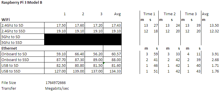

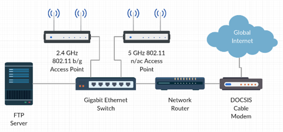

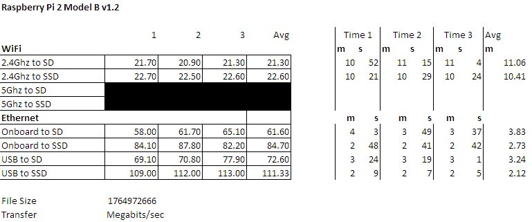

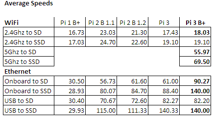

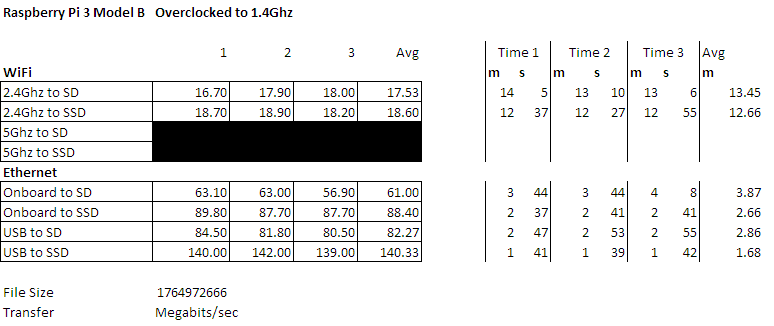

Testing Network Throughput
With the new network adapters on the Pi 3 B+ it makes sense to put them through their paces, it has been many years since I have had access to a proper academic network testing laboratory from my University days, so instead I set up the hardware at home. To understand how I setup the core structure of this network, I felt it would help to have a rather broken-out view of the network layout (or topology):
Using a File Transfer Protocol (FTP) server to test transfer speeds is, to me, the most visceral and raw test of data transfer you can do. Without encryption sat on top of the method of communication, or protocol, it is very bare bones and just takes your network connection and throws data across it. Which is what we are interested in!
It is unlikely you would strictly find a setup exactly like depicted in the diagram above like this, in your own home. Devices are not usually split into their individual components unless you are at a networking data centre, medium to large size business, or a University campus. At home you're more likely to see a device like this:
Image result for virgin media superhub
These are typically called 'gateways' though everyone calls these a 'home router' or a 'home modem', it actually integrates the wireless access points, ethernet switch, network router and cable modem in one device and is usually based around an ARM micro-controller or equivalent. Thanks Virgin Media. For the purpose of these tests we are only interested in the network to the left of the 'router' in the detailed diagram above, we do not actually 'talk' or transfer data out to the global internet with any of these tests that I have performed.
Setting up the Tests
The FTP server in the diagram is actually a desktop computer system that is used as my main computer in the house, it runs a 'Solid State Drive' (SSD) which is a storage device based on a type of memory rather than spinning metal disks, a 2.8Ghz intel Core i7 processor, gigabit ethernet and 16 gigabytes of RAM. I decided it was best to use some hardware that would not be the main restrictive component in the testing of the Raspberry Pi models.
Each Raspberry Pi model tested was then plugged into the official 2.5A, 5V power supply, keyboard, mouse and monitor screen.
A copy of the latest Raspbian image was downloaded from the RaspberryPi.org site and stored on the FTP server, this was some 1.6gByte in size as a zip file.
The file was then transferred either over the the following:
  • On board 2.4 GHz WLAN
  • On board 5 GHz WLAN
  • On board Ethernet (100mbps or up to 300mbps)
  • USB 2.4 GHz WLAN (WiPi)
  • USB 3.0 Gigabit Ethernet adapter
Thinking about it, finding a compatible 5 GHz USB WLAN adapter would have also been a good comparison test, oh well, maybe next time.
To compare the speeds, the file was then saved in the following ways:
  • Over FTP and saved to the SD Card
  • Over FTP and saved to an SSD connected to the Pi Desktop HAT via USB
If you're not familiar with the Pi Desktop, it is an enclosure and Raspberry Pi HAT which is designed to help you run your Raspberry Pi as a desktop computer (Desktop Computer Kit for Raspberry Pi ) by allowing you to connect your Raspberry Pi to an SSD and boot from it over USB. It made sense to use this as a basis of testing the file transfer as the SDCard could impose a limit on the transfer speed.
These tests were performed on the following boards:
  • Raspberry Pi 1 Model B+ (required WiPi)
  • Raspberry Pi 2 Model B v1.1 (required WiPi)
  • Raspberry Pi 2 Model B v1.2 (required WiPi)
  • Raspberry Pi 3 Model B (2.4 GHz WLAN, no 5 GHz)
  • Raspberry Pi 3 Model B+
The test script was pretty simple. Using the linux command wget to pull the file from the FTP server, it automatically timed the download, and for a granular comparison, I set the transfer speed to megabits as opposed to megabytes. This test was performed in triplicate so I could then take an average for time and also speed. This test was then dumped to a text file.

The Speed Results are in!
From the early versions of the Raspberry Pi we're seeing a steady increase in data transfer speed capability. It appears that the limitation now is the transfer speed to/from the SDCard used for the Raspberry Pi, though with the introduction of the Pi 3 Model B+ we still see a speed increase between the Raspberry Pi models, it is evident that the best transfer method when using one Raspberry Pi with the Model B+ is going to be the on board ethernet, followed up closely by the 5 GHz WLAN.
The reason why I had chosen to test a USB 3.0 Ethernet adapter is that I read a blog post that advised using one because it was faster than the on board controller chip. I am pleased to say that it is now on par and there's no reason to spend money on additional hardware, unless say, you're using it as a 'firewall' or 'proxy' gateway and need the throughput.
The speeds across the boards were reasonably consistent with a few percentage of change on each run, and while there's not a lot between the Pi 3 Model B and the Pi 3 Model B+ for 2.4 GHz WLAN (and obviously using a USB Ethernet adapter), the strength of the Pi 3 Model B+ definitely shows in the new USB and Ethernet controller chip and wireless LAN chip as the speeds match and exceed the default alternative.
For your perusal, you can see the individual network speed results, along with a bonus set from an accidentally overclocked Raspberry Pi 3 Model B to 1.4GHz, the benefit of seeing this benchmark is to show that the speed of the data transfer isn't entirely locked to the processor speed alone and there have been other improvements as well.
{gallery} Network Speed Results
Raspberry Pi: 1 Model B+
Raspberry Pi: 2 Model B v1.1
Raspberry Pi: 2 Model B v1.2
Raspberry Pi: 3 Model B
Raspberry Pi: 3 Model B - Overclocked - Oops!
Raspberry Pi: 3 Model B+

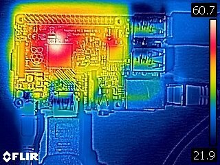

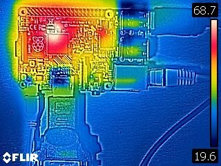

Cool Runnings
If you were around for the Raspberry Pi 3 launch you may remember that there were photographs circulating that showed it ran a bit warm (Raspberry Pi Operating Temperature Comparison (A+, B+, Zero, Pi 2, Pi 3) ). You'll be pleased to know that with the Pi 3 Model B+ the thermal management is performing really well. With the new SoC package the processor can dissipate heat a lot better, even when it is under load.
Thanks to FLIR's C2 thermal cameraFLIR's C2 thermal camera, we're able to take photographs, and thanks to a touch of thermal tape, even the emissivity of the metal cover on the SoC managed to not get in the way (you can adjust for it with the camera, but I was taking no chances!)
{gallery} Raspberry Pi Thermal Imagery
Raspberry Pi: The original Pi 1 Model B
Raspberry Pi: 1 Model A+
