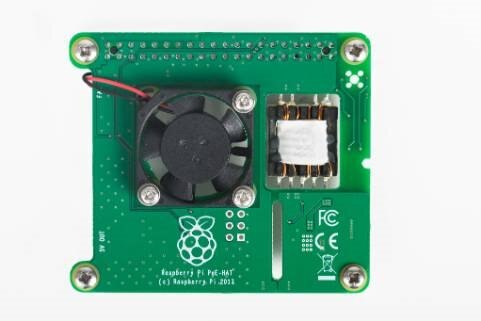

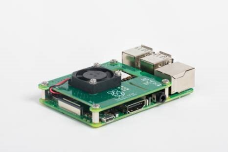

Raspberry Pi PoE (Power Over Ethernet) Hat
NEW! Raspberry Pi 3 Model B+
Technical Specifications | Compliance Documentation | GPIO Pin Out | Unboxing Video | Benchmark Tests | Frequently Asked Questions | Comparison Chart | Pi PoE Hat | Pi Accessories | Pi Projects
Boot and power your Raspberry Pi 3 B+ or 4 over Ethernet.
Buy NowBuy NowBuy Now
The official Power over Ethernet (PoE) add-on board for the Raspberry Pi 3 Model B+ or Raspberry Pi 4! Use this HAT to power a Raspberry Pi via an Ethernet cable, removing the need for a separate power supply, an ideal solution for embedded and IoT projects. For Raspberry Pi 3 Model B+ and onwards, an 802.3af compliant POE injector, switch, or router device is required (not included).
  • Power over Ethernet 802.3af compliant
  • Power over Ethernet Boot (PXE Boot)
  • Class 2 device
  • Fully isolate Switched-Mode Power Supply (SMPS)
  • 36-56V Input Voltage
  • 5V Output Voltage
  • Supplies up to 2.5A
  • Fan Control
  • Plug-and-play compatibility with Raspberry Pi 3 Model B+ or Raspberry Pi 4
Best of all, it fits within the official Raspberry Pi Case!
