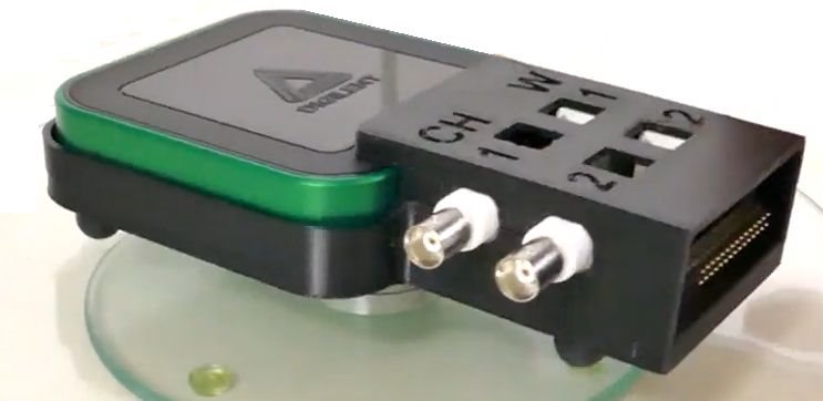

I am road testing a Digilent Analog Discovery 3 which included a BNC Adapter accessory module. The adapter connects to the Analog Discovery module via a 30 pin header, but there are no other mechanical fasteners to stabilize the connection. BNC cables are usually stiff enough to create stress on the header connection so I designed a chassis to mount both modules and stabilize the connection.
Enclosure Image
Design Features
  1. Shelters exposed PCB and connections from accidental touching and ESD
  2. Provides mechanical stability between the modules
  3. Prevents random metal objects from accidentally shorting pins on the pass-through 30 pin connector
  4. Prevents the pass-through connector pins from getting bumped and bent
  5. Retains visual access to labels on the main module
  6. Holds the 2 modules rigidly in optimal mating positions
  7. Provides clear labels for the BNC connectors
  8. Provides access to the configuration jumpers without any disassembly
  9. Provides easy access to the pass-through logic analyzer pins without any disassembly
  10. Provides non-slip feet that prevent the device from slipping around on the bench
  11. Provides clearance under the BNC connectors to allow adequate finger access to operate BNC connectors
  12. The case is a snug fit and quick to assemble
  13. Matches the black color scheme while still exposing the green side walls
  14. Provides the system with a robust, functional, "finished product" aesthetic
Enclosure Video
Discussion
I put some significant thought into designing an appropriate enclosure for the AD3 and BNC adapter assembly and it paid off with a very functional system that meets all my design criteria.
I am very pleased with the way it turned out. It definitely makes the AD3 into a more useful instrument.

    could you please provide the stl or step files for the AD3 case? Currently, the file format in the zip file is 123dx.
    Thanks
    dougw over 2 years ago in reply to javagoza
    It would be feasible to have a sliding window in the cover, although that was not an objective for me.
    It would also be possible to substitute switches on the case instead of using jumpers (there are both pros and cons to switches - but I didn't even think of it at the time)
  • javagoza
    javagoza over 2 years ago in reply to javagoza
    Reviewing the video again, my sliding top cover idea doesn't make any sense. Your solution is very good, it shows that you have rethought it well. Congratulations again!
