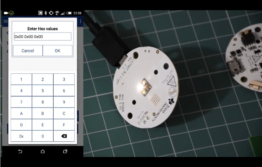

The first thing I started playing with after I unboxed the kit was the Texas Instruments’ BLE LED kit. It’s a nice kit but was lacking a proper Android application to test with. I tried using the Cypress BLE Android application and it turned out that it provides enough information for me to build my own app for Android.

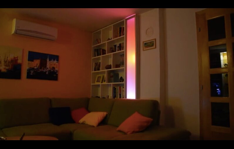

In my next post I demonstrated the custom Android application Android Support for TI's BLE LED Control. At that time, my plan was to use TI’s BLE modules to make tricopter signal lights but later I decided to use them as my living room bookshelf lights.

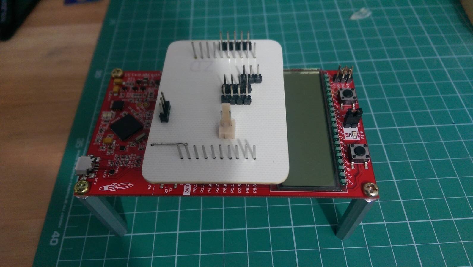

After all this was working, it was time to make the Boosterpack for the Launchpad so that it all looks better when mounted on Tricopter.
Next couple of posts were dedicated to demonstration of various parts of my project… MSP430FR4133 Launchpad with Custom BoosterPack in Action, MSP430FR4133 Launchpad with Custom BoosterPack in Action - appendix, MSP430FR4133 Launchpad with Custom BoosterPack update
