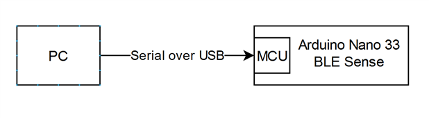

Normally when you develop using Arduino IDE and click Run button in Arduino IDE, the Arduino IDE will open communication over virtual serial port which is provided over USB bus by firmware in microcontroller. Part of firmware responsible for this upload is named as bootloader. Programming using this approach is visualised on following diagram.
This approach has big advantage that it is very simple to understand but have also some disadvantages. This approach is very slow and also has very limited options to allow you debug your program. Debugging is efficiently limited to terminal prints, visualization states using LEDs and so on.

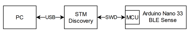

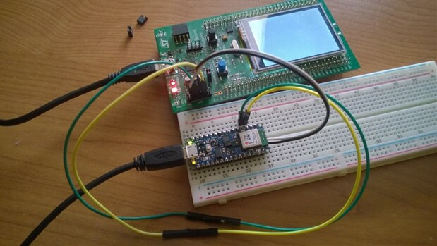

Almost every ARM Cortex-M MCU has debug interface which can be used for stopping processor core on specified instruction and monitoring internal resource of MCU when core is stopped. This approach is available over SWD or JTAG bus. Because these interfaces are not supported by computers you need some convertor which can translate commands from PC to SWD/JTAG signals. Usually this is some debug probes like Segger J-Link, Keil ULINK, Daplink, ST-Link or many others. Structure of this approach can look as follow.
This method have multiple advantages like speed of upload (up to megabits per second in comparison with kilobits per seconds in case of serial) and full debug support, but it have one big disadvantage – you need a debug probe like J-Link. Many professional probes are very expensive but there are ways how to convert some thing or other board to debug probe. For example, If you own some Nucleo or Discovery board from ST you can use it as debug probe. It will looks as follow.
And in real world it will look like on following picture. You can see STM Discovery board (green board with display) with SWD wires connected to roadtested Arduino. SWD is composed by two wires (black and white on picture). One of them is CLK (SWCLK) and second is for data (SWDIO). Green wire is common ground and yellow wire is reset signal to make option to reset MCU by debug probe.

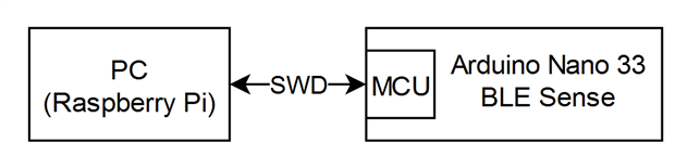

But you still need to have some very uncommon board for debugging. Another very interesting option is to replace debug probe (ST-Link on STM Discovery board in previous example) by Raspberry Pi. Yes, you can use Raspberry Pi for programming and debugging different chip. Raspberry Pi have GPIOs which can be used for emulating SWD bus. Connection is very similar to previous one and I will describe it more later.
The diagram in this case will looks as follows.
Of course, you can eliminate PC from the diagram because Raspberry Pi is also PC.

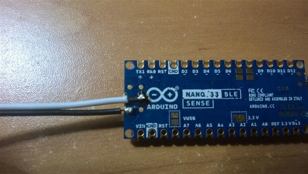

Exposing SWD Wires on Arduino Nano 33 BLE Sense
Now we must resolve black and white wires. As you can see, they are connected to the bottom of board. It is because SWD interface is not exposed on expansion header of board, but it is accessible only on test points at the bottom side of board. There are 5 test points. There are GND and 3.3V pin which we do not need to solder because they are easily accessible on expansion header. There are also reset signal which is also accessible on expansion header. And finally, there are two SWD wires which we must expose. If you want, you can solder all 5 wires but these 2 are sufficient.

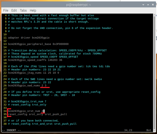

I will modify default pinout for easier interconnection Arduino with Raspberry Pi. OpenOCD needs two configuration files. One for defining debug probe (Raspberry Pi in our case) and target MCU (nRF52840 in our case). I will copy script for defining debug probe to my home and edit them in a way that I change swdio and swclk pins to GPIO2 and GPIO3 on raspberry pi, and I enable support for restart MCU by GPIO4. You can use your favourite editor instead of vim.
cp tcl/interface/raspberrypi2-native.cfg ~/rpi_as_debugger.cfg
cd
vim ~/rpi_as_debugger.cfg
I marked changes by red lines on following screenshot.

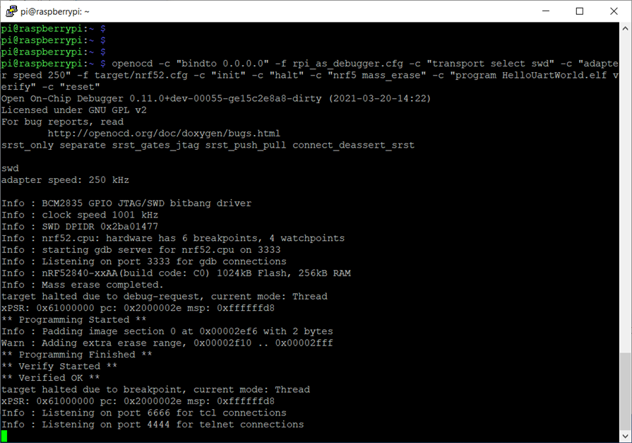

Full command line is following:
openocd -c 'bindto 0.0.0.0' -f rpi_as_debugger.cfg -c 'transport select swd' -c 'adapter speed 250' -f target/nrf52.cfg -c 'init' -c 'halt' -c 'nrf5 mass_erase' -c 'program HelloUartWorld.elf verify' -c 'reset'
You should see similar output to following picture.

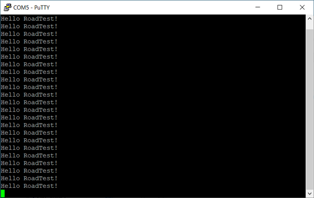

And that is all. Now you have flashed your firmware to device. If you connect RX pin of your USB-to-UART converter to D11 of Arduino, you can see following output.

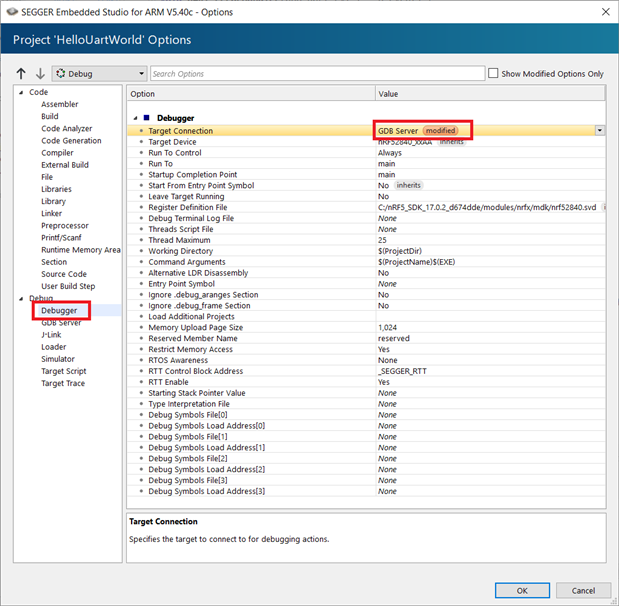

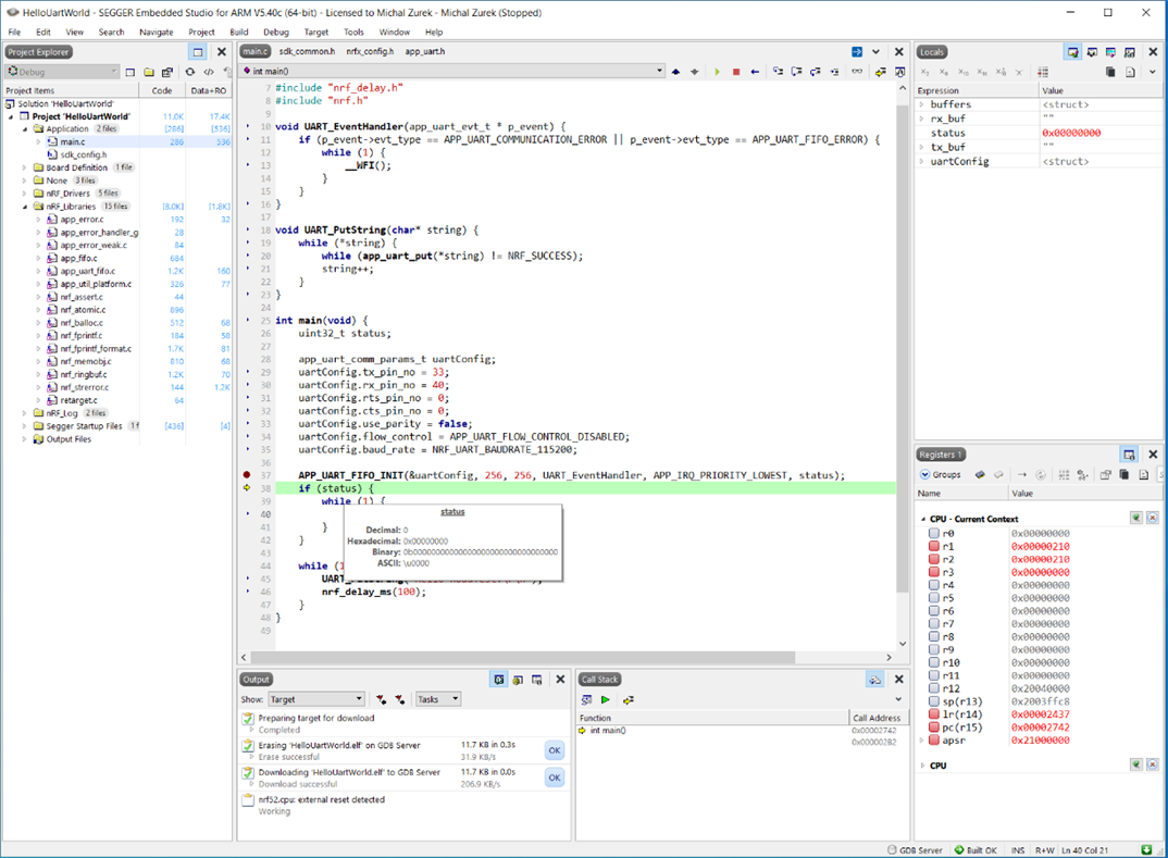

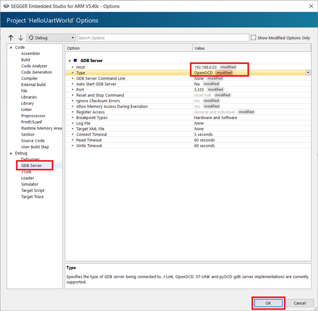

Let your OpenOCD running. We will connect SES to debugging server. In SES in project Explorer right click the Project (not a Solution) and select Options. In Options Window select Debugger tab and change Target Connection to GDB Server.
Then go to GDB Server tab and change Host to IP address of Raspberry Pi and change Type to OpenOCD. Then confirm by OK.

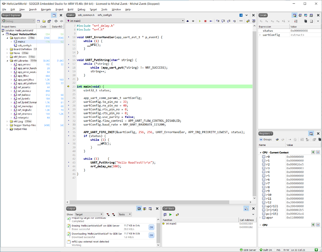

Now you can start debugging using F5 key. You should see marked first line of main because debugger restarted MCU and stopped CPU at main.
Place breakpoint on APP_UART_FIFO_INIT and press Continue in menu. Program will run until it breaks on any configured breakpoint.
Press F10 to step one line down. Your code will halt on condition checking for status of previous operation. You can hover mouse over status variable and view their content.
Then you can press continue to run program. Because there is no additional breakpoint it will run code and it will run infinite loop printing message. You can add breakpoints wherever you want and analyse behaviour of program, variable values and so on.

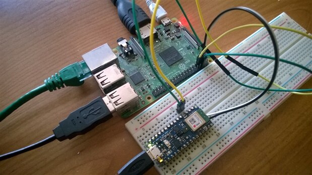

  • joebro391
    joebro391 over 5 years ago in reply to misaz
    Okay, thank you.
    I appreciate all of your help. I will let you know if there are any further developments.
    Best,
    Joe
  • misaz
    misaz over 5 years ago in reply to joebro391
    It is interesting. I tried following my own tutorial again to check that I did not forged mention anything but it worked to me with exactly same config as you posted and connection. I exhausted all my ideas how to help. You can view signal lines by scope to check if there are some significant noise, glitches or something similar but otherview I have no idea what can cause problem. Only difference is that I have connected to Raspberry Pi directly using short wires, while you are using breadboard and adapter but none of this should cause any issue.
  • joebro391
    Thank you, Michael.
    Ran the command as specified and still have the same errors. Everything is the same as shown above and my rpi_as_debugger.cfg file definitely has the following:
    bcm2835gpio_swd_nums 2 3
    bcm2835gpio_srst_num 4
    reset_config srst_only srst_push_pull
    I do have a scope that we can use to analyze if we want to. I also have a spare boards if we fear any damage. I doubt that's the issue though, as my friend is experiencing the same issues.
    -Joe

  • joebro391
    haha, marvelous.
    I checked the raspberrypi2_native.cfg file and it had the default settings. I only updated the rpi_as_debugger.cfg, as instructed. I then updated the raspberrypi2_native.cfg to match and got the same issues. It should be noted that I'm using a Raspberry Pi 3 B+.
    pi@Pi1:~$ cat openocd/tcl/interface/raspberrypi2-native.cfg
    # Config for using Raspberry Pi's expansion header
    # This is best used with a fast enough buffer but also
    # is suitable for direct connection if the target voltage
    # matches RPi's 3.3V and the cable is short enough.
    # Do not forget the GND connection, pin 6 of the expansion header.
    adapter driver bcm2835gpio
    bcm2835gpio_peripheral_base 0x3F000000
    # Transition delay calculation: SPEED_COEFF/khz - SPEED_OFFSET
    # These depend on system clock, calibrated for stock 700MHz
    # bcm2835gpio_speed SPEED_COEFF SPEED_OFFSET
    bcm2835gpio_speed_coeffs 146203 36
    # Each of the JTAG lines need a gpio number set: tck tms tdi tdo
    # Header pin numbers: 23 22 19 21
    bcm2835gpio_jtag_nums 11 25 10 9
    # Each of the SWD lines need a gpio number set: swclk swdio
    # If you define trst or srst, use appropriate reset_config
    # Header pin numbers: TRST - 26, SRST - 18
    # bcm2835gpio_trst_num 7
    # reset_config trst_only
    # or if you have both connected,
    # reset_config trst_and_srst srst_push_pull
    Here are the pictures of my setup, but this is a fairly simple wiring job. Note that I went back to the Nano 33 BLE and also swapped the wiring back to their original configuration.
    Nano    to    Pi
    Gnd     to   Gnd
    Reset   to  GPIO4
    White   to  GPIO2
    Black   to  GPIO3
