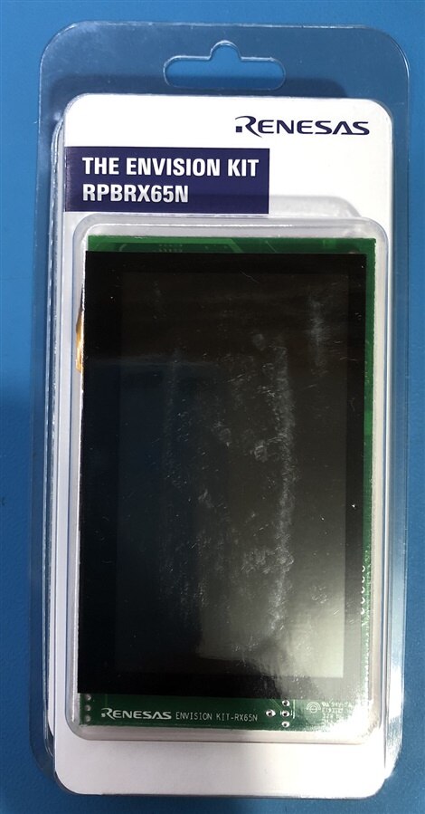

The kit comes in a blister pack held within a much larger cardboard box so is well protected against the vagaries of delivery companies.
My particular example followed a route from Illinois to Kentucky to Pennsylvania to Stanstead to Stanford Le Hope to Northampton and finally my house so it certainly passed through a number of hands without mishap.

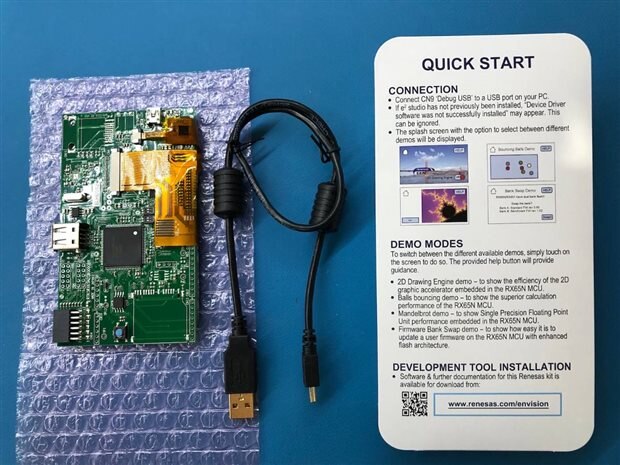

I can see from the box that a quick start guide is provided and on opening, the ‘kit’ provides the evaluation board, a USB cable and the guide.  The LCD has a protective film which is not unusual  and given the number of marks and fingerprints on the display obviously needed.  I’m really pleased that a USB cable is included as I’m never able to locate one when I need to, and doubly pleased that its just a standard USB A to Micro B and not some non-standard port.
The quick start guide really is just that - you can read it in the image above.  Nevertheless, it is what I was looking for: information that will let me confirm the board is not DOA.  It also provides the link to more information and the development tool.
There is another quick start guide available on line here.  This contains data flow diagrams for updating the firmware which are a little confusing at first observation, but I’ll come back to it when I’m ready to update the firmware - the 2D drawing engine demo help text implies it needs a firmware update to show the operation of the graphic accelerator.
Additionally, there is an Envision Kit user manual here.  Having read through this, it gives a good overview of the board, components, port mappings, interrupts and configuration.

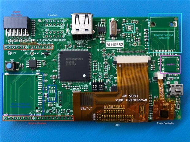

Let’s take a look at the board itself (excuse the reflection.)

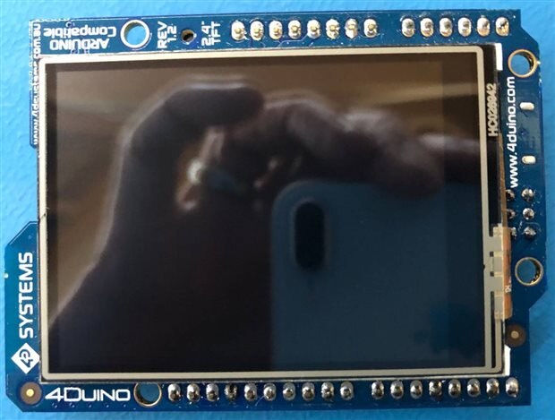

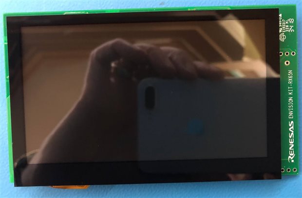

The most obvious elements are the flex-PCBs linking to the capacitive touch-enabled TFT-LCD, which is a WQVGA (480x272 pixels) physically measuring 105mm x 67mm (4 1/8” x 2 5/8”) with a visible area of 95mm x 54mm (3 3/4” x 2 1/8”) - 110mm (4.3”) on the diagonal.  It is a 24-bit colour display but Renesas has it connected as 16-bit colour with mapping between the two for managing colour variation.  It’s not clear if this is because the onboard graphic controller is only capable of 16-bit.  The visible area is well positioned within the physical display and is not offset to leave unpleasing borders around the sides.  This I think will turn out to be more useful than might be immediately apparent: the visible area is bordered by a uniform black area that will make it a lot more pleasing when mounted and in operation as a prototype.  When the visible area is offset, a lot more shenanigans are required when mounting so that it doesn’t look misplaced or awkwardly positioned.  As a comparison, see what the 4Duino provides with a thick border on one side plus a silver trace and visible connectors:
The MCU is bang in the middle; the components are clearly annotated and I expect these can be reviewed in the Schematic - a document only available to registered users, something I will do in the next instalment.
As this is an evaluation board, some components can be added by the customer.  Although not populated, these are all traced to ports on the RX65NE:
  • Arduino Headers: CN10 map to Analog A0 to A5 pins; CN8 map to power and ground pins; CN13 and CN12 map to D0 to D13, aref, SCL/SDA and GND pins.  The Envision board can be powered through the USB-microB connection (lower right hand side of the PCB) and it does seem possible to power the board from the 5V Vin pin by the application/removal of 0Ohm jumpers.  However, the debugger must be powered from the USB socket however else the board is powered.
  • SD Port and power management
  • Joystick - there is currently one connected user switch, blue marked SW2, but this will allow the connection of a more complex input mechanism.
  • Ethernet port and transceiver
Renesas has given part numbers that can be used in these positions which is handy as it indicates they have been tested for use.  I am particularly interested in the Arduino headers and SD card extensions as they will be part of the Road Test; I’m also a bit nervous about those flex PCBs which will need to come off to remove the LCD so those components can be soldered to the board.  That’s for later and hopefully I will find information that helps in the process.
The headers at the top are spare MCU port headers with no specific definition - the User Guide doesn't explain these - but my assumption is that these are mapped to ports on the MCU so that they can be used for whatever purpose needed.  The switches to the bottom right of the MCU are for configuring the onboard E2 debugger and configuring the USB/Serial UART Operation.  I will certainly be using the onboard debugger and If time permits, I shall be investigating the latter.  It is possible to use the board with an external E1 debugger by connecting to headers that are currently hidden under the LCD flex PCB.
