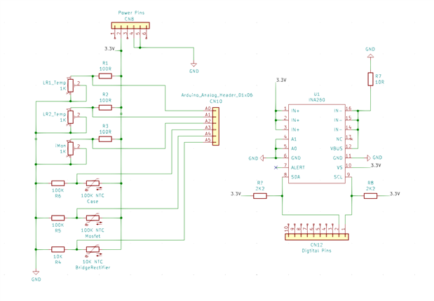

The RX65N MCU operates at a voltage from 2.7V to 3.6V.  The 12-bit ADC analog input pins' voltage is AVss <= Vpin <= AVcc.  AVss and AVcc do not need to be tied to Vcc but on the Envision board they are and VCC = AVcc = 3.3V; Vss = AVss = 0V.  There are two 12-bit conversion units: 0 and 1; thus, AVSS0; AVCC0; AVSS1; AVCC1.  The Arduino pins are tied across both groups.
Therefore, voltage on the Analog pins must lie between 0V and 3.3V.  I was going to connect this to my PSU, but its Vout for analog conversion on the thermistors is set to 0V to 5V; the pull-ups on the I2C lines are to 5V as well.  The maximum temperature the thermistors could read without blowing the voltage limit would be 40C and they would do that easily: soak testing whilst I was building the unit indicates that. I could do this with a voltage divider I guess but it’s just going to affect the results.  Instead, I will do it via a breadboard: I have an INA260 IC that I can plug in to read Voltage and Current (via I2C) plus three thermistors for temperature readings.  I can simulate other temperature readings and current (which are driven off the Linear Regulators with a small current) with trimmers.  The Arduino pins on the Envision board provide for a 3.3V output which can be used to drive the test circuit.
So, although not quite what I wanted to do, the principle is exactly the same.  Indeed, this is highly representative of the circuit inside the PSU except:
  • I’m forced to use 1x10K and 2x100K thermistors because of the parts I have, rather than 3x10K
  • I  will drive everything at 3.3V rather than 5V, or 0-15V for the load.
  • The Linear regulators generate a small current for their temp pins and iMon current setting; I will use three trimmers.
I think this is still a perfectly valid test as the underlying approach is the same and it will reach a conclusion on how easy this is to program and set up as a HMI interface to any hobbyist project.
Here’s the test circuit:

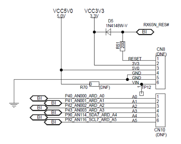

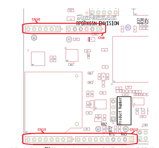

The Envision board will use the Arduino headers to drive the ADC units as below, specifically CN10 and CN8:
From the images above it’s possible to see that the power supply for the test circuit can be pulled directly off the board.  The analog pins, A0 to A5, are tied to ‘channels’ on the RX65N ADC units:
  • AN000 to AN003 are Unit 0 and channels 0 to 3
  • AN114 and AN116 are Unit 1 and channels 14 and 16
These are important elements in the API which are heavily unit and channel driven, as you’d expect.  There is a FIT module for the ADC functionality, r_s12ad_rx, and it is specific to the RX65N.  The application note that comes with the FIT module to explain the API is comprehensive and to be fair against what I’ve posted in the past, quite understandable.  It does describe the APIs in terms of ALL functions irrespective of the capability of the RX MCU you have: that is, it is up to you to work out what is/is not available for your particular MCU.  It could do with a summary chapter to cover this really as I ended up having to implement the FIT module, configure it, generate the code, then inspect the header files to determine what I could/could not do.  I also found it necessary to also consult the RX65N hardware manual as well, which is a 2,729 page monster packed full of detail (as manuals go, large but extremely comprehensive.)  Not a major problem really.

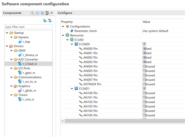

Ok, so we know the channels that will be used.  Configuring the ADC module to use these is extremely simple:
Basically, install the module then select both units and the 6 channels.  In the image above, channels 14 and 16 are off the display but are ticked.  This also automatically sets the right Ports and Pins on the RX65N and generating the code creates the necessary headers and setup code.  There’s nothing dramatic here, it really is as simple as ticking some checkboxes; it is worth pointing out that the hardware manual warns about various combinations of ADC pins in conjunction with nearby output pins which will affect the results - basically, avoid those combinations if at all possible, otherwise use averaging and discard highest/lowest readings and/or other techniques to improve the accuracy.

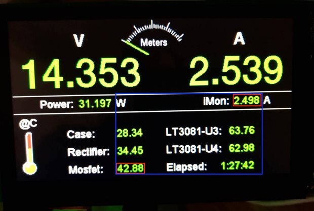

At the bottom of the post there is a video showing the display updating, but next I'm looking at the I2C interface.

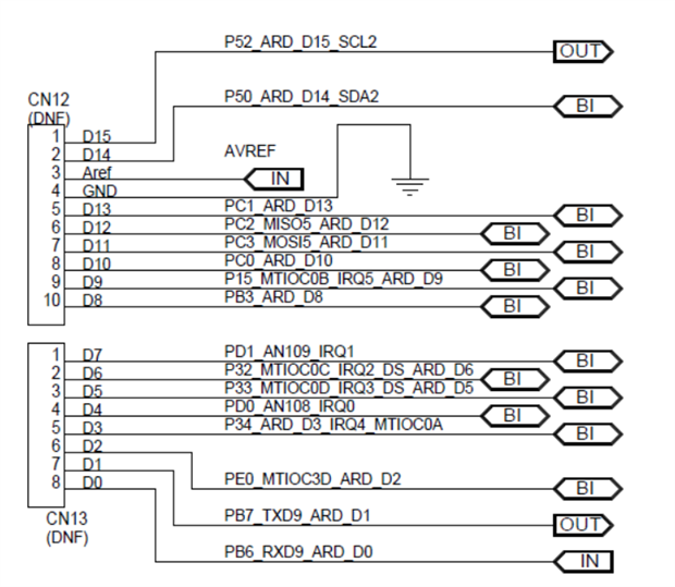

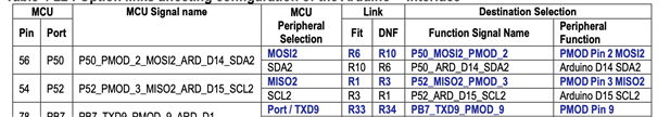

Volts, Amps and Power are going to be read using the I2C interface from an INA260 IC.  On the Envision board these SDA and SCL are in the standard Arduino position:
On this board though, ports 50 and 52, Pins 56 and 54, are shared with the PMOD connector and the board is set up, by default, for connections through than connector.  Some re-configuration is required to use the SDA/SCL lines then:
The resistors are, thankfully, easy to get at and look like 0805 size which I can manage:
However, do I need to swap them over?  Can’t I just plug the leads into the PMOD connector and have ports 50/52, pins 54/56 configured as SDA/SCL?  I don’t see why not - there are 200R resistors in series with PMOD pins 2 and 3 but that won't interfere with the SDA/SCL signals.  So I'm not going to actually change these over unless it does cause a problem - I have no wish to damage anything accidentally and whilst not difficult to get to they are only about 1mm away from the MCU.

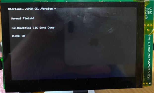

Sending data

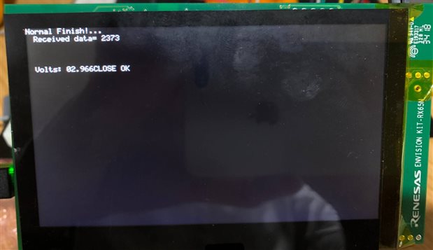

First approach will be to just create a simple app that sends some data to the INA260 and make sure there are no errors.   It doesn’t seem too complicated looking at the demo code - I will amend that to send the configuration data to the INA260 that I want.  This would consist of (values from my old code/INA260 data sheet):
  • Send the slave address, 0x40 (this is configured by wiring two of the INA260 to ground)
  • Send the config register to update, 0x00
  • Send a high byte to tell it to take 16 averages, 0x65
  • Send a low byte to tell it the conversion time 8.244ms, 0xFF
Note that the INA260 treats the first data byte received as high, the second as low.  There’s no specific flag or other indicator to determine that.

Some explanation:
  1. Most of the above is self explanatory given the data values I want to send
  2. The I2C connection is initially not initialised; this setting will ensure the module does this
  3. The callback function is executed once a NACK is received from the Slave;
  4. As noted above, the Arduino headers are operating on Channel 2.
The basic operational logic is to:
  • Initialise and open the connection to the slave
  • Send the address data (data1st)
  • Loop until a Finish status is received…
  • …terminating if a timeout is reached (in my demo, a simple counter up to 100)
  • …on a NACK response, send the data (data2nd) OR terminate on 200 NACK signals (arbitrary, but set to 200 in my demo)
I’m just outputting some status strings to the display as the app goes through that process.  And the result:
Success.
Next, is to read some data from the INA260.  During its operation, the IC is storing volts, amps and power in their own registers.  To read these values, I need to send the register to read to the IC (no additional data), then receive the data, high byte followed by low byte.   Volts will do and that value is stored in register 0x02.
The process to set register 0x02 and receive two bytes is pretty much the same as above:
  • Send the address data (data1st) - 0x02
  • …ask for the data (data2nd)
Here’s the configuration code for receiving data:
    sci_iic_return_t ret;                   /* For verifying the return value of the API function */
    sci_iic_info_t iic_info_device;         /* Information structure for slave device*/
    uint8_t slave_addr_device[1] = {0x40};  /* Slave address of device  */
    uint8_t access_addr_device[1] = {0x02}; /* Address to be accessed in device  */
    uint8_t receive_data[2] = {0x00, 0x00}; /* Receive data */
/* Set up the configuration data structure for Simple IIC operation. */
   iic_info_device.p_slv_adr = slave_addr_device;   /* Pointer to the buffer to store the slave address */
   iic_info_device.p_data1st = access_addr_device;  /* Address to be accessed in device (to be updated) */
   iic_info_device.p_data2nd = receive_data;        /* Pointer to the buffer to store the second data (to be updated) */
   iic_info_device.dev_sts = SCI_IIC_IDLE;       /* Device state flag (to be updated) */
   iic_info_device.cnt1st = sizeof(access_addr_device); /* First data counter (to be updated) */
   iic_info_device.cnt2nd = 2;                         /* Second data counter (to be updated) */
   iic_info_device.callbackfunc = &callback_sci_iic_receive;     /* Callback function */
   iic_info_device.ch_no = 2;                           /* Channel number */
Some explanation:
  1. Receive data is two bytes; high in position 0, low in position 1
  2. The device status at the time of receiving is now idle and shouldn’t be re-initialised
  3. The rest is pretty much the same as explained for Sending.
Again, it works and it was incredibly simple to get working.  When I did this for my PSU with a 4Duino, I had access to the “wire” library and commands were “simpler” because the configuration was hidden in the library, but what you see above is easily obtained from the Application Note and sample program, adjusted for my purpose.  Even setting up the base configuration through Smart Configurator was intuitive.  Just to be sure that it is talking, I’ve tested error conditions, e.g. by removing pull up resistors, and the MCU is reporting error conditions (in this case, bus busy condition.)
Display in Operation
The (shorth and dull) video is showing the operation of the GUI when hooked up and using both the ADC conversion and I2C.  This is running purely on a loop/trigger basis with no attempt to control timings, hysteresis or interrupts of interrupts: a better approach would be to run it purely from a Compare and Match timer with software triggered readings of the ADC.  This would give much better control over ‘when’ and ‘how often’ readings are taken, however for the road test, it wouldn’t really test the more complex aspects of the MCU (i.e. the triggers), only my ability to write simple software.  As an example of what I mean, in my PSU, the Volts, Amps and Power are read every 500mS but the temperatures are read only every 30 seconds.
The point is though, it does show the ADC and I2C features working and as I report above, that was a simple, easily achieved activity on this board.

Multi-Buffering
When I first had the GUI updating values, the screen was flickering during the update.   This is due to the way that emWin works and writes to the driver of the display: essentially, a whole ‘rectangle’ of the display from the top-left point of the first change, to the bottom right point of the last change in that rectangle.
For example, with reference to the above image, if I change the value of the iMon current and the value of the Mosfet temperature, you can envisage a rectangle covering the area marked by the blue rectangle being marked invalid, thus encompassing more than a quarter of the screen.  This whole area being invalid is redrawn.  As this is done frequently, it results in flickering which is very annoying.  The answer is to enable a feature called ‘Multi-buffering’.  When it is, the window manager creates two buffers: a front buffer and a back buffer.  Screen updates are made into the back buffer, then the LCD memory is pointed at that buffer.  Thus, the back buffer becomes the front buffer and the previous front buffer becomes the back buffer!  I hope that makes sense.  In turn, it means the whole screen is redrawn by the LCD driver at once because it's a simple memory address pointer change.  It’s actually possible to triple-buffer, the benefit being related to being able to callback on a VSYNC interrupt which is the ideal point to flip buffers to prevent tearing (VSYNC, as I understand it, is the point at which the LCD has just been refreshed (which it is 50/60 times per second.)  If the app is waiting to swap buffers but needs to draw, it can do so on the third buffer.
It all gets a bit complicated but fortunately, the window manager is able to handle this automatically just by calling the command WM_MULTIBUF_Enable(1).
It works.  Clearly there needs to be enough RAM to be able to do this:  (X-size * Y-size * bitsperpixel / 8) for each buffer.   For the Envision board that is (480 * 272 * 16) / 8 = 255K, which sounds like a lot but here’s a memory captured during the application execution; it’s certainly useful having that extra ram on board the RX65N.
