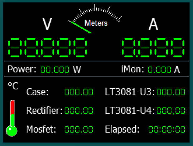

The Goal
This is what I am aiming for:
emWin Tools
This first outline will just be static, to use emWin’s GUI Builder, Bitmap Converter and Font Converter.  There are two sets of graphics and one font; the digits that are displayed on this are actually graphical elements drawn to look like LEDs - I shall probably just use a second font for this.  I will be starting with a copy of the base emWin project (that I created in Part 4C), renamed.  I don’t want this to be a review or tutorial on using emWin, but I’ll cover some basics to show how easy/difficult it is to actually use with the board.

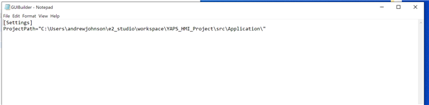

GUI Builder will generate files into a project location specified in GUIBuilder.ini which must be manually changed (for each project):
(The trailing \ is important: without it, the tool will place the file in directory src and append Application to the name)

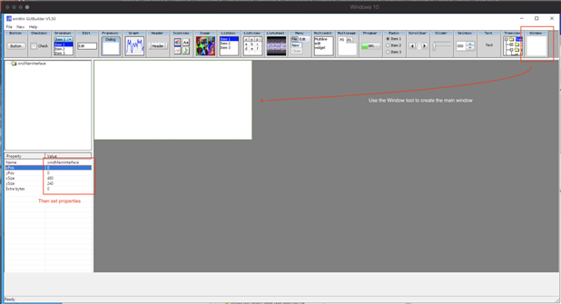

This process will be very familiar to anyone who has used these types of tools before. In the tool, I need a window in which to place widgets, give it a name and set size:

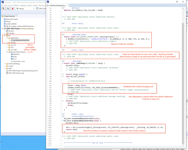

So I’ve given it a name to identify in code and set the size to the Envision board LCD size.  I will add a black background, then when the project is saved, it will generate a source file, wndMainInterfaceDLG.c:
And thus it precedes as one would expect.  Add the widgets required and on save, the source file is generated (re-generated) with updated information.  Some notes on the GUI Builder tool:

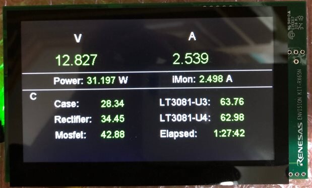

Here’s the first cut running on the board itself:
No graphics yet and the fonts aren’t quite right for what I want (including no ‘degree’ symbol) but those elements will be set up later, as described below.  The only code I have had to add to the base project to get this displayed is the following:
in main():
  extern WM_HWIN CreatewndMainInterface(void);
  CreatewndMainInterface();
There is no separator widget, so the lines have to be drawn as part of the window initialisation.  Due to the way emWin works, the ‘window’ is actually a dialog placed on top of a base window, so in order to draw on it, use of a callback is required.  This is added into the user editing space in wndMainInterfaceDLG:

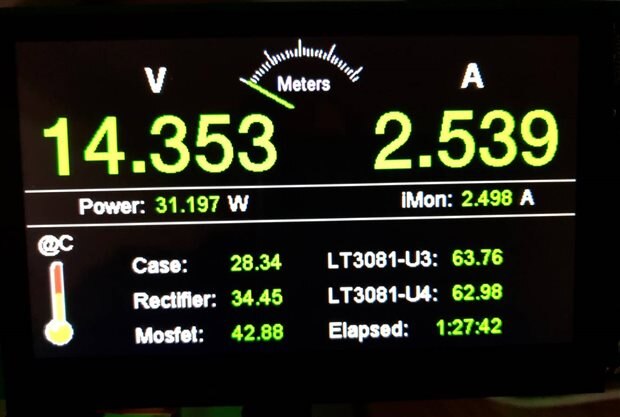

Final result
After playing with the fonts and layout, this is the final result - still a static display, obviously.  Note that on the first image (what I am aiming for) the digits are not a font - they are graphically drawn - but in this version, a font is used.  I haven’t yet worked out how to get the degree symbol: the font supports it, emWin supports it, I can ‘enter’ it into GUI Builder (via Character Map or the keyboard code), but the app won’t display it.  The font used conforms to ISO8859 so there’s something specific I need to do and I will update it when I’ve worked it out.
Just as I got the layout looking right, GUI Builder crashed and I lost my work.  As I re-did it, I was saving regularly but I did notice that it was prompting the ‘overwrite existing file twice’ - i.e. it was actually saving twice for each single request.  The upshot was, that when I rebuilt and ran it, there were no changes!  Re-launching GUI Builder, none of the changes were there so I have no idea where, or if, it actually was saving.  Re-did for a third time: so I’m adjusting my point above from “Stable” to “Fairly Stable”.  The point to bear in mind with saving is that it overwrites any existing file you have, so make sure you have a backup if you are experimenting with alternatives and don’t want to lose your original starting point.

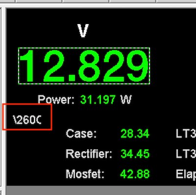

(note how the degree symbol comes out as a '@' character.)

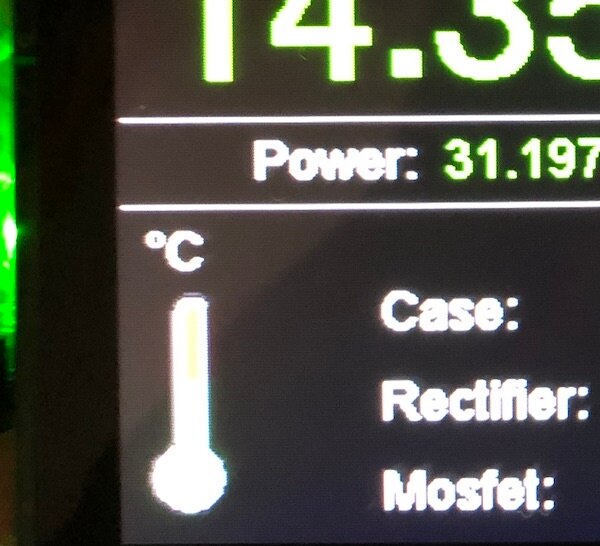

EDIT:  Resolving the degree symbol
I've had more time to think about this and realise what is happening.  I wasn't actually expecting that embedding a degree symbol would work but it did allow me to layout the correct size.  The font itself allows for the decimal symbol which is actually character 176 or hex B0.  Using a string value such as "\xB0C" won't work because C interprets a hex escape sequence as all valid hex characters following the \x - in this case, B0C are valid hex characters so won't work.  The compiler warns about values out of range and nothing is displayed.  "\xB0 C" would work, but there would be a space character between the symbol and the letter C.  We can switch to Octal as that is fixed at up to 3 octal characters: it stops at the first non-octal character or 3 characters whichever occurs first.  176 in octal is 260 so a string value of "\260C" will actually display what I want.  That looks weird in GUI Builder but there appears to be no way around it if I actually want to use a degree symbol.  The answer would seem to get the widget size right, then not worry about the actual text used:
In the above case of course, the widget could be sized as large as needed to display the full text as nothing is to the right of it and it is left-aligned.  So that leaves the final result looking like:

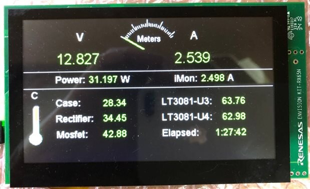

    I had a go at changing the labels on my screen to 'fake' readings

    I had a go at changing the labels on my screen to 'fake' readings image
