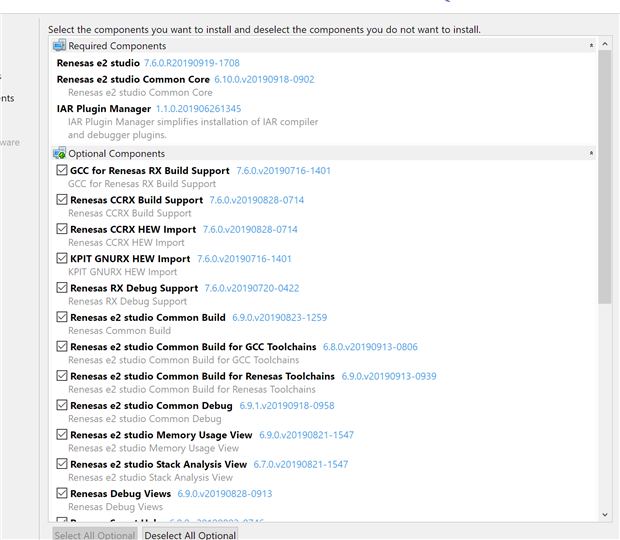

  • It requires Microsoft Visual C++ 2015-2019 Runtime Environment, which it installs itself.
  • You have to select the family(-ies) of MCU that will be used - specific components are installed for the selected families.
  • There are a whole host of optional components that can be installed - a snapshot:
    I don’t know what if any are actually required but I could guess.   I won’t need HEW4 support, nor RTOS, but in any case, I just accepted them all.image
  • A compiler must be chosen - options given are CCRX (various versions) and GCC for Renesas RX (various versions.) I’m going with CCRX v3.01 (it selects v2.08.00 by default) and hoping that it does in fact work under evaluation.  If not, I’ll have to switch to GCC [footnote: it does work so far]

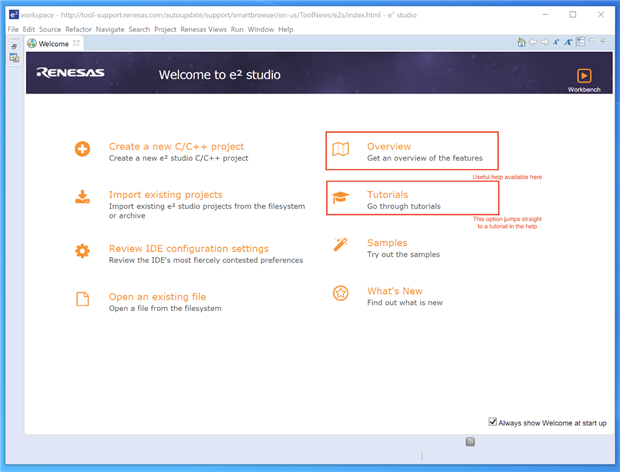

IDEs are complicated beasts with many options and features.  I’m not going to go through each of them you’ll be glad to know but what I am going to do is browse around the tool, documentation and tutorials and report my findings based on what I learn and what I have past experience with.  This will be as I create my application in line with my road test application, but first I will walk through a tutorial to see how well provided for beginners are.  I would expect enough of a walkthrough to get me to the starting gate with developing for this MCU.
As previously mentioned, the IDE is based on Eclipse CDT which is a popular and widely used IDE.  If you aren’t familiar with Eclipse, it has a built in help (e2Studio help) which will guide you through the tool step-by-step - the annotation in the screen shot above shows how to access.  There is also a tutorial for the RX family available in this help or from the tutorial option on the welcome screen.

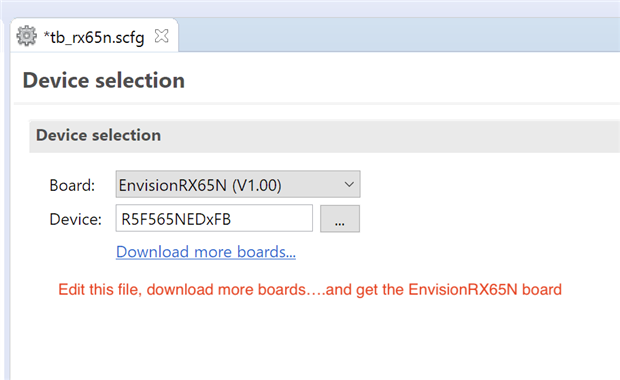

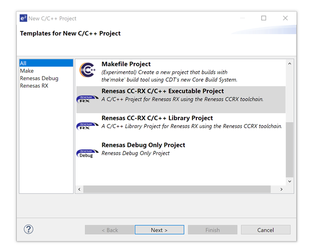

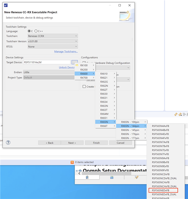

I’m following the tutorial, so File>New>C/C++ project.  This starts a series of wizards to initialise a project with skeleton code based on templates.  Templates available won’t all work as they depend on choices made during installation, however for our purposes we want to use the CCRX template:

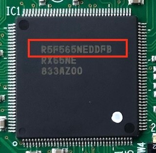

Give it a name and move on.  When creating a project, you will need to specify the toolchain (essentially, the compiler, in this case the CCRX compiler) and the Target Device.  This is the specific MCU and you need the reference code from the board:
In this case, R5F565NEDDFB.  A breakdown of this code is provided here and Page 23, and tells us that this is:
  • R5    - Renesas MCU
  • F       - Flash ROM
  • 5       - ignored
  • 65N  - Product group, RX65N
  • E       - 2MB Rom; 640KB RAM; 32KB Data Flash Size
  • D      - Encryption: yes; SDHI/SDSI: no; Dual Bank Support: No (? - must be different to the firmware dual banks)
  • D      - Temperature: -40C to 85C
  • FB    - Package: LFQFP; Pin count: 144: Pin Pitch: 0.50mm
Giving us:

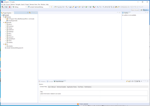

Moving on through the wizard, there are other options to select (not relevant) before the final ‘Finish’ option is selected.  This creates the skeleton project and sets the C/C++ Perspective:

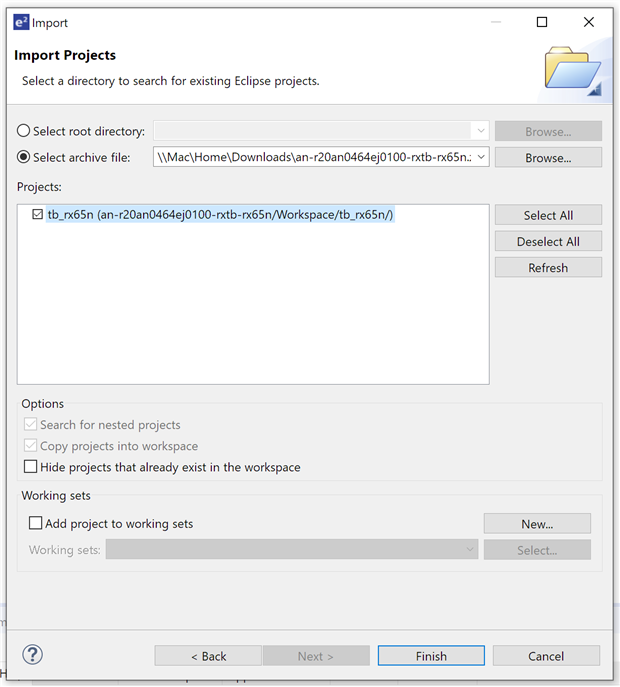

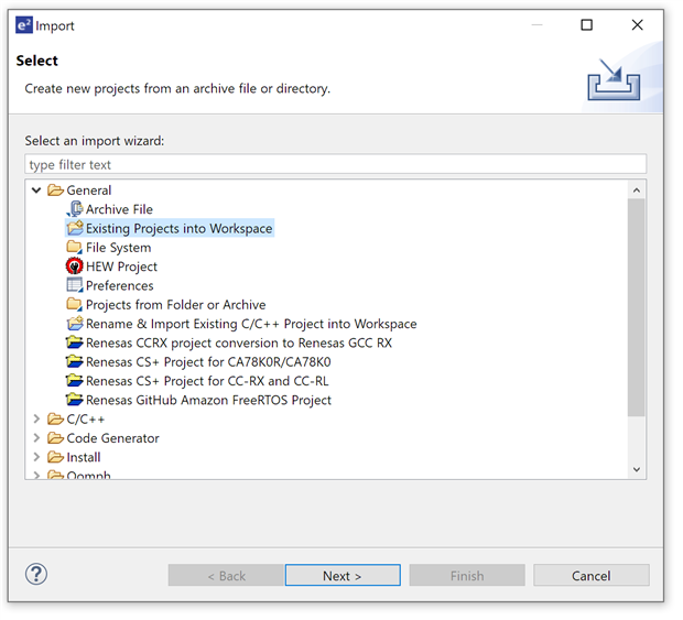

The tutorial works with a sample project - Blinky - for a RX71M board and I need one for the RX65N board - fortunately, a version of blinky is available here.  I’m a little confused here as I will be importing a project, and I’m not sure if this is importing into the one I just created OR that was just to show how projects are created and this is a brand new one - let’s see.

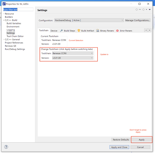

It gives a new project - well, it was useful to go through the first wizard as selecting the right device requires a bit of detective work.  The big test of course, is will it build as imported - I’ve annotated the relevant build selections?

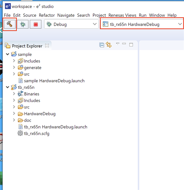

Nope - no path to Make.  Took a while to figure out but, actually, it would seem that the toolchain configured for the project is an older version of CCRX so the configuration needs updating:

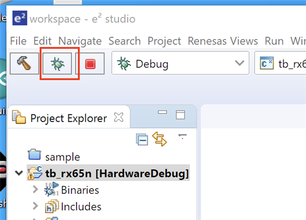

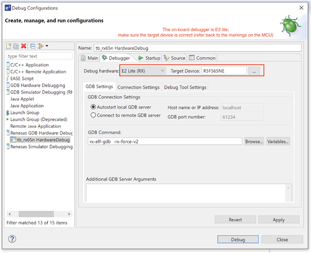

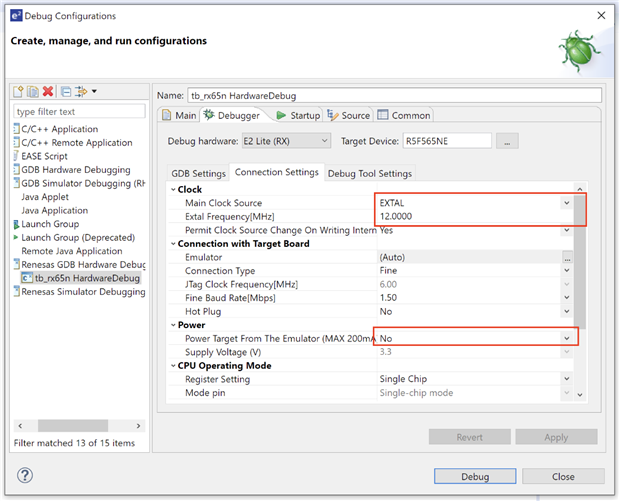

Once that change is made, the project compiles cleanly (well, with 4 warnings.)  Now, configure the debugger:  Run>Debug Configurations and select the option under the Renesas GDB property:
This is slightly different to that specified in the tutorial which I think assumes you will be using a hardware debugger - the Envision Board has the E2Lite on board and must be powered from the USB connector.

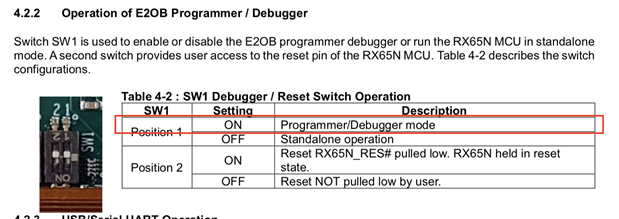

The board now needs to be in programmer/debug mode.  From the User Guide this requires setting switches:
Position 1 should be down, towards ON; although confusingly worded, if Position 2 is also ON then the board can be reset from the debugger without having to disconnect/reconnect the board, at least that's what I think it means!  Once switches are set, then the board can be connected to the PC and Debug pressed.
And….errors.  Board mismatch - the error is reporting that it is using an E1 debug device rather than the E2Lite.  After a bit of to-and-fro, I worked out that the configuration of the project isn’t quite right: the SCFG file needs editing, the Envision board downloaded and selected:

What I failed to realise is that whilst the program is for the RX65N, it’s for a Target Board which isn’t a generic thing but a specific thing!  So whilst it will compile, it won’t Make because of the differences between the Target Board and Envision Board.  I should have realised earlier but didn’t and in my defence I’m finding the structure of documentation on the Renesas web site harder to navigate than it ought to be.  For example, I picked that sample application up from the product page of the R5F565NEDDFB but of course the Sample Code link for that product gives all sample code and you have to do the filtering for what will/won’t work for yourself.  This is a question of getting used to how the site is laid out so as to approach it the right way.
It’s not been wasted effort as the underlying activities to get it configured and built and ready for the debugger are common and I decided to leave it in this post so that anyone who follows after can at least see some of the pitfalls inexperience with the platform can bring.  I may also use the code and re-purpose it for the Envision board as a later activity because that ought to be possible.

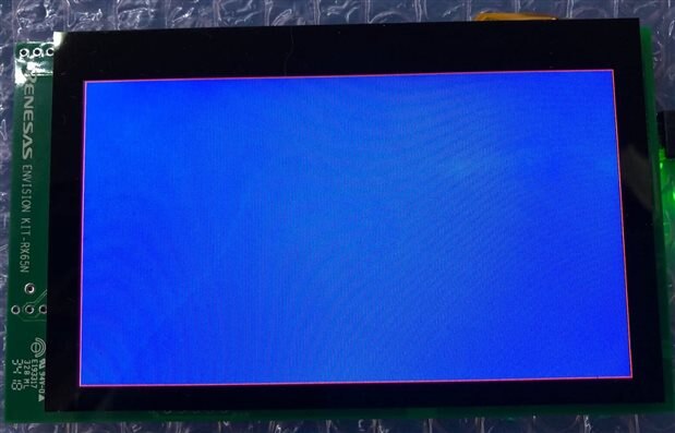

I have found an alternative sample program to use: QE for Display [RX].  This uses one of the Quick and Effective tool solutions to drive the display.  I will not go through the same level of detail as above as the underlying activities should be very similar.

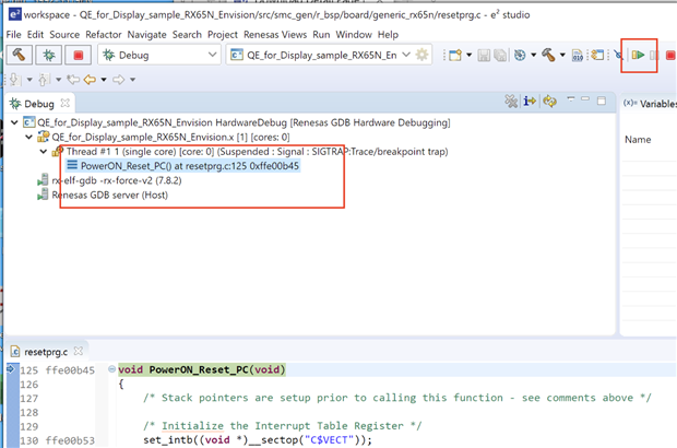

Work through any issues: I found the directory naming structure in the zip file downloaded to be unacceptable so needed renaming; I still had to change the Board and the Toolchain configuration.  However, it does build and Make and it will launch with the debugger, pausing at the PowerON_Reset_PC function - press the resume button:

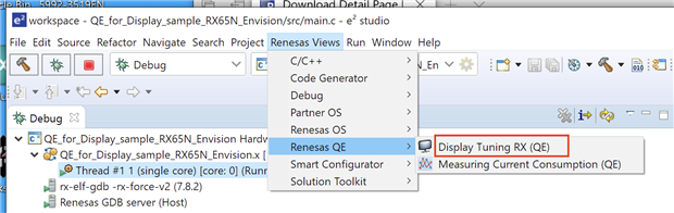

It will pause at main so press resume again.  A nice blue panel is displayed:

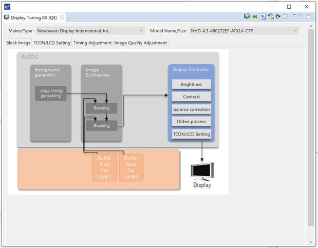

This is where the fun begins with QE for Display.  Launch it:

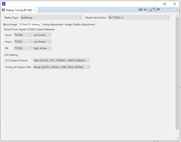

You may need to drag it out of the tabbed panel at the bottom to get its own window.  The Maker/Type must be set to EastRising for the Envision board.
It’s possible then to play with the QE parameters and see the LCD change in real time.  It is much easier to follow the application note that comes with the program as settings need to be made based on the LCD panel.  For example this is how the TCON/LCD setting window should look for the Envision board:
