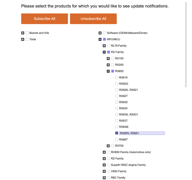

Under your profile, you will then see a bunch of possible downloads as well as news related to the MCU.  I won’t past the list here as it’s very long but these are broken into the following categories:
  • Technical Updates
  • Tool News
  • Software
At this stage, I’m not clear what I actually need so I’ll be back to this page.  I don’t want to download any software yet as apparently the SDK has a 60-day limit on it before its functionality becomes limited.  Admittedly, this is the duration of the road test but still.

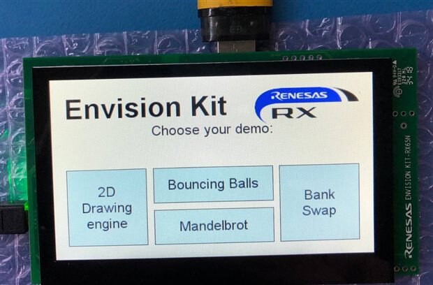

The board has two flash banks for firmware and comes with Standard FW rev 0.90 and Benchmark FW rev 1.02.  These can be swapped over using the demo as an indicator to how it would be accomplished for real: install new firmware into the second bank and swap it over to the first.  This would allow for a rollback if things went pear-shaped so it’s a neat idea.  The onus is on the firmware provider to provide the swap capability - if not, you may be able to swap it in, but not swap it back out again.

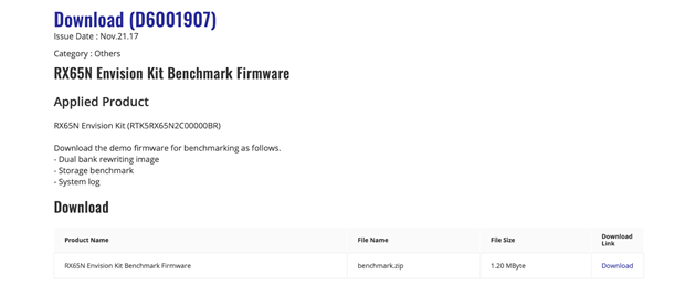

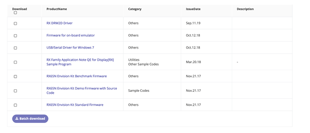

The help text in the Bank demo points me at www.renesas.com/envision.  The downloads page shows three firmwares so I need to figure out which one(s) I need:
Clicking on a link brings up more info, for example the Benchmark Firmware:

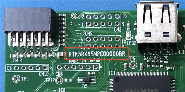

Annoyingly, the description doesn’t say what version it is.  It does state clearly what model of the Envision kit it is for which can be x-referenced to the board itself:
The best way then is to download the three for the board and see.  The firmware for on-board emulator is for a different Envision kit, so there is the Benchmark Firmware, the Standard Firmware with demo programs Firmware, and an amalgamation of the two as Source Code only.  The latter has detailed instructions for compiling the source and uploading to the board - something I expect is needed if you screw up the implementation.
There are no readme files for the two immediately relevant downloads so I’m still none-the-wiser which I need.  All I can go on is that the help text for the Standard FW states to download the latest version which this presumably is;  It could be that the boards are all burned with the same, original firmware and that manufacturing process hasn’t incorporated a newer version (since Nov 2017!).  There is a separate driver download for the 2D graphics engine - RX DRW2D - which can be downloaded, compiled and then uploaded (probably) but I’m hoping that it is already embedded in the Standard FW just downloaded.  I’m not hopeful given the dates against the files, but I’ll have to come back to that when I have a bit more information on the development tools and debugger usage.
I think Renesas could make all this much clearer by providing documentation with the download both on the page itself as well as with a readme file - we’re talking a couple of lines of text really.

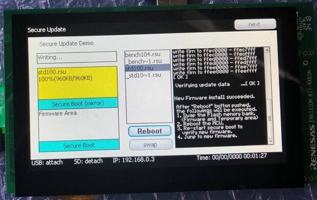

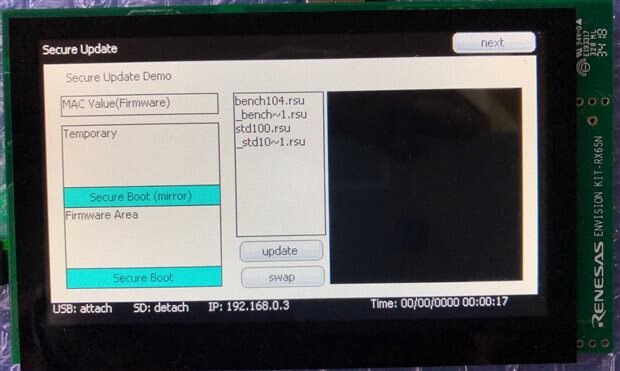

Following instruction on page 2 of the guide.  A firmware file has an extension of .RSU, the downloads are providing the initial version and the updated version, so I copied just the updated version on to a USB stick in the root directory (given no instructions to the contrary so it seems sensible.)  On power on, the demos are displayed, push Bank Swap and then Swap to see the files on the USB:
What this has done is swapped to the Benchmark FW which provides the feature for updating the ‘other’ bank - which contains the Standard FW.  Select the file _std10~1.rsu and press update.  There’s a distinct lack of progress indicated, just “Downloading update data …”.  I also realise I’ve clicked on the wrong file.  Start again… Select std100.rsu and press update: tnow it’s possible to see progress being written to the screen.
Pressing Reboot swaps the FW, reboots the board and the new demo software is loaded.  This contains the updated programs which does utilise the 2D graphic accelerator.  Excellent.  The next update is for the Benchmark FW.  I’ll need to swap to the Benchmark FW to do this so what I expect will happen - having seen the process above - is that  it will update the ‘other’ bank overwriting the Standard FW and I will have two versions of the Benchmark FW loaded…..Yep, exactly what happened.  So I need to repeat the upload of the Standard FW - clearly there is an order for doing this which is obvious in retrospect.
Finally, both FW files are updated.  Perhaps it’s me, but I do think that the instructions could be a little clearer.  However, anyone can get there with a little bit of thinking.  Certainly the User Guide is much clearer once the FW files are found, downloaded and extracted.

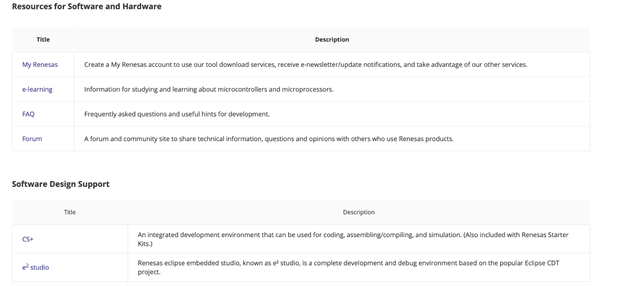

On the RX home page, there is a link to Design Support which provides further links to resources.
You can see from the screenshot a brief description of what the options are, but it’s worth calling out three of these.  They are all part of RenesasRulz which is their user support portal.

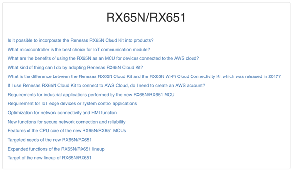

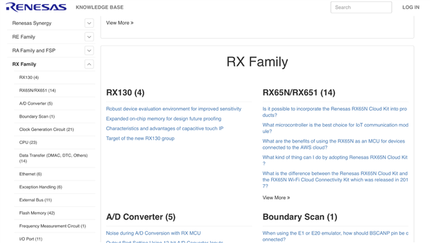

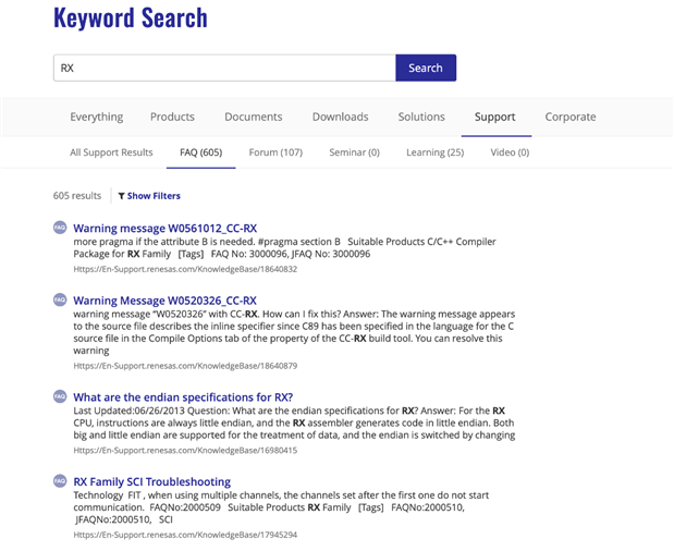

There seems to be two FAQs!  The one accessed from the Design Support tab, screenshot above, and one to the KnowledgeBase from the RenesasRulz portal.
  • The former is pre-filtered to the RX family and is basically just a list of entries in the support database.  It’s organisation is such that I’m not convinced it will be that useful as the entries are out of context:
  • The second, Knowledge Base, is more contextualised and looks like it will be easier to both navigate and find information
    However, there’s little on the RX65N as such so it’s not likely to be very useful.  Maybe not many questions are actually asked!
