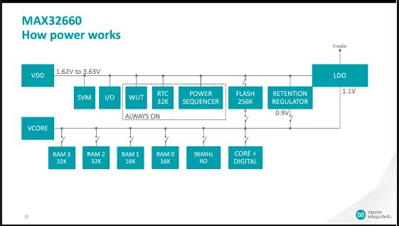

The MAX32660 has a set of power saving options. The obvious one is to lower the clock cycle. The lower the frequency, the less power the chip requires.
Another one is the supply voltage. The controller can be sourced from as low as 1.62 V up to 3.63 V. I've used 1.8 V and 3.3 V in this exercise.
And there are the configurable power modes and module-specific power save options.

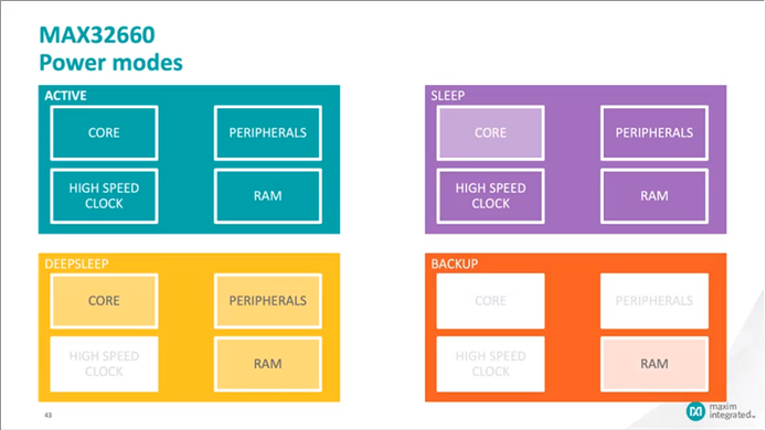

The MAX32660 has 4 power modes, all described in the user guide.
  • Active (tested in this blog in 3 different configurations: with unused RAM on, in light sleep and switched off)
  • Sleep
  • Deep Sleep
  • Backup
source: Webinar Recording: What Can You Do With the World’s Smallest ArmRegistered CortexRegistered M4 with FPU Microcontroller?
The user guide details the functionality, but if you have the time, check out the webinar. It reviews the modes and also touches low supply voltage vs frequency.

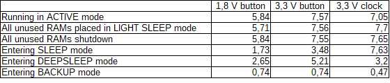

I've measured the current consumption for 1.8 and 3.3 V for each mode.

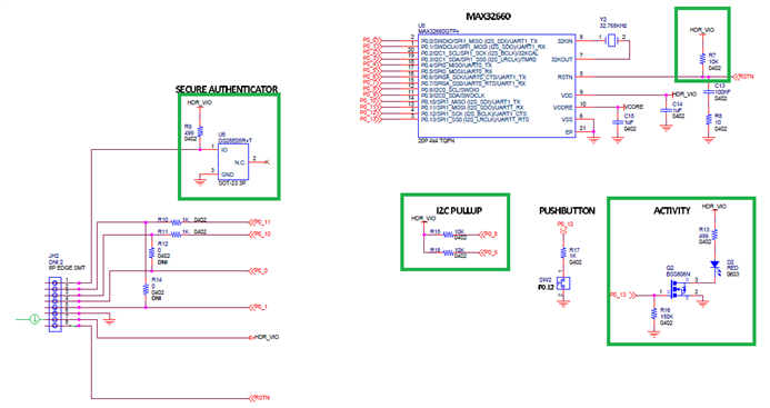

The current is for all components on the controller side of the EVM. That includes the pull-ups, quiescent current in the LED circuit and the EEPROM.
source: MAXIM EVK data sheet
Here are 3 measurements in mA, all with console off:

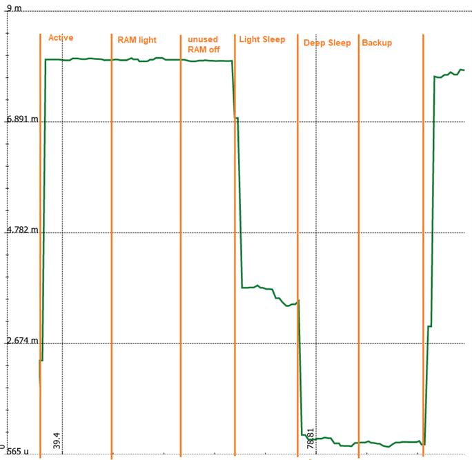

The capture below shows a 3.3 V cycle without UART, in clocked mode, 10 s per state.

    wsi over 7 years ago
    This is NOT Deep Sleep, as Deep Sleep is 4uA. This is sleep only.
    Jan Cumps over 7 years ago
    Measurement with Keithley6500
    1.8V, switch between power modes each second.
