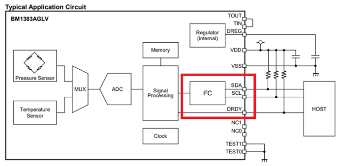

I selected the ROHM BM1383AGLV Pressure Sensor. I want to build a device that collects data at a slow pace. Accelerometers and other sensors from the ROHM kit are targetting real time use.
But the pressure sensor is a good candidate for slow, time based, data collection.
And it supports 1.8 V, the same as what I'm running the MAX32660 on. Plus it has a "data ready" trigger pin.

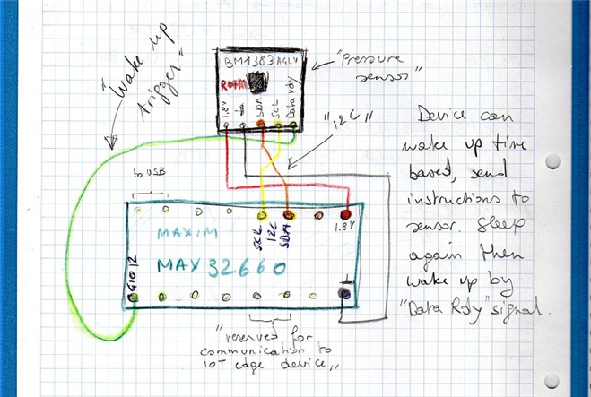

MAX32660 Pin Assignments:
I want to support a set of functions with as little interference to the MAX32660 evaluation board as possible.
The USB port of the EVK is linked to the contrllers's UART 1A. I should stay away from pins P0_10 and P0_11.
I want to keep the option open to use another UART to exchange data with an IOT edge device.
That - if it happens - is going to be UART 1B on P0_0 and P0_1.
Communication to the ROHM BM1383AGLV pressure sensor should go via I2C 0A, pins P0_8 and P0_9.
Maybe, if I can remove the crystal, I'll use a 2nd i2c as gateway to the edge device. i2c is more forgiving for jitter than UART.
Power Management:
I'd like to put the controller in an as deep as possible sleep between activation. A sleep mode I can recover from using the clocks.
During that time, I'd also like to deactivate the sensor's supply.
I'll have to check if I can source its power from a GIO pin.

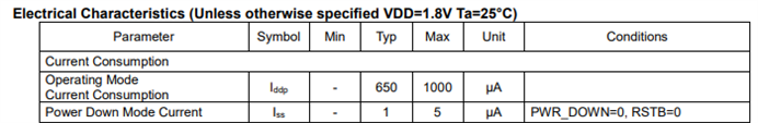

It seems to be possible. THe MAX32660 can source 1 mA - the absolute maximum current draw for the sensor.
After wake-up, I should send commands to the sensor, then sleep again until it reports that data is ready on it's DRDY pin.
