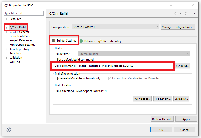

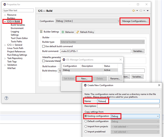

Create a Release Configuration in Eclipse
You can just copy the Debug configuration and change the makefile.
Then, in that Release configuration, modify the Build command to this:
make --makefile=Makefile_release ECLIPSE=1
You can now clean the project and build the Release configuration.
The flags related to debug will be skipped by the make script.
