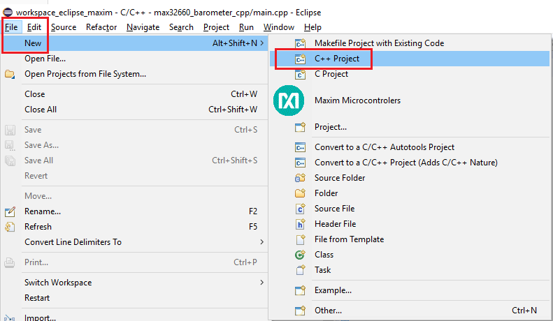

In this posts I show how to create a C++ project.
Maxim has a tutorial that explains how to create an Eclipse project from scratch. It is for the MAX3263X but works perfectly for the MAX32660.
When you follow the instructions, you get a brand new C project.
I would like to create an object oriented example, so I tried the procedure, with as only difference choosing a new C++ Project instead of C project.
There are a few fixes you have to do to make the build and debug system work with the C++ sources.
Differences
The MAXIM tutorial tells you to create a C project. Create a C++ Project instead:
Perform all other steps as indicated in the tutorial. For the debug configuration, it's easier to just copy one from another MAX32660 project and edit all project references.

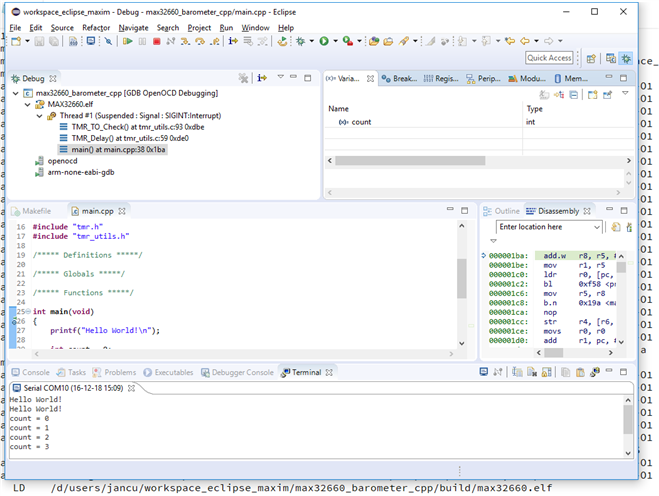

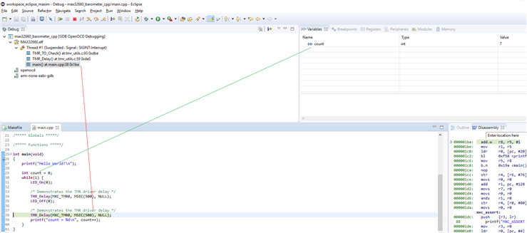

More subtle is that, when you try to debug the project, the debugger can't find the debug symbols and source file.
That's because in the MAXIM toolchain, there are a few inconsistencies between how C and C++ files are compiled.
The one that bites us, is that the C++ settings don't include debug symbols (-g3 -ggdb -DDEBUG).
It took me a while to find out why the debug info was not there for C++ files.
MAXIM uses a custom make file, so most settings in the Eclipse project are ignored and are defined in the make configuration.
I saw in the build console that the 3 switches were omitted for my .cpp file:
switches used for C++:

After doing that, everything works:
arm-none-eabi-g++ -mthumb -mcpu=cortex-m4 -mfloat-abi=hard -mfpu=fpv4-sp-d16 -Wa,-mimplicit-it=thumb -O1 -ffunction-sections -fdata-sections -MD -Wall -Wno-format -fno-rtti -fno-exceptions -std=c++11 -c -DTARGET=32660 -DTARGET_REV=0x4131 -DMXC_ASSERT_ENABLE -DRO_FREQ=80000000 -I. -ID:/Maxim/Firmware/MAX32660/Libraries/Boards/EvKit_V1/Include -ID:/Maxim/Firmware/MAX32660/Libraries/Boards/EvKit_V1/../Include -ID:/Maxim/Firmware/MAX32660/Libraries/MAX32660PeriphDriver/Include -ID:/Maxim/Firmware/MAX32660/Libraries/CMSIS/Device/Maxim/MAX32660/Include -ID:/Maxim/Firmware/MAX32660/Libraries/CMSIS/Include -g3 -ggdb -DDEBUG -o /d/users/jancu/workspace_eclipse_maxim/max32660_barometer_cpp/build/main.o main.cpp
The debug symbols are found and you can step through the code.
The binary - with debug symbols - is 10 K bigger than the C version. 568 K vs 558 K.
I haven't built a release version. I don't know how big the difference will be.
