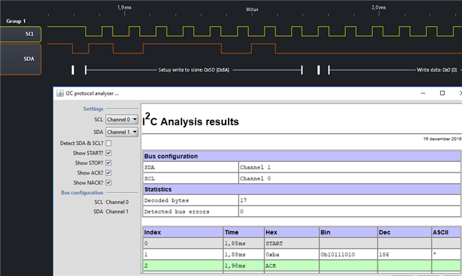

Here is the capture of the traffic during the init process:
I2C Analysis results
16 december 2018
Bus configuration
SDAChannel 1
SCLChannel 0
Statistics
Decoded bytes16
Detected bus errors0
IndexTimeHexBin
0-5,00 μsSTART
1500,00 ns0xba0b10111010
291,50 μsACK
396,00 μs0x100b00010000
4187,00 μsACK
5202,00 μsSTART
6207,00 μs0xbb0b10111011
72,72 msACK
82,72 ms0x320b00110010
92,81 msNACK
102,83 msSTOP
118,32 msSTART
128,32 ms0xba0b10111010
138,41 msACK
148,42 ms0x120b00010010
158,51 msACK
168,52 msSTOP
1710,86 msSTART
1810,87 ms0xba0b10111010
1910,96 msACK
2010,96 ms0x010b00000001
2111,06 msACK
2211,07 msSTOP
2314,90 msSTART
2414,90 ms0xba0b10111010
2514,99 msACK
2615,00 ms0x130b00010011
2715,09 msACK
2815,11 msSTOP
2917,45 msSTART
3017,45 ms0xba0b10111010
3117,54 msACK
3217,55 ms0x010b00000001
3317,64 msACK
3417,65 msSTOP
3519,99 msSTART
3620,00 ms0xba0b10111010
3720,09 msACK
3820,09 ms0x140b00010100
3920,19 msACK
4020,20 msSTOP
4122,54 msSTART
4222,55 ms0xba0b10111010
4322,64 msACK
4422,64 ms0xca0b11001010
4522,73 msACK
4622,75 msSTOP

    Jan Cumps over 7 years ago in reply to Jan Cumps
    That's better:
    I had to update the i2c write function.
    No success yet:
    The sensor returns no data. Investigating ...
    It has to be my code, because the Arduino sketch works.
    For later reference, capture of the Arduino sketch:
    edit: oops - definitely forgot to port something here ...
