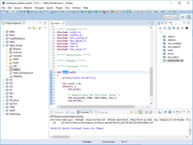

That installs (I tested the Windows version) Eclipse, the GDB OpenOCD debug plug-in (what a great open source development !!),
USB driver, compiler chain (with MiniGW supporting the build).
And it installs firmware libs, example projects and documentations for our microcontroller.
Once installed, everything works out of the box - just execute eclipse.bat, not eclipse.exe.
The install is so kind to not put any of the modules in your standard path (thank you Maxim !!) .
The batch file takes care that the environment (e.g. MiniGW) is configured before Eclipse starts.
(it would be good if Maxim documented that in the Eclipse Quick Start guide - it prevents compilation errors).
The overall experience is perfect. Installation works as it should.
After importing the first two examples - one bare metal, one with FreeRTOS - they both compiled without errors and warnings.

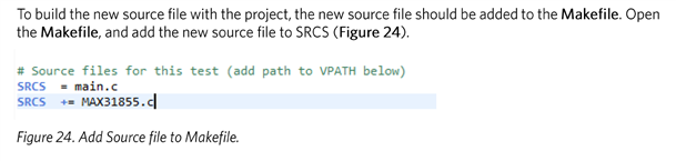

A little gripe: when you add new source files or folders to the project, you have to edit the Makefile.
This is not Eclipse-like. You are expected to just add sources and source folders and everything works automatically. You can use the exclude option to  not add files to a build.
Other manufacturers that have an Eclipse flavour comply with that natural Eclipse use.
It's not a big deal but it's a hurdle.
It makes the learning ramp unnecessary steeper if you haven't stumbled on this comment (written for another device, not available from the MAX32660 homepage).

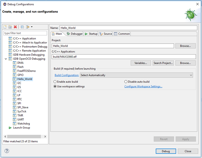

edit: I have now received the device and the first debug session worked perfect too. See the comments below.
