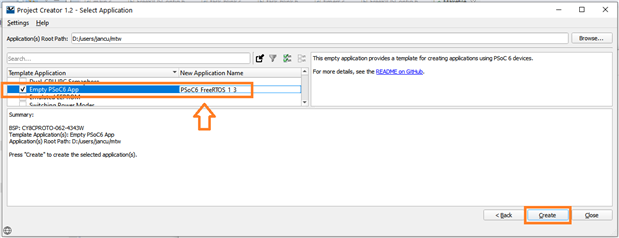

Start an empty project
File > New > ModusToolbox Application
Select the PSoC empty project for your board:
I use the WiFi BT prototyping kit, so I selected that one. Press Next.
Look up and select the empty project. Rename it (I used PSoC6_FreeRTOS_10_3). Press Create.
Once the wizard generated the project, press Close and return to the IDE.

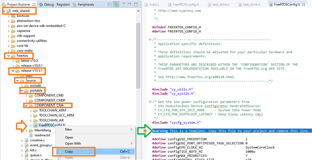

Add FreeRTOS 10.3
With the project active, select the Library Manager in the Quick Panel.
On the Libraries tab, select freertos, shared, and version 10.3.1 release (or the version you want to use).
Click Update, then Close when finished. Return to the IDE.
Then, add a FreeRTOSConfig.h file to your project. You do that by copying the one from the shared FreeRTOS area into your project:
Paste this in the root of your project.
Then open that copied file, and remove the "#warning This is a template. Copy this file to your project and remove this line" line.
As last step in the preparation, add this to the include section of your main.c file:
#include "FreeRTOS.h"
