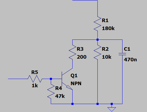

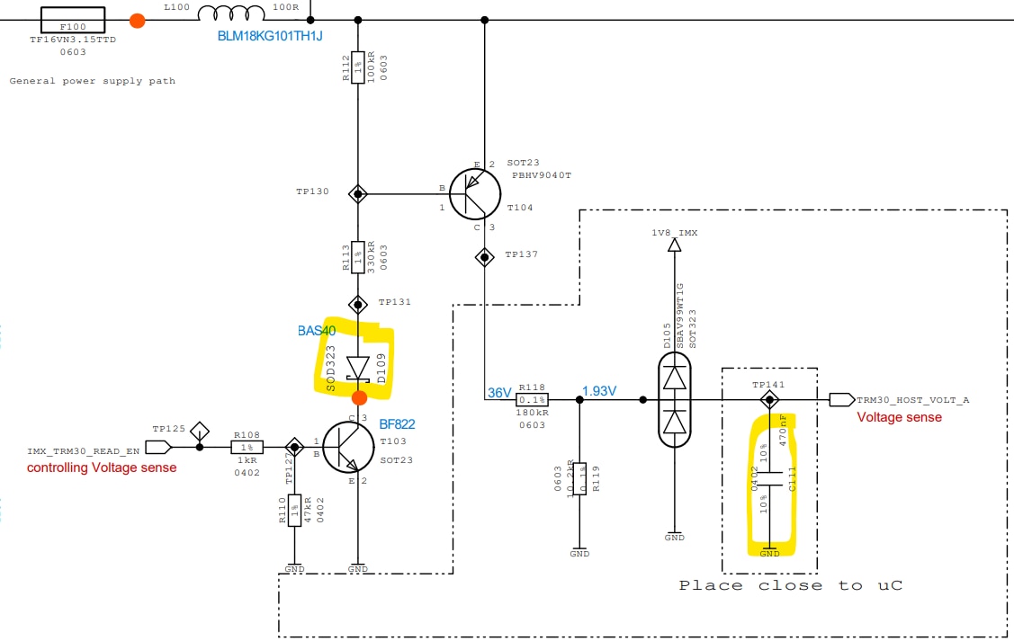

Why is the Schottky diode being used in control circuit?
Humaninsane
Humaninsane 7 months ago
imageWhy is the Schottky diode being used in control circuit? and why is the 470nF cap is added at that voltage divider output? how is the Cap value 470nF calculated?
  • michaelkellett
    michaelkellett 7 months ago in reply to Humaninsane +3 suggested
    I think I can see what the ciruit is attempting: T103 switches T104 on and T104 connects R108 to the supply rail. R108 and R119 attenuate the signal by a factor of (180 + 10.2)/10.2. C111 makes a…

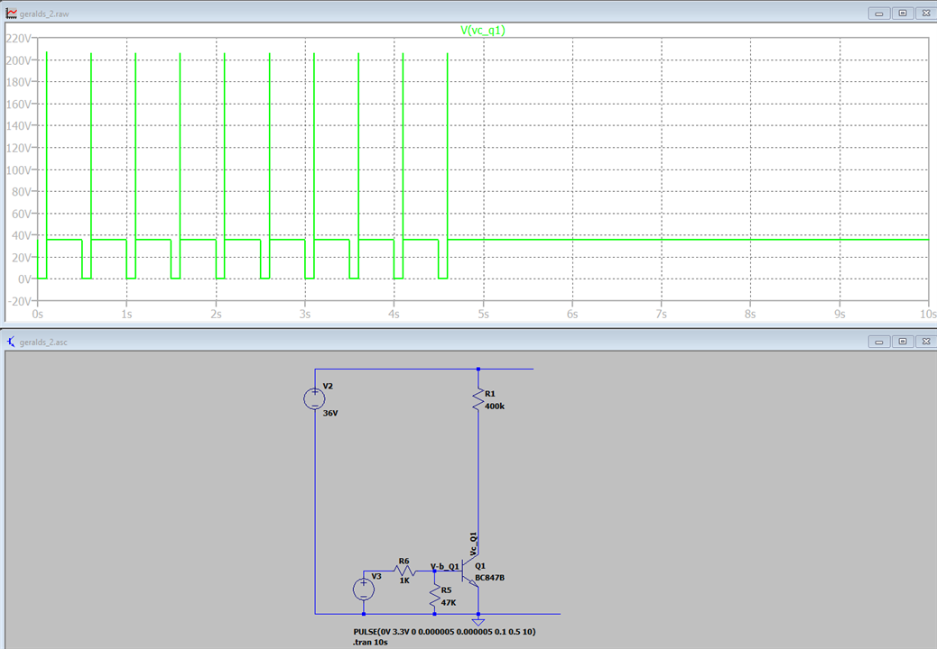

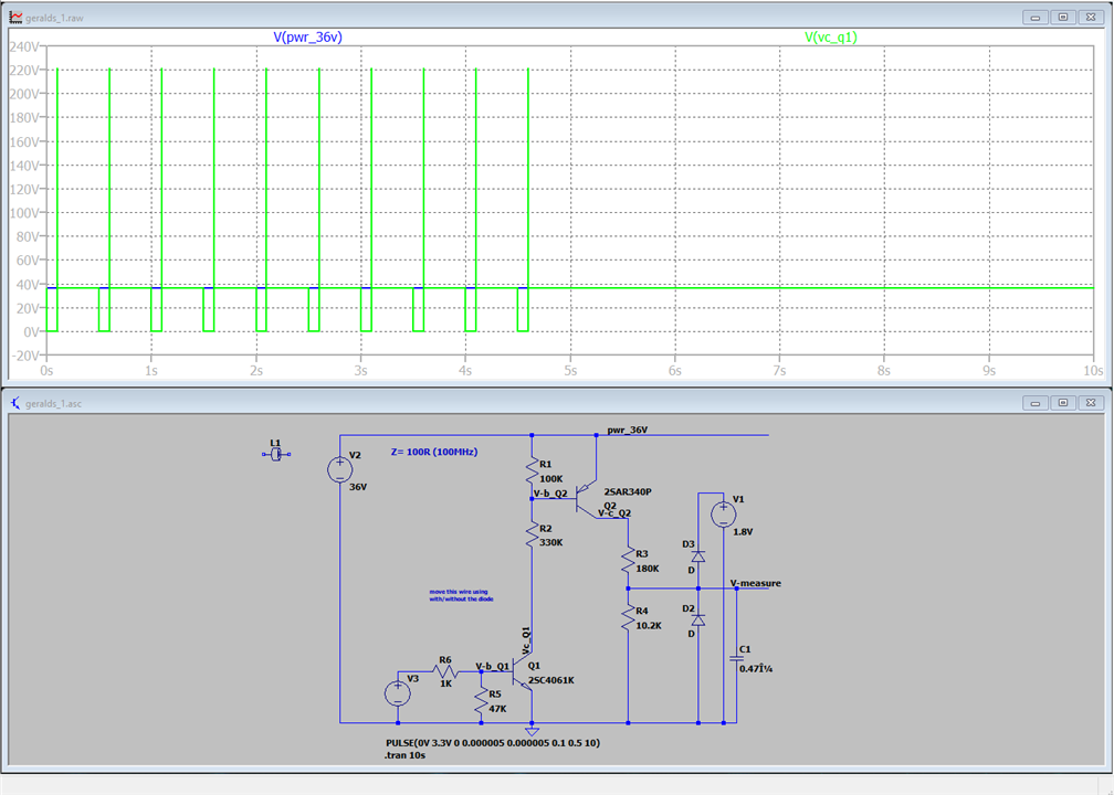

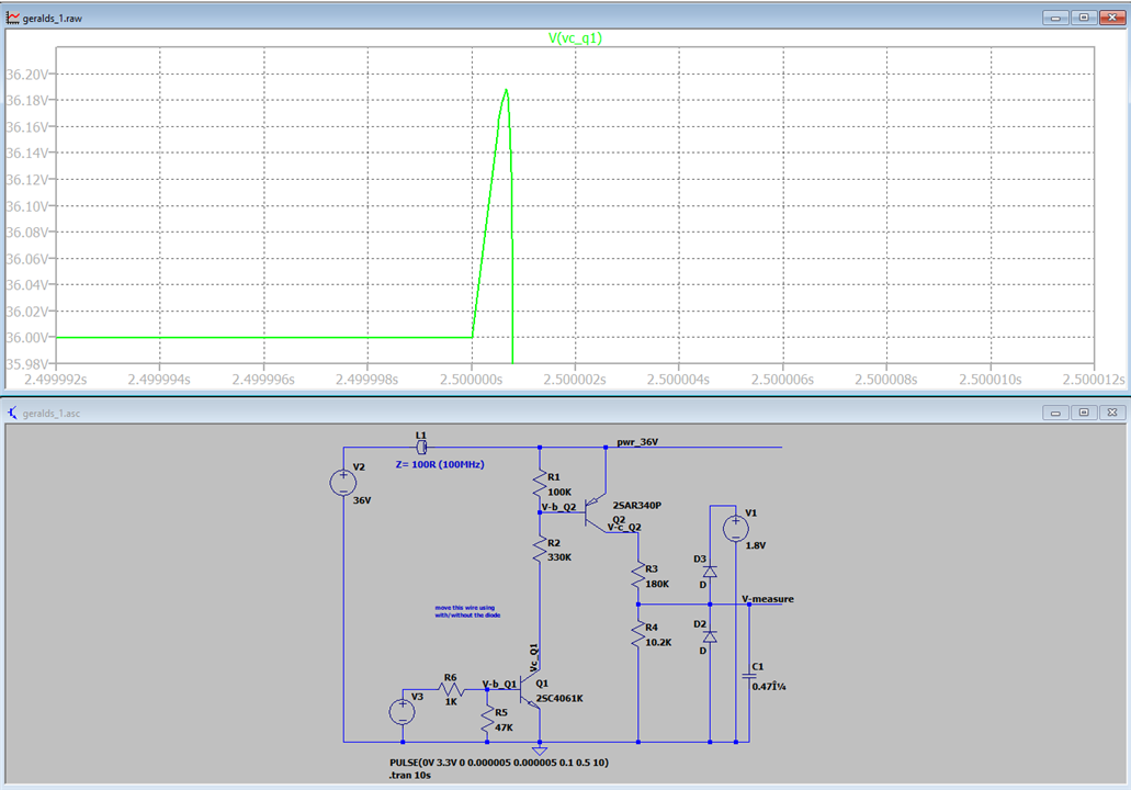

    Hi simulation with Schottky diode: simulation without Schottky diode: The Schottky diode is important during switching off the transistors. Without Schottky it can produce very high…

    geralds 7 months ago in reply to Humaninsane +1
    Hi, I would say that the T103 is a simple switching transistor in a higher voltage-rated circuit. A BC846 would be too small at 60V. The microcontroller's output switches it on to measure the voltage…
  • michaelkellett
    0 michaelkellett 7 months ago
    I would need to know more about the function of the circuit to make an informed comment.
    The two transistors are high voltage parts (250V and 500V).
    What are the inductor connections and what is the working voltage on emitter of T104 ?
    D108 is only rated for 40V reverse voltage.
    I suspect that the diode is to protect T103 from negative voltages at TP131 - but without more information its only a guess.
    MK
  • Humaninsane
    0 Humaninsane 7 months ago in reply to michaelkellett
    The two transistors are high voltage parts (250V and 500V)- fuse & inductor path is max60V from Lead-acid battery. This a random selection. 100V part cab used.
    What are the inductor connections and what is the working voltage on emitter of T104 ? -  ferrite bead used for High Impedance at high frequency (EMI/EMC)
    D108 is only rated for 40V reverse voltage. - D109, after 100k and 300k, 60V will drop...so they have used 40V schottky
    I suspect that the diode is to protect T103 from negative voltages at TP131 - do we get -ve voltage in between?not sure, I thought it's only at product out (Connector/GND...).

    Hello Gerald,
    I have replicated your model quite closely in LTSpice and it shows no sign of the huge spikes.

  • geralds
    0 geralds 7 months ago in reply to michaelkellett
    original ferrite bead in the original circuit, Murata BLM18KG101TH1D:
    murata ferrite bead
    I've selected the Würth ferrite bead 74276051:
    simulated ferrite bead - 74276051
    Well, may be your simulation have other setting in the software.
    I just installed the software and worked with default settings, in the simulation settings.
    Just drag and drop, I selected components that have "real" parameters, I did not use ideal components.
    In the fused wire draws < 3A at 36V, not mA. This is the power rail.
    The measurement circuit is just a small part of a bigger circuit.
    You can ask the developers who inserted the Schottky.

    But - no overshoots:

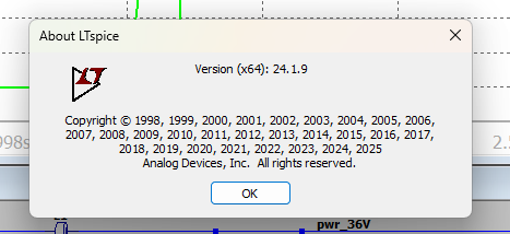

    Same overshoot result if I press reset to defaults and run again.
    Updated to latest version.
    And huge overshoot on Q1 collector is visible.
    No picture of it here - see Geralds plots above.

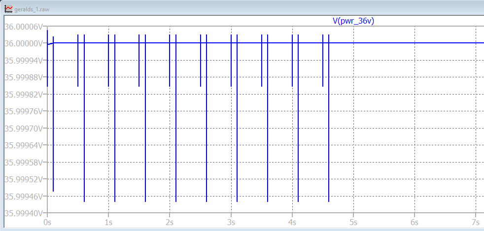

    But we know this is false because there is no big overshoot on the 36V power rail:

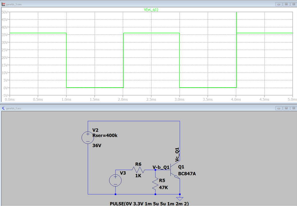

    Let's remove the inductor:
    Now we have a design with NO INDUCTANCE but we still get the 200V spike.
    Analog seem to have broken LTSpice.
    let's prove that:
    There you are - no inductance and we get the nonsense spike.
    This is so disappointing - LTSpice has been great for ages and now they have broken it.
    The spike varies if you change the transistor model to npn2 or the type of device but it doesn't go away.
    So let's find out what's wrong,
    ........................ several abortive tests I won't bore you with.

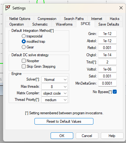

    Here is a clue - only one rising edge is spikey, and less than they were, but all I've done is change the quiet intervals between edges.
    Lets make a wild guess and set the minimum time step to 1us (its at the default setting of whatever it decides right now)
    Suddenly it looks sensible.
    And if the min time step is set then Gerald's original model works OK as well.
    So all they have changed/broken is how the auto time step works - I preferred the older version.
