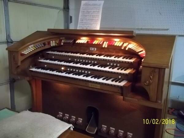

Here’s my Trio: it has three full-size 61-key manuals and a 32-note pedalboard (not shown).  The pedals are actually a bit narrower than the AGO (American Guild of Organists) standard, but they work OK for me.  The narrower pedals allow the Trio to be smaller than a full-size console which made it possible to move it down my basement stairs.
This is an early picture when the Trio was in the garage, before I replaced some burnt-out light bulbs.
The Trio is an analog instrument mostly built from discrete resistors, capacitors, diodes, and transistors.  They’re mostly standard through-hole components that are still available.  So if something goes wrong, you can get in there and diagnose what’s going on with an oscilloscope, and replace individual components.  There are some ICs, but most are standard operational amplifiers and CMOS logic ICs.  There are a few standard and one custom IC that are no longer available, but the organ works well now and the parts most likely to fail are replaceable.
My long-term goal is to add “virtual pipe organ” (VPO) capability.  Modern organs use samples of actual pipe organs and play those samples back to produce the sound of a real pipe organ.  You can fairly easily wire up an old organ’s keyboard contacts to a microcontroller and use it to produce a MIDI data stream.  You then use the MIDI stream to drive a music synthesizer, which may be a general-purpose PC.  I’m planning on using a Raspberry Pi 2 model B for this purpose some day.
In the meantime, I really like the sound of the Trio as is.  It was a little out of tune when I got it, which is not surprising.  I tolerated it for a while: being a little out-of-tune is actually better for some theatre music.  But Bach wasn’t happy and once you notice something’s wrong it becomes increasingly obvious.  So I needed to tune the Trio.

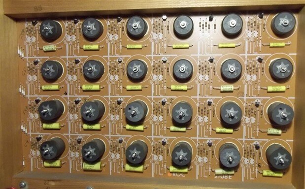

The Trio does it differently: it has an oscillator for each note.  In fact, it has two oscillators for most notes: a sine wave oscillator for producing Tibia (flute) sounds and a square wave “main” oscillator for producing everything else (reeds, strings, diapason, piano, chimes).   There are 73 square wave oscillators (6 octaves plus one extra C).  These cover the 5-octave manuals (61 notes) plus an extra octave of bass notes for the pedal board.  There are 85 sine wave oscillators (7 octaves plus an extra C).  The extra octaves are for “4 foot” and “2 foot” stops that add higher Tibia octaves to the note you are playing.
You need to tune each of these 158 oscillators individually by taking off the back of the Trio so you can get at the circuit boards, which are mounted on two huge wooden frames.  Each oscillator has a fixed capacitor and a variable inductor to set the frequency.  Here are some oscillators:
The inductors are the large gray cylinders.  The top part of each inductor can be turned clockwise or counter-clockwise to adjust the frequency.

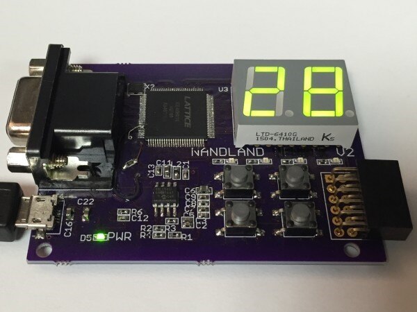

My design uses a Nandland Go Board which has a Lattice iCE40 HX1K FPGA.  The Go Board has a 2-digit 7-segment display which display the current note being tuned, buttons to select the current note, a VGA output connector which I use to output a sine and square wave, and a Pmod connector to input a Trio oscillator signal.
Basically, my tuner accurately synthesizes a note from the Go Board’s 25 MHz oscillator and compares it to a Trio’s oscillator output, displaying the frequency difference using the Go Board’s row of 4 LEDs.  Alternatively, you can use an oscilloscope to compare the two notes.  I’ll describe this in more detail later.

The Go Board has a 2-digit non-multiplexed 7-segment display.  The second digit is the octave number 0-8.  Here’s my GCHD module for converting a 4-bit BCD digit into a 7-segment code.  By convention, the segments are named A-G which have nothing to do with notes A-G.

I output the sine wave over the Go Board’s VGA green output signal, which combines 3 bits using resistors to make a rudimentary digital-to-analog converter.  I only use values 1-7 because I use a simple NPN transistor amplifier to drive a small speaker.  I need 0.65 volts to turn on the NPN amplifier.  Sine value 2 is the lowest value that turns on the NPN transistor: neither 0 nor 1 produces a high enough voltage to turn on the transistor, so they’re equivalent as far as the speaker is concerned.  Using 0-7 would produce a distorted sine wave.  Values 1-7 produce a nice symmetric wave.
