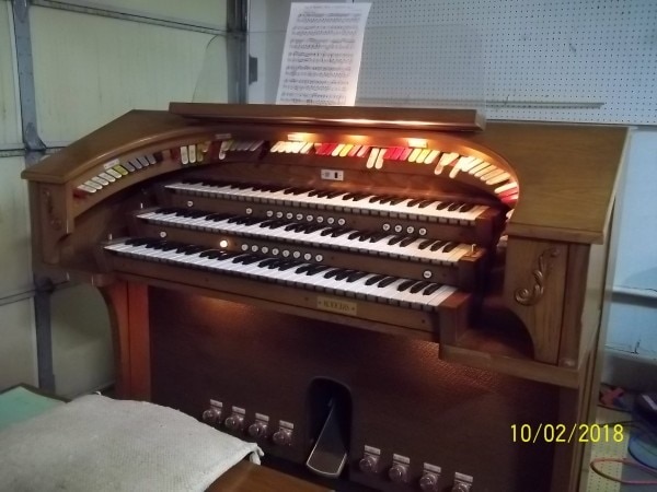

Here’s my Trio: it has three full-size 61-key manuals and a 32-note pedalboard (not shown).  The pedals are actually a bit narrower than the AGO (American Guild of Organists) standard, but they work OK for me.  The narrower pedals allow the Trio to be smaller than a full-size console which made it possible to move it down my basement stairs.
This is an early picture when the Trio was in the garage, before I replaced some burnt-out light bulbs.
The Trio is an analog instrument mostly built from discrete resistors, capacitors, diodes, and transistors.  They’re mostly standard through-hole components that are still available.  So if something goes wrong, you can get in there and diagnose what’s going on with an oscilloscope, and replace individual components.  There are some ICs, but most are standard operational amplifiers and CMOS logic ICs.  There are a few standard and one custom IC that are no longer available, but the organ works well now and the parts most likely to fail are replaceable.
My long-term goal is to add “virtual pipe organ” (VPO) capability.  Modern organs use samples of actual pipe organs and play those samples back to produce the sound of a real pipe organ.  You can fairly easily wire up an old organ’s keyboard contacts to a microcontroller and use it to produce a MIDI data stream.  You then use the MIDI stream to drive a music synthesizer, which may be a general-purpose PC.  I’m planning on using a Raspberry Pi 2 model B for this purpose some day.
In the meantime, I really like the sound of the Trio as is.  It was a little out of tune when I got it, which is not surprising.  I tolerated it for a while: being a little out-of-tune is actually better for some theatre music.  But Bach wasn’t happy and once you notice something’s wrong it becomes increasingly obvious.  So I needed to tune the Trio.

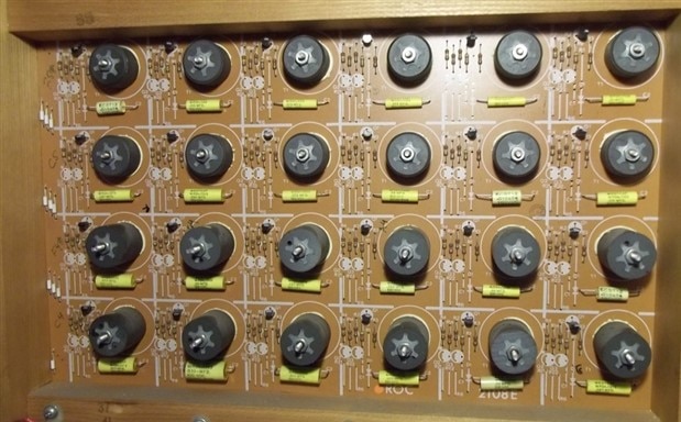

The Trio does it differently: it has an oscillator for each note.  In fact, it has two oscillators for most notes: a sine wave oscillator for producing Tibia (flute) sounds and a square wave “main” oscillator for producing everything else (reeds, strings, diapason, piano, chimes).   There are 73 square wave oscillators (6 octaves plus one extra C).  These cover the 5-octave manuals (61 notes) plus an extra octave of bass notes for the pedal board.  There are 85 sine wave oscillators (7 octaves plus an extra C).  The extra octaves are for “4 foot” and “2 foot” stops that add higher Tibia octaves to the note you are playing.
You need to tune each of these 158 oscillators individually by taking off the back of the Trio so you can get at the circuit boards, which are mounted on two huge wooden frames.  Each oscillator has a fixed capacitor and a variable inductor to set the frequency.  Here are some oscillators:
The inductors are the large gray cylinders.  The top part of each inductor can be turned clockwise or counter-clockwise to adjust the frequency.

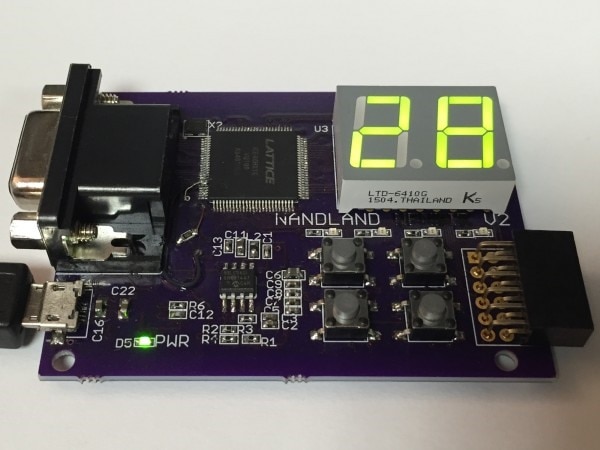

My design uses a Nandland Go Board which has a Lattice iCE40 HX1K FPGA.  The Go Board has a 2-digit 7-segment display which display the current note being tuned, buttons to select the current note, a VGA output connector which I use to output a sine and square wave, and a Pmod connector to input a Trio oscillator signal.
Basically, my tuner accurately synthesizes a note from the Go Board’s 25 MHz oscillator and compares it to a Trio’s oscillator output, displaying the frequency difference using the Go Board’s row of 4 LEDs.  Alternatively, you can use an oscilloscope to compare the two notes.  I’ll describe this in more detail later.

    net PI(16);                 // 16-bit top-octave phase increment.
    reg PA(27);                 // 27-bit phase accumulator.
    PI = TopOctave(n);
    if clk rises then PA = PA + PI;
Why 27 bits?  Well, as described earlier the top-octave DDS uses a 20-bit PA: the 16-bit PI is actually divided by 16.  The top octave is octave 7.  To get octaves 0-6 we simply extend PA to 27 bits, and select one or more bits from PA for octave v.  Octave 8 is special and I’ll get to it in a moment.
Here is the logic that selects the PA bits for octave v:
    reg sel(4);         // Octave v selects 4 MSbs of phase accumulator.
    if clk rises then sel =
        v == 0? PA[26:23]: v == 1? PA[25:22]: v == 2? PA[24:21]:
        v == 3? PA[23:20]: v == 4? PA[22:19]: v == 5? PA[21:18]:
        v == 6? PA[20:17]: v == 7? PA[19:16]: PA[18:15];
It actually selects 4 adjacent PA bits, which we use to produce a rudimentary sine wave.  If v = 7, we select the top bits of the top octave, which are PA[19:16], i.e., the top 4 bits of a 20-bit PA.  If v = 6, we go down an octave and select PA[20:17], cutting the synthesized frequency in half.  Each lower octave cuts the frequency in half again.  Octave 0 selects PA[26:23], which is 1/128th the frequency of octave 7.
Octave 8 selects PA[18:15], which is twice the frequency of octave 7.  This works, but produces a signal with a more phase jitter.  However, the Trio only goes up to C8 which has the least jitter in octave 8.
Now that we have selected the top 4 bits for octave v, we can generate a square wave and a sine wave.  The square wave is simply the MSb of sel:
    output square = sel[3];         // Square wave output.
    output sin(3);                  // 3-bit sine wave output.
    sin = Sine(sel);
For the sine wave I use a small look-up table:
output Y(3),
module {Y = Sine(X)} =
    Y = X == 0?  4: X == 1?  5: X == 2?  6: X == 3?  7:
        X == 4?  7: X == 5?  7: X == 6?  6: X == 7?  5:
        X == 8?  4: X == 9?  3: X == 10? 2: X == 11? 1:
        X == 12? 1: X == 13? 1: X == 14? 2: 3;
I output the sine wave over the Go Board’s VGA green output signal, which combines 3 bits using resistors to make a rudimentary digital-to-analog converter.  I only use values 1-7 because I use a simple NPN transistor amplifier to drive a small speaker.  I need 0.65 volts to turn on the NPN amplifier.  Sine value 2 is the lowest value that turns on the NPN transistor: neither 0 nor 1 produces a high enough voltage to turn on the transistor, so they’re equivalent as far as the speaker is concerned.  Using 0-7 would produce a distorted sine wave.  Values 1-7 produce a nice symmetric wave.
Tuning Using an Oscilloscope
The tuner is now able to produce an accurate sine or square wave across the organ’s entire pitch range, with the note and octave selected by the Go Board’s push-buttons and displayed in the 7-segment LEDs.  If you have an oscilloscope handy, you can now do the tuning.
To tune using a dual-trace ’scope, connect the lower trace to the tuner’s square wave output and trigger off it.  You should get a nice clean, stable square wave which changes frequency as you select different notes and octaves.
Connect the upper trace to one of the organ’s oscillators.  The ’scope probe should be high enough impedance that its presence doesn’t affect the oscillator frequency.  The upper trace of the ’scope should have a nice square or sine wave, depending on the oscillator.
If the organ’s oscillator is exactly the same frequency as the selected note and octave the upper trace will be stationary.  If it’s not the same frequency the upper trace will travel to the left or right at a speed determined by the mismatch.  If the organ’s oscillator is sharp, the trace will travel left.  If flat, it will travel right.
On the Trio, you can now turn the inductor clockwise or counter-clockwise to adjust the oscillator frequency until it matches the tuner’s square wave.  Do this for all 158 Trio oscillators and you’re done image
You can also do this with a single-trace ’scope if it has an external trigger input.  You simply connect the tuner square wave output to that external trigger and use the single trace for the organ’s oscillator output.  As with the dual-trace ’scope, the trace travels left if the oscillator is sharp and right if the oscillator is flat.
Tuning Using the Difference Display
The tuner also has a built-in display that shows the difference in frequency between the selected reference pitch and an organ oscillator output which is connected to an FPGA input.  The difference display uses the Go Board’s four discrete LEDs below the 7-segment display.  If the organ oscillator is sharp, the LEDs travel to the right telling you to turn the inductor clockwise.  If the organ oscillator is flat, the LEDs travel left telling you to turn the inductor counter-clockwise.  If the oscillator is tuned perfectly, you will see a single LED or a pair of adjacent LEDs turned on.  If the tuning is close, that single LED moves slowly to the left or right, turning on two adjacent LEDs as it moves from one position to another.
This sort of moving LED display is common with electronic tuners.  It’s actually based on the old electro-mechanical stroboscopic tuners that have 12 spinning disks with binary patterns on them.  Each wheel spins at a rotational speed that matches one of the 12 notes.  An audio input causes a strobe light to flash.  If it matches one of the 12 pitches, the disk appears to stop.  If the audio input is near a pitch, one of the wheels appears to turn slowly clockwise or counter-clockwise -- the rate depends on how sharp or flat the input is.
The FPGA logic for my tuner is in the main program.  First, we sample input x from the organ using clk and use three flip-flops to prevent metastability and to filter x using a majority filter:
    // Input signal and 4-bit difference counter are clocked at 128.205 KHz.
    input x;
    reg {x1, x2, x3, xprev};    // Synchronization flip-flops and majority filtering.
    net xmaj = x1 & x2 | x2 & x3 | x1 & x3;
    if clk rises then {x1 = x; x2 = x1; x3 = x2; xprev = xmaj};
    net dx = xmaj != xprev;     // Filtered x changed.
Signal dx indicates that filtered x has changed from the previous clk cycle, which occurs twice per input cycle.  We also have signal dr which indicates that the reference square wave has changed from the previous clk:
    reg prev;                       // Previous value of reference signal square.
    if clk rises then prev = square;
    net dr = square != prev;        // Reference signal changed.
Our basic approach is to have a 2-bit display register disp which increments when dx occurs and decrements when dr occurs.  disp is unchanged if neither occurs or both occur simultaneously.
disp turns on one of the four LEDs.  If dx and dr have the same frequency, disp alternates between two values and only two adjacent LEDs will light.  (The tuner considers the left-most and right-most LEDs to be adjacent.)  If dx and dr are close, disp will slowly change to lower or higher values and you’ll see the LEDs move left or right.
If dx and dr are far apart, disp will change so quickly that all the LEDs will appear to be lit and you won’t be able to tell whether the oscillator is sharp or flat.
To fix this, we limit the speed that disp can change by only updating it every 16th of a second.  You need four of these updates to move the LED four positions, so the LED display cycles at a maximum rate of 4 Hz.  This is slow enough to see which way the LED is moving.
The tuner has a 4-bit register diff that records the difference between dx and dr over 1/16 second.  The logic is in the main program:
    reg diff(4);                    // 4-bit difference counter, cleared every 1/16 sec.
    if clk rises then diff =        // Saturates at +7 and -8.
        Hz16? (dx & ~dr? +1: ~dx & dr? -1: 0):
        diff + (dx & ~dr & diff != 7? +1: ~dx & dr & diff != 8? -1: 0);
Every clk cycle diff is updated to a new value.  If Hz16 = 1, we have reached the end of a 1/16 sec interval and we “clear” diff by setting it to +1 if dx = 1 and dr = 0, -1 if dr = 1 and dx = 0, and to 0 in all other cases.
If Hz16 is 0, we increment diff if dx = 1 and dr = 0 and decrement diff if dr = 1 and dx = 0.  We do not increment past 7 or decrement below 8.  diff is a 2’s complement number, so 8-15 are negative values.  In all other cases diff keeps its current value.  This includes clk cycles when dx and dr occur simultaneously.
At the end of each 1/16 interval, diff is positive if there have been more dx than dr.  diff is negative (MSb is set) if there have been more dr than dx.  diff is 0 if there have been the same number of dx and dr over the interval.
Here’s the logic that updates the display register disp described earlier:
    reg disp(2);                    // 2-bit display counter.
    if clk rises then
    if Hz16 then disp = disp + (diff == 0? 0: !diff[3]? +1: -1);
disp is updated every 1/16 second, i.e., when the Hz16 pulses high.  If diff = 0, disp keeps its current value.  Otherwise disp increments or decrements based on the sign bit of diff.  Note that all registers update simultaneously when clk rises, so we update disp using the current value of diff and simultaneously “clear” diff as described earlier.
All that’s left is to turn on one of LED1 through LED4, based on the current value of disp:
    output {LED1 = disp == 0, LED2 = disp == 1,
            LED3 = disp == 2, LED4 = disp == 3};
If you’d rather have the LEDs move in the opposite direction, replace this code with:
    output {LED1 = disp == 3, LED2 = disp == 2,
            LED3 = disp == 1, LED4 = disp == 0};
Analog Input Circuitry
The FPGA’s oscillator input x needs to be a square wave between 0 and 3.3V.  Since each organ is different, I won’t show the circuits I use, but I’ll describe them in general terms.  The Trio’s square wave oscillators vary between about 1V and 10 V, so obviously I cannot connect one directly to an FPGA input.  Plus, the drive is asymetric: the oscillator pulls down through a transistor and pulls up through a large resistor.  I made a small adapter circuit using a PNP transistor amplifier pulled up to 3.3V.  It worked quite well except for one thing: my pull-up was a little too strong and the circuit affected the oscillator frequency.  I should have used a comparator IC with a high input impedance.  I ended up re-tuning with an oscilloscope, which worked fine.
The Trio’s sine wave oscillators are very analog and I didn’t want to connect any circuits to them.  Instead, there’s a nice op amp on the Tibia preamplifier board with a nice low-impedance output.  Unfortunately, it’s a pretty low amplitide signal that’s between +0.25V and -0.25V.  I ended up using my PNP amplifier with some diodes and a trim pot to set the bias.  This amplified the 500 mV sine wave into a nice +3V square wave.
Another difference between the Trio sine and square wave oscillators is that the square wave oscillators operate all the time, whereas the since wave oscillators only operate when a key is pressed.  I used a jumper and a resistor to mimic pressing a key to turn on each oscillator.  Some of the notes didn’t have a good place to connect the jumper, so for those I had to go around to the front of the Trio and press a key, using a toothpick to wedge it on.
Results
I’m quite happy with the way the Trio tuned up.  I think it’s as good as can be expected since it’s tricky to adjust those inductors, and with equal temperament you’re always somewhat out of tune.
I’m also quite happy with my FPGA software.  This was by far the most complex FPGA design I’ve done using XXICC.  I only found one bug, which was trivial and easily patched.  GCHD synthesis could be better and I plan to work on that in the future.
