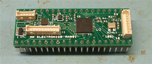

Those of you with long memories will remember the first blog about this board:
Ultra cheap and Tiny FPGA Board
I've built up a couple of boards and got them running some very simple start up software and VHDL.
The good news is that there are only two small bugs on the board, neither is too grim to fix.
Other E14 members (notably Jan Cumps ) have been Roadtesting the MAX32660 which provides one half of the good stuff on this board.
My approach to coding the processor is very different so I've hit a different stream of snags and I'll talk a little about one of them and it solution.
But first the building !
The MAX32660 variant I used comes in a 0.4mm pitch QFN package which is too tricky for pure hand soldering. I used a bought in metal stencil for solder paste printing, hand placed the parts using microscope and tweezers and re-flowed in a CIF drawer type re-flow oven.
The results were quite good, no shorts on either the 0.4mm pitch or 0.5mm pitch QFNs. It's not quite a home process, the screen printer and the oven are a bit pricey for unpaid work - cheaper Chinese alternatives exist.
PCB with solder paste
PCB with components before re-flow
PCB after re-flow and hand soldered parts fitted
Debugging on Veroboard breakout board with ARM Ulink and logic analyser attached
PCB Bugs - C10 fouls J2 and wire link on U3
Test Code
The test code on the FPGA just sets up the PLL to turn the 25MHz clock signal from the oscillator chip into a 50MHz signal output on one pin.
The C code on the MAX32660 sets up some IO pins and uses SPI to load the FPGA withe its 100k byte bit pattern. I used bit banged SPI which saves me the trouble of getting the MAX32660 SPI hardware going (I'll do that later.)

The problem is GPIO_OutSet() which is a full on function call, if we replace the calss to the official functions with
gpio->out_set = (1u << 4);
gpio->out_clr = (1u << 4);
the toggle rate gets up to a more respectable 7.97Mhz.
gpio is the single gpio port and is defined in one of the Maxim header files which is how I know about the out_set and out_clr registers, which are NOT documented in the chip's User Manual.

I'm thinking I'll make a breakout board next - any suggestions as to what to put on it are welcome - I want something simple that you can't easily do without the FPGA.

  • michaelkellett
    michaelkellett over 7 years ago in reply to jc2048 +4
    It's really not the right FPGA for ethernet, a reasonable MAC would use up half the FPGA, the low speed would make an RMII difficult. The processor could manage but would still need to pump all the Ethernet…
  • michaelkellett
    The processor could manage but would still need to pump all the Ethernet traffic through SPI.
    This is the kind of FPGA you might use to glue a few audio chips together and maybe do some simple signal processing.
    If I don't get any better ideas I might add the parts needed to make a TEC controller  - I've used a very expensive chip from LT in the past and it might be useful to make a digital replacement.
    There are enough pins to support that and the codec, which might form the basis of a very cool audio device image
    MK
  • jc2048
    jc2048 over 7 years ago in reply to michaelkellett
    A CODEC sounds good to me.
    Perhaps an interface so that it could be a standalone music module? MIDI (in, out, and through) would be simplest. Ethernet if you like a challenge.
  • michaelkellett
    michaelkellett over 7 years ago in reply to shabaz
    Hmmm, that seems to work fine - I just put it in the MAX32660 code.
    I wonder if I missed something when I transferred it from the original target.
    Any way - I owe you a board but I'll probably make you wait until I've done the breakout board, which so far will have a cheap stereo codec on it.
    But it's not too late to suggest additional goodies.
    Thanks.
    MK
  • michaelkellett
    michaelkellett over 7 years ago in reply to Jan Cumps
    I'm thinking of an AD SSM2604, 24 bit, up to 96k sampling rate dual ADC/DAC with I2S audio and I2C control interfaces.
    It will need a 12.288 or 24.576 MHz oscillator for standard high quality audio sampling rates.
    Farnell part number 2457480, about £2 each.
    The FPGA is not well endowed with multipliers so it may be better to attempt DSP on the MAX32660, but it depends on what you want to do.
    The SPI link should be able to manage 25MHz clock rates for maximum of about 3Mbytes/s in each direction, the audio data, even at 32 bits per sample won't exceed 768kbytes/s so should be no problem.
    I'll still have  a lot of FPGA pins spare so I'll need to add something else !
    MK
