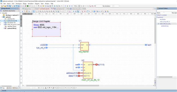

Having got the LED flasher Verilog demo translated to VHDL I've added a chunk of RAM to the design. It doesn't have anything to do right now so to stop the tools  optimising it away
I've connected it to pins. (Which takes me to another big virtue of the QMTech board, it has about 100 IO pins available on its headers.)
This a block diagram of the project. It's done in Aldec-HDL. It's a complete VHDL/Verilog simulator (and more). The block diagram automatically makes all that boring VHDL or Verilog
that links blocks together. The actual code is inside the blocks. I find it helps a great deal to visualise a complex project and saves a lot of time. It isn't free.
This is the RAM code:

All pure VHDL but note that comment on line 21 - my Xilinx example codes the array "63 downto 0" - I don't have a Xilinx toolset runing so I can't test if they care, but the Altera tools
only infer the block memory one way round.
(There seem to be some extra brackets in lines 31 and 33  - but they do no harm)
