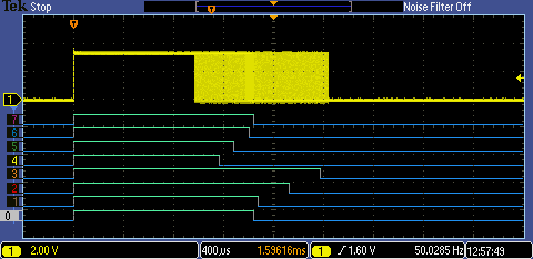

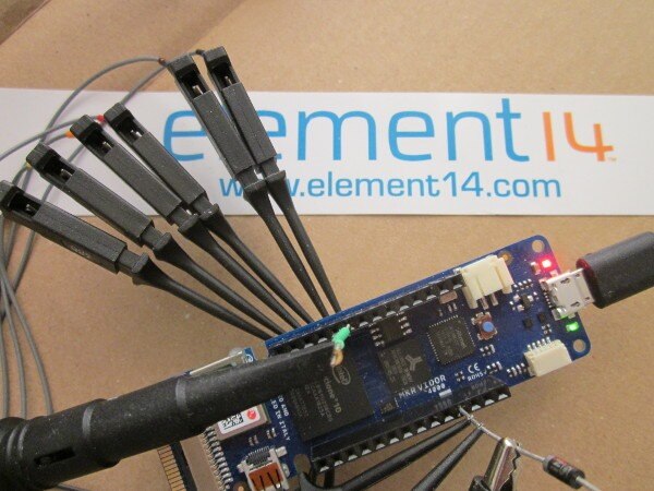

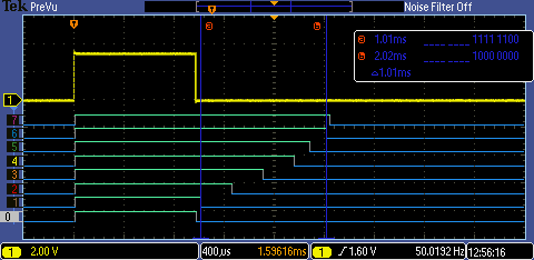

Now a little project: a servo interface. This will give me a chance to experiment with some very simple communication between the microcontroller and the FPGA on my VIDOR 4000 board.
I'm going to have 8 servo channels, which the FPGA will drive out on the D0 to D7 pins of the header, and the control will be via a simple, write-only SPI interface on the SCK and MOSI pins from the SAM processor [with A0 used as the SS chip select].
I'm sure, if I looked around, I could find an existing design, but I thought it would make for a more interesting blog if I did one for myself, from the ground up.
The Design

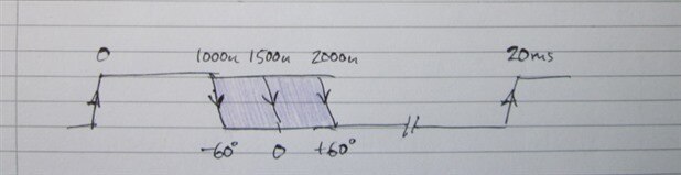

I don't know much at all about model servos, so I had to look at a few datasheets, the Wikipedia page [1], and a couple of websites to find out what the waveform I'm going to generate should be like.

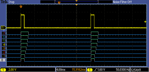

It's a repetitive waveform, where the timing of the falling edge after the positive edge determines the servo angle. Like this:
Traditionally, the repetition rate was 50Hz (20ms period). I'll stick to that for this blog, though it wouldn't be too difficult to change it or even make it programmable.

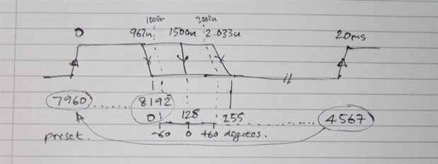

Here's the waveform again as I drew it, annotated with the various counter values in a way that's probably totally confusing, but might begin to make some sense if you read the explanation below.
The neutral position (for the hobby servos I'm using, that will be the centre position, which I'll call 0 degrees) occurs when the falling edge is 1500us after the rising edge.
I had to make a decision as to the resolution I was going to work to. Since the total travel is 120 degrees, working with 8-bit data looked reasonable as a start. That gives half a degree per bit, which I believe is about the size of the deadband with cheap servos. Being a flexible design in an FPGA, I could always increase the resolution later if I didn't like the result.
Since -60 degrees is at 1000us and +60 degrees is at 2000u, we can quickly work out that this is 8.3333us per degree. For half degree resolution, I need half that, ie 4.1666us. I can obtain that by dividing the 48MHz FPGA clock by 200, so I'm going to have an 8-bit prescaler to generate an enable signal every 200 clocks for the servo stuff to run on.

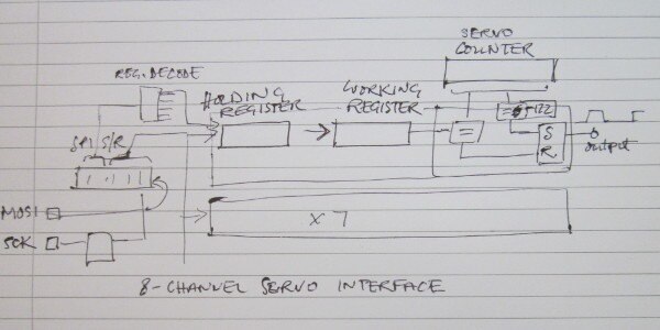

So how about the other end? The processor interface.

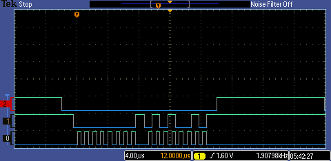

I've already mentioned that it's going to be SPI. That's because it's very simple to implement (it's even simpler with a cut-down, receive-only design like this), and there's also support for it on the SAM side of things, so it's very easy to use in the processor sketch. SPI data is bit-serial, so to receive it we'll need a shift register. In hardware terms, this is little more than a serial-data-in, parallel-data-out shift register.
I have a choice as to how fast I make the SPI clock when I set it up with the Arduino library. Quite arbitrarily, I'm going to set it to 1MHz. [The default on the VIDOR board seems to be 4MHz, as I discovered when I misunderstood that the SPI.beginTransaction function has to come after the SPI.begin, and not before.] That's quite fast enough for what I want to do here, but is slow enough that I won't have any problems at all with dealing with it on the FPGA. Although you might think I'd use something labelled 'clock' as a clock input to the FPGA, I'm not going to. Instead I'm going to treat it as data that I'll sample to find the positive-going edge that marks the time to pick up the data.
SPI is sent as a byte or multiples of a byte. I'm going to choose 2-bytes for each transaction, so my shift register will need to be 16 bits. The first byte will be the address for a channel, the next the data.
After the SPI interface, I need some holding registers to store the data for each channel. As well as the holding registers, I'm also going to have a working register for each channel. The transfer will occur at the start of the cycle, well out of the way of the comparisons that determine the falling edges.
Those stored values then get compared to a counter for generating the output waveforms. Although I could design the output stage and duplicate it eight times, with a counter for each channel, a little thought shows that the counter does exactly the same thing in each case and can be shared between all eight.
Putting all of that together then gives me something like this as a block diagram:

Here are some oscilloscope traces from the working design. This is with the initialisation values from my code.
signed char servoData[] = {-128,-120,-60,0,60,90,120,127};
This first one shows the complete cycle. The logic-analyser section shows the MKR D0 to D7 outputs from the VIDOR headers. The one marked '0' is D0, and so on. The yellow, analogue trace is a duplicate of D0.
We can see the various pulse widths as they should be. This also shows that I've got the output frequency correct at 50Hz (give or take a little variation because of the jitter on the FPGA's clock).
Here it is again, in a bit more detail on a faster timebase:
The cursors I've placed at the 1000us and 2000us positions, which line up with values of -120 and +120 sent from the microcontroller [effectively, -60 and +60 degrees, the limits of my servos].
With this next one, I have the data for each of the channels incrementing 10 times a second. With the phosphor set to infinity, the analogue trace then shows all the possible positions for the falling edge [the analyser section doesn't persist in the same way as the analogue trace, so you only see the most recent trace there].
Finally, here's a quick look at the SPI. Trace '0' is the clock, '1' is the data, and '2' is the SS signal.
