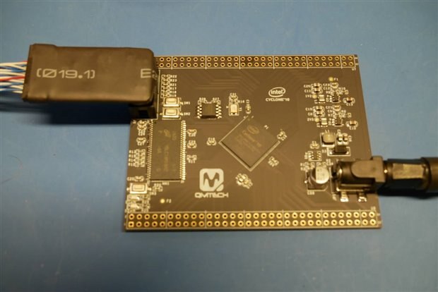

I've been following the discussions about the VIDOR4000 in the FPGA group. There was a giveaway associated with the Webinar but of course there will be sonme disapointed non-winners.
If you want to get into playing with FPGAs one of the cheapest routes I've found so far is to buy a simple dev board from Aliexpress. There are lots avaialble but this blog is about the Cyclone 10
board from QMTech.
https://www.aliexpress.com/item/1000006634063.html?gps-id=pcStoreJustForYou&scm=1007.23125.137358.0&scm_id=1007.23125.13…
I paid about £16 for mine. I already have a "ByteBlaster" programmer but if you don't it will cost about another £10.
The free version of Altera Quartus will do for development.
The Cyclone 10 FPGA on this board is smaller than the one on the Vidor board with only about 6k logic elements - but that's enough for useful work.
The board has a 50MHz clock oscillator, a boot Flash chip and a 32MByte SDRAM and the usual regulators for the supply. It comes with a resaonable set of examples which are
extermely useful in getting it running. I downloaded Version 17.1 of Quartus from Intelto match the version used on the board examples. I've also downloaded the 20.1 version for
my own stuff. Running FPGA designs on different versions of the tools often causes problems - so it's best avoided if you can.
The examples are all in Verilog.

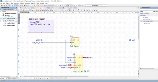

Having got the LED flasher Verilog demo translated to VHDL I've added a chunk of RAM to the design. It doesn't have anything to do right now so to stop the tools  optimising it away
I've connected it to pins. (Which takes me to another big virtue of the QMTech board, it has about 100 IO pins available on its headers.)
This a block diagram of the project. It's done in Aldec-HDL. It's a complete VHDL/Verilog simulator (and more). The block diagram automatically makes all that boring VHDL or Verilog
that links blocks together. The actual code is inside the blocks. I find it helps a great deal to visualise a complex project and saves a lot of time. It isn't free.
This is the RAM code:

All pure VHDL but note that comment on line 21 - my Xilinx example codes the array "63 downto 0" - I don't have a Xilinx toolset runing so I can't test if they care, but the Altera tools
only infer the block memory one way round.
(There seem to be some extra brackets in lines 31 and 33  - but they do no harm)

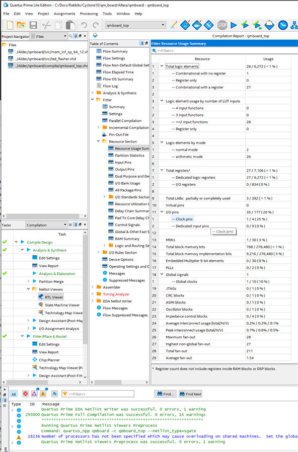

The screenshot shows the loveliness of the Altera toolset and the resources used
So there you go -  a really cheap (and by FPGA standards, a quite simple) way into FPGA.
