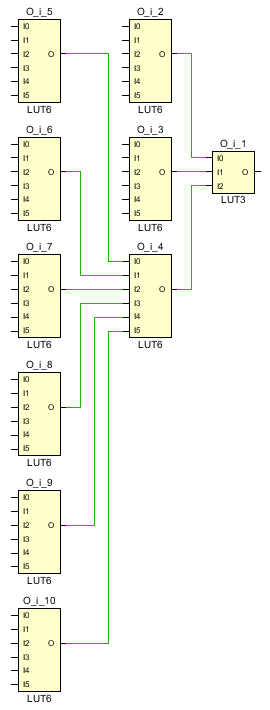

I have registered both the inputs and the outputs so that we can estimate the speed as well as the size of the implementation but we are only interested in the combinatorial portion of the design, which looks like this:

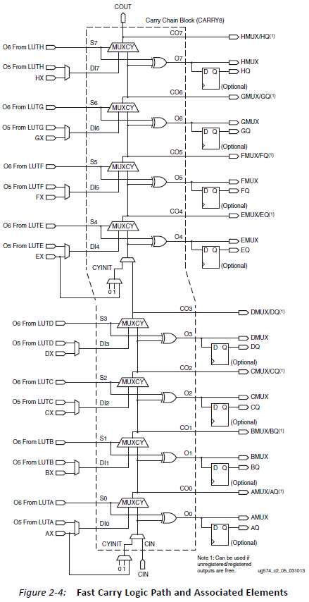

The design uses 10 LUTs and the critical timing path is 3 logic levels. It looks like there is no better solution using less resources than that. However, each Xilinx Slice contains an 8-bit dedicated carry chain logic, which is normally used to implement counters, adders, accumulators and so on. The primitive is called CARRY8 and the functionality can be seen in figure 2-4 of the UltraScale Architecture CLB User Guide UG574:

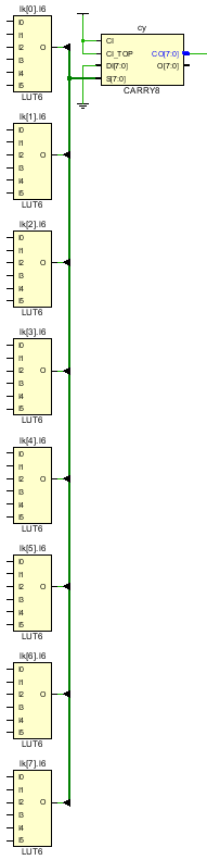

It is possible to use this essentially free resource for other logic functions, for example as an 8-input AND or OR gate, implemented with the MUXCY portion of the CARRY8. The design version below uses only 8 LUT6es and one CARRY8 to implement the 48-input AND:

The synthesis result is 20% smaller and as fast as the behavioral implementation so we have a better design solution:
Since the CARRY8s can be cascaded this idea can be extended to implement AND or OR gates with virtually any number of inputs.
