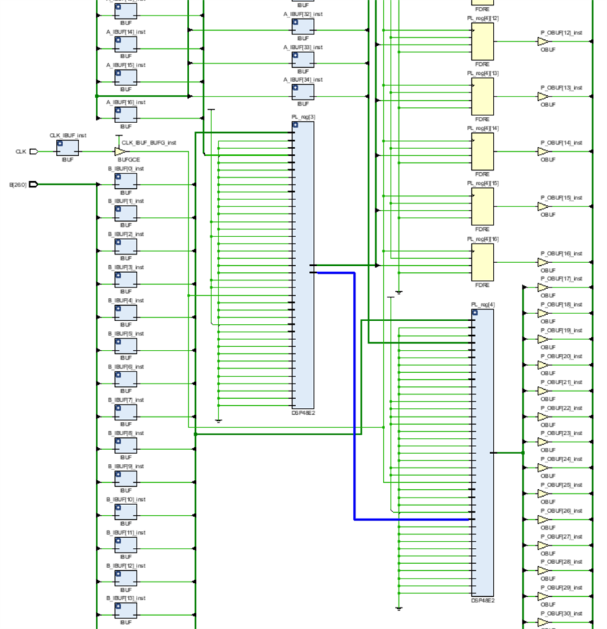

The implementation result is very good, two DSP48 and 17 FFs, which are needed because the lower 17 LSBs of the result arrive one clock earlier from the first DSP48 and need to be delayed by one clock in the fabric, but otherwise no other fabric resources are needed. The highlighted bus between the two DSP48s connects the PCOUT output port of the first to the PCIN input port of the second and this is where the partial sum is also right shifted by 17 bits:
