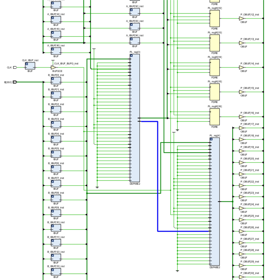

The implementation result is very good, two DSP48 and 17 FFs, which are needed because the lower 17 LSBs of the result arrive one clock earlier from the first DSP48 and need to be delayed by one clock in the fabric, but otherwise no other fabric resources are needed. The highlighted bus between the two DSP48s connects the PCOUT output port of the first to the PCIN input port of the second and this is where the partial sum is also right shifted by 17 bits:

    Jan Cumps over 5 years ago
    fpgaguru I'm trying to replicate the exercise. Vivado is complaining about 2 lines of code.
    I've used the types_pkg from The Art of FPGA Design - Post 8 . With the functions of blog 6 added. I put all in a GIST.
    I'm using Vivado 2020.2, that supports the VHDL2008 syntax by default.
    The two errors I get:
      signal PL:SFIXED_VECTOR(2 to LATENCY)(P'range):=(others=>TO_SFIXED(0.0,P));
    Illegal subtype for subtype indication
    Cannot read from 'out' object 'p', use 'buffer' or 'inout'
    'p' with mode 'out' cannot be read
          PL(2)<=RESIZE(RA*RB,P);
    found '0' definitions for operator "*". cannot determine exact overloaded matching definition for "*"
    I am not following your blogs in order, so I may have missed something between post 6 and this one.
    I'm checking if there's anything related to these errors ...
    If you have a pointer, that would be great.

    Hi Jan,
    Please make sure you set the source file types to VHDL-2008. By default Vivado uses file type VHDL, which is VHDL-93. Reading an out port is a syntax error in VHDL-93 but it is legal in VHDL-2008.
    Catalin
    Jan Cumps over 5 years ago in reply to fpgaguru
    Catalin, I looked at that. In older versions of Vivado there's an option to set 2008 when selecting VHDL.
    In the 2020 version that option is gone. I read on the Xilinx forum that it's always 2008 in recent Vivado versions.
    I'm going to double-check...
  • fpgaguru
    fpgaguru over 5 years ago in reply to Jan Cumps
    I am pretty sure nothing has changed in recent versions of Vivado. The option to set the file type is still there and the default is still VHDL. In the Vivado GUI, when you select an HDL file source used in the project, in the properties pane you can set its type to VHDL, VHDL-2008, Verilog, SystemVerilog, etc.
    Found it image
    Do you happen to have the code for the function "*"(X,Y:SFIXED) ? That's the last manco I have to replicate the exercise.
    Found it image
    Jan Cumps over 5 years ago in reply to Jan Cumps
    I was able to build it.
    For Vivado users: you can't add VHDL 2008 to the block design. I created a wrapper around it in a VHDL 93  source, and that can be added.
    Discuss if I did it wrong ...
