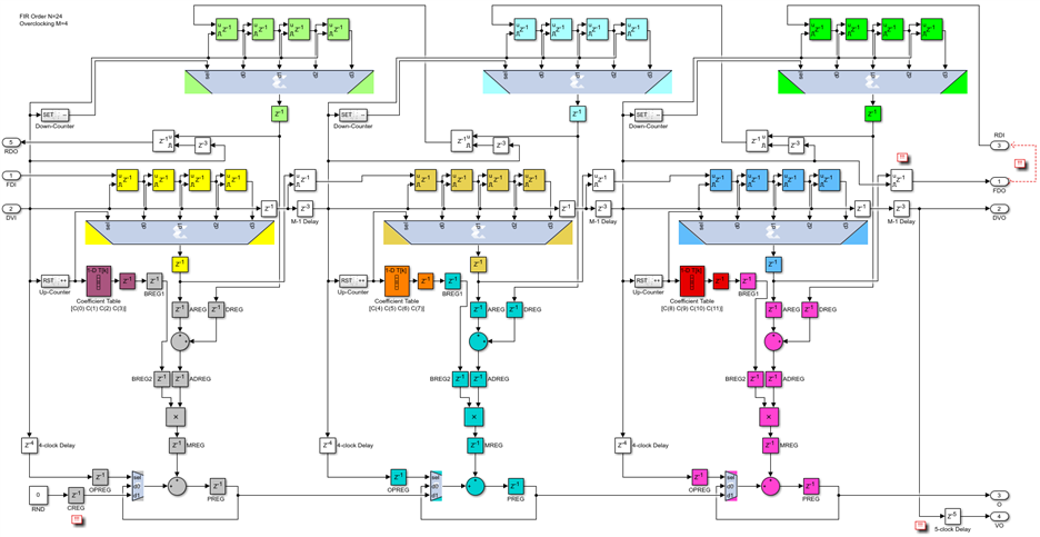

Let's start with the even-symmetric case, when N=2*K and the overclocking factor M is larger than 3. I will use M=4 as an example but this design can be used as is for any M that is 4 or larger, all you have to do is increase the length of the addressable shift registers and adjust the M-1 clock delays in the data valid path:
The key differences compared to the non-symmetric version are the use of the DSP48 pre-adders, including the D input port and the DREG and ADREG pipeline registers. We arrive at this structure by using four rather than just three longitudinal pipeline cuts. There is also a second chain of SRL16 addressable shift registers, with data moving in the opposite direction from one DSP48 to the next. These reverse data shift registers are addressed by a down-counter, which runs in sync with the up-counter addressing the forward data shift registers and the coefficient ROM tables, except that this counter counts from M-1 down to 0, rather than from 0 to M-1. The other points of interest in the design are marked with a red triple exclamation mark block. They point for example to why the first DSP48 is different from all the others - it uses the registered C input port rather than the dedicated PCOUT to PCIN cascade. The other differences are in the last DSP48 in the chain. First, the register capturing the output of the forward shift register for the next DSP48 in the chain has a slightly different clock enable, which arrives one clock earlier. The output of this register is then fed back into the reverse shift register chain. Finally, a 5-clock delay register compensates for the effect of the pipeline cuts and generates a data valid output signal which is in phase with the filter output samples.

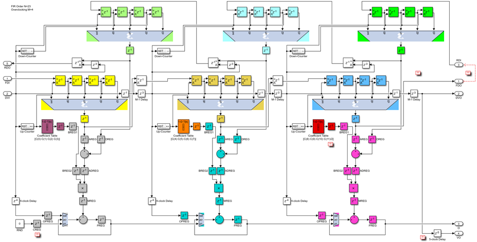

The odd-symmetric case is a slight modification of the even-symmetric design:
The modifications required to turn the even filter into an odd one are all in the last DSP48 in the chain. There is no data capture register anymore, the output of the forward shift register drives the input of the reverse shift register directly. This has the effect of the same data sample being multiplied with the last coefficient C(11) twice, so this is compensated by dividing this coefficient by a factor of 2 in the coefficient ROM table.

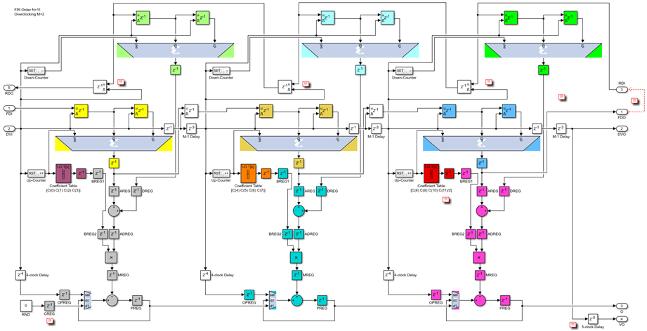

Similarly, the odd-symmetric M=3 case differs from the earlier M=4 odd version by the same minor change:

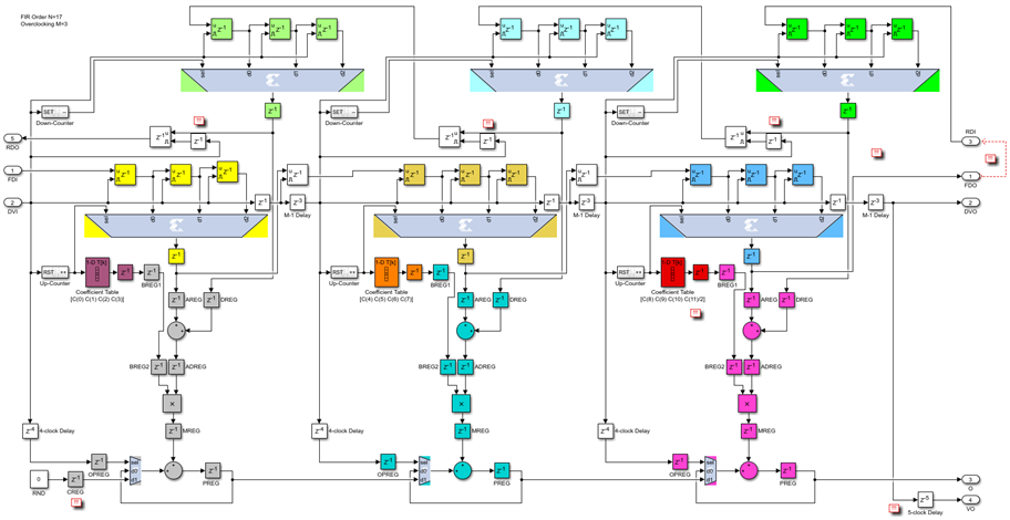

Finally, the even symmetric M=2 case has the same clock enables delayed now by 0 clocks and the data capture registers are connected to the inputs rather than the outputs of the reverse shift registers:

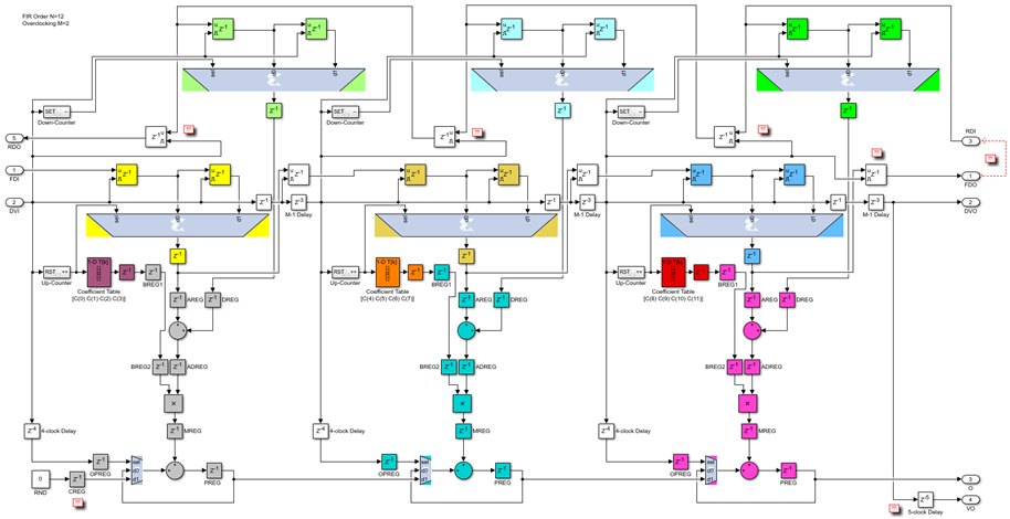

The last case, the odd-symmetric M=2 case, combines both changes made for the even-symmetric M=2 version, as well as the last DSP48 changes needed to convert the even-symmetric filter into an odd-symmetric one:
