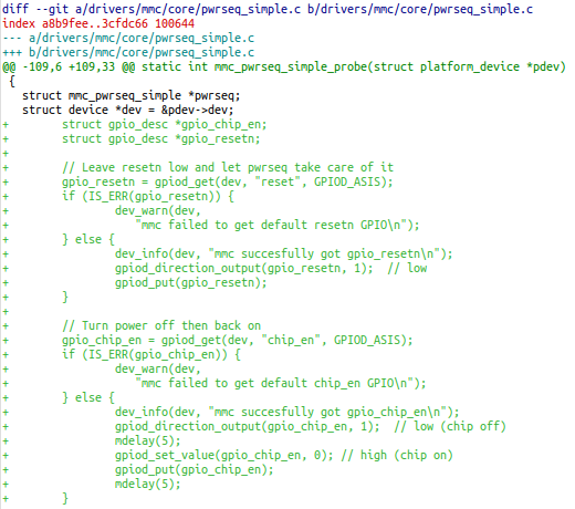

In addition to the kmalloc issue with the device driver, we also needed to patch a Linux kernel source to correctly toggle the module's reset pin at boot time.  This is a requirement for the ATWILC3000 module to be initialized in a known-good state.  The device driver originally performed this function, but it did not work correctly so we disabled it in the device driver and instead moved this task to the drivers/mmc/core/pwrseq_simple.c kernel source file.  This patch is supplied as part of a kernel configuration bitbake recipe in the PetaLinux BSP.

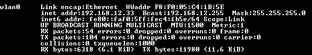

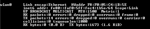

    I noticed on my Ultra96-V2 that with one of my WPA2 secured networks, it appears in the Open Networks section of the drop down list which then does not allow me to enter the passphrase until I click on the Text Field option.
    Seems to connect to my secured AP fine but then I only get an IPv6 address and not an IPv4 address:
    But after I access the network for a while (like clone my favorite Avnet GitHub repos) then an IPv4 address also shows up:
    Any idea why that might be happening?
