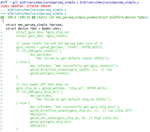

In addition to the kmalloc issue with the device driver, we also needed to patch a Linux kernel source to correctly toggle the module's reset pin at boot time.  This is a requirement for the ATWILC3000 module to be initialized in a known-good state.  The device driver originally performed this function, but it did not work correctly so we disabled it in the device driver and instead moved this task to the drivers/mmc/core/pwrseq_simple.c kernel source file.  This patch is supplied as part of a kernel configuration bitbake recipe in the PetaLinux BSP.

In additional to having a working Linux device driver, it is also critical to make sure the device tree settings are correct. If the device tree description for the WiFi module is incorrect, Linux won't know how to make the connection between the hardware device and the device driver in the system.  For the ATWILC3000 there are two parts to the device tree description - one for the toggling of the module's reset pin and another to describe the SDIO interface and "connect" it to the WiFi module.
Description of connections for toggling the reset pin:
   sdio_pwrseq: sdio_pwrseq {  /* This needs to be able to manipulate the chip_en and the resetn properly */
      compatible = "mmc-pwrseq-simple";
      reset-gpios = <&gpio 7 1>; // MIO[7] for WILC3000 RESETN, Active low
      chip_en-gpios = <&gpio 8 1>;
