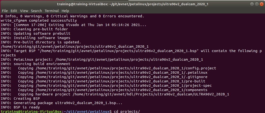

As a follow up to the blog I posted on building the hardware design for the out of box image for the ON Semiconductor Dual Camera Mezzanine card, here are the instructions to complete the build with the Petalinux project. The original blog can be found here -
Ultra96-V2 ON Semiconductor Dual Camera Mezzanine hardware build instructions
The process of porting the full design over to our Github repo has now been completed. Below I've pasted the instructions to build the full design including Petalinux from the repo. The final command will build the hardware design as part of the script and create the full design.
# Clone the repositories
$ cd ~
$ mkdir -p git/avnet
$ cd git/avnet/
$ git clone https://github.com/Avnet/bdf.git
$ git clone https://github.com/Avnet/hdl.git
$ git clone https://github.com/Avnet/petalinux.git
$ cd bdf
$ git checkout master
$ cd ../petalinux
$ git checkout 2020.1
$ cd ../hdl
# Run the Vivado build script for the Ultra96-V2 dualcam design
$ cd ../petalinux
$ ./scripts/make_ultra96v2_dualcam.sh
This process will take a long time and will depend on your pc hardware. When complete, you should see something similar to this:
