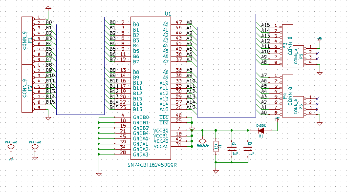

I am creating an interface board for CNC equipment, the board will accept legacy parallel/TTL level inputs, however due to the need to support various devices I'll be using a CPLD or FPGA chip to allow custom configuration of each groups of boards.
I'm a little stuck as the 25 pin parallel port supports 17 signal pins and 1 ground pin, so looking for a recommendation for a low cost non-inverting buffer that can support that number of signal pins. The soul purpose of the buffer is to protect the 3.3v CMOS circuit from the potentially higher TTL voltages.
Xilinx recommend the MC74VHC1GT50 which is a small device, so looking for something of similar spec that can support the 17 signal pins. Would anyone have a recommendation for a device?

    I have a solution for 16 pins image
    The Gadget Factory 16 bit I/O buffer wing is open source. I've successfully used that design to make a Xilinx Spartan6 accept TTL level signals.
    https://github.com/GadgetFactory/Papilio-Wings/tree/master/BPW5015-Buffer-Wing

    0 e14 Contributor over 11 years ago in reply to Jan Cumps
    Thankyou Jan, the price is right on that chip. I can use that layout plus the single pin MC74VHC1GT50 and I have all bases covered.
    0 Jan Cumps over 11 years ago in reply to e14 Contributor
    Cool. Just a warning: it's critical that you use that particular TI SN74xxx part. The level translation function is documented in the datasheet and works.
    I first used another chip that was listed as an equivalent of the TI one and that didn't do the level translation.
