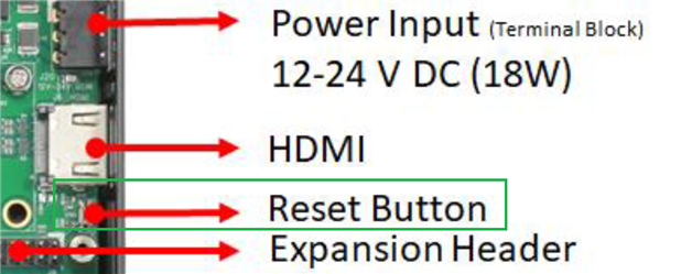

buttonservice
The SmartEdge has a custom reset button. It can be engaged by inserting a small pin into the opening next to the power input.
Here's the service registry content:

Depending on how long you press the button, it calls different functions.
Short push: it calls
opt/avnet-iot/iotservices/switch_reset
content:
/opt/avnet-iot/iotservices/reboot
The reboot script itself is subject to a later post.
Middle long push: reset settings:
/opt/avnet-iot/iotservices/switch_configuration_mode
There are a number of actions in this script that you may or may not want.
If you use the AVNET IoTConnect functions, you want everything.
If not, you may want to uncomment some service start and enablement calls, e.g.: restservice, ledservice, iotconnectservice.
These cervices will be reviewed in a future post.

When you push the button very long (more than 15 seconds), the box does a factory reset.
/opt/avnet-iot/iotservices/switch_factory_reset
content:
## Perform factory reset
# cleanup removed
cp /opt/avnet-iot/iotservices/files/dhcpcd.conf.* /etc/.
cp /opt/avnet-iot/iotservices/files/dnsmasq.conf.* /etc/.
cp /opt/avnet-iot/iotservices/files/default.script /usr/share/udhcpc/.
cp /opt/avnet-iot/iotservices/files/hostapd.ap /etc/default/.
cp /opt/avnet-iot/iotservices/files/hostapd.default /etc/default/.
cp /opt/avnet-iot/iotservices/files/*.service /etc/systemd/system/.
cp /opt/avnet-iot/IoTConnect/sample/IoTConnectSDK.conf.default /opt/avnet-iot/IoTConnect/sample/IoTConnectSDK.conf
cp /etc/default/hostapd.ap /etc/default/hostapd
cp /etc/dhcpcd.conf.ap /etc/dhcpcd.conf
cp /etc/dnsmasq.conf.ap /etc/dnsmasq.conf
systemctl daemon-reload
systemctl disable iotconnectservice
#Don't stop iotconnectservice; this script may be running under it.
#systemctl stop iotconnectservice
systemctl enable restservice
systemctl disable hostapd.service
systemctl disable dnsmasq.service
rm /etc/systemd/system/attinyupdate.service
ln -s /opt/avnet-iot/services/attinyupdate.service /etc/systemd/system/attinyupdate.service
rm /etc/systemd/system/bootservice.service
ln -s /opt/avnet-iot/services/bootservice.service /etc/systemd/system/bootservice.service
systemctl enable attinyupdate.service
systemctl enable bootservice.service
systemctl enable quectel.service
rm /sbin/reboot
ln -s /bin/systemctl /sbin/reboot
history -c
if [ -d /home/avnet ]; then
    echo "Already exists"
else
    deluser avnet
    useradd -m -d /home/avnet -g avnet -G root,crontab,adm,tty,dialout,sudo,ssh,iotedge,tss,gpio,i2c -s /bin/bash avnet
    cat /opt/avnet-iot/iotservices/default.txt | chpasswd
fi
systemctl disable wpa_supplicant.service
systemctl stop wpa_supplicant.service
/bin/bash /opt/avnet-iot/iotservices/reboot
Side effects:
loads the attiny_btn library
depending on how long you press, reinitialises WiFi settings, or factory resets most of the custom aspects.
