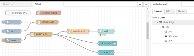

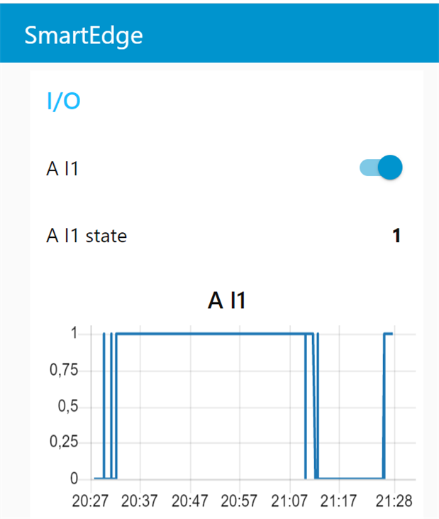

Here, I'm extending that same flow, to show an input pin state on a Node-RED dashboard.
Let's pretend that we have a boiler on/off detector attached to input A I1.
The state is shown on 3 controls:
  • a "button style" indicator
  • a label
  • a history of the last hour
This is easy. I replaced the debug output block of last post with the 3 controls.

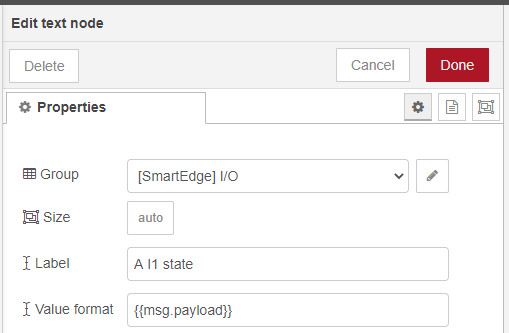

Label
The state reader block, labeled DIGIO A I1,  gives character 1 or 0, dependent on the state of SmrtEdge's DIGIO A input 1.
I just added a text node, connected the reader output to it. And gave it a name.

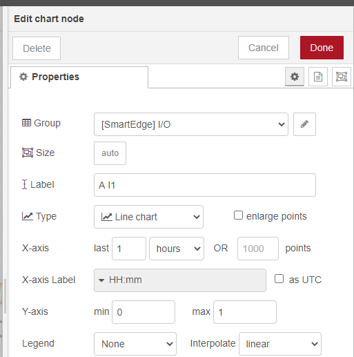

History Graph
This one is also directly connected. I changed some attributes to make it looks good.
I didn't find a way to just show 0 and 1 on the Y axis, without in-between ticks and labels

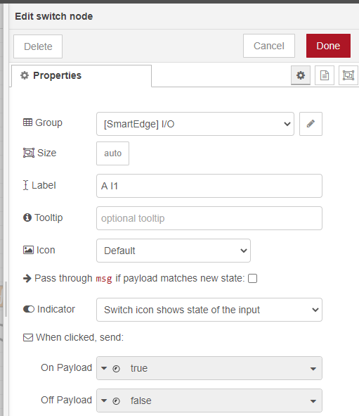

Indicator

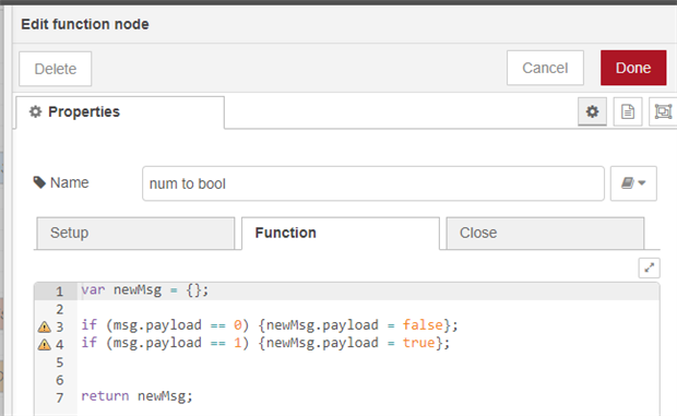

This one expects a boolean input.
I put a conversion function between the reader output and the indicator:
Then, I made the switch read-only and told it to show the input status:

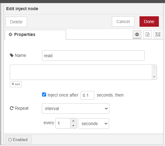

Keeping the View Up-to-date
The last task was to take care that the status is read regularly.
In the previous post, I used an Inhjection block. Every time it's clicked, the input pin's state is read.
I've kept that same block, but scheduled it:
You can choose the interval as you please. If you want a faster refresh than 1 second, you can use decimals.
That's it. These little additions give you a dashboard that you can view from a PC or tablet.

    In the blog, I used the default representation of a button.
    But if you prefer a more sober layout (with additional advantage that it isn't animated when you click on it), you can use simpler icons.
    The image below shows the state when the input is engaged (left) and disengaged.
    Here are the settings:
