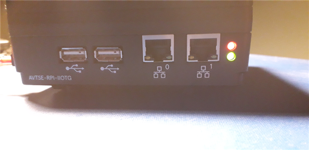

The SmartEdge has 3* custom LEDs.  They are attacked from several angles.
From the reboot, watchdog, IoTConnect and led service.
From the onboard ATTiny , and maybe from some other places that I find during my investigation.
But ledservice itself is the heart to keep the LEDs under control, and initially flags that your new SmartEdge hasn't been WiFi-provisioned yet.
*It looks like there are 2 LEDs, but the lower one is a green and orange LED in a single housing. The top LED is a common red one.
The lower orange LED is not addressable. It's connected to a pin that's set up to report board activity. Check the overlay definition for that.
